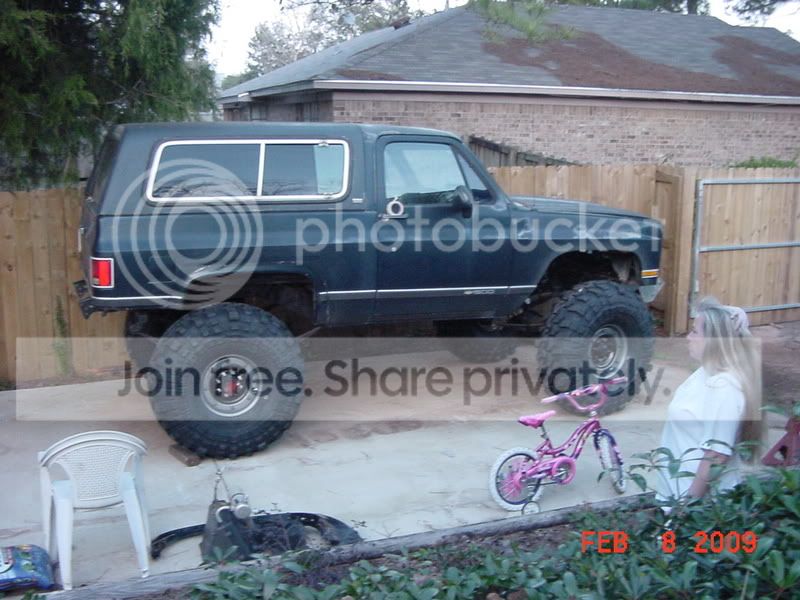

So true! I played this game and lost on my K5. :doah:This pic shows the rear set back 5" with a 43" tire. If you look real close you can see the cut line around the wheel opening on the outer skin, it's still hanging there because I had not cut the inner tub yet. Anyways... I drew the line and cut it without the tire and later found I should not have cut so much on the front side. You can also see the cut line is very close to the gas door.
I moved the axle back to the stock location and it's still there now but I think I may try to split the diff and move it back about 1.5"~2" and see how it looks.

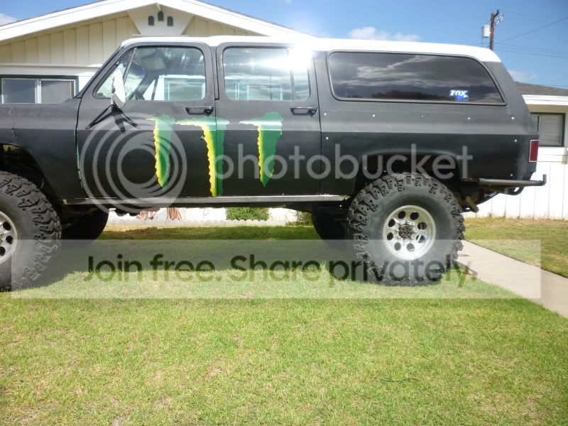

Also seeing Johns blazer above it you can get it to work with everything one word AWESOME!

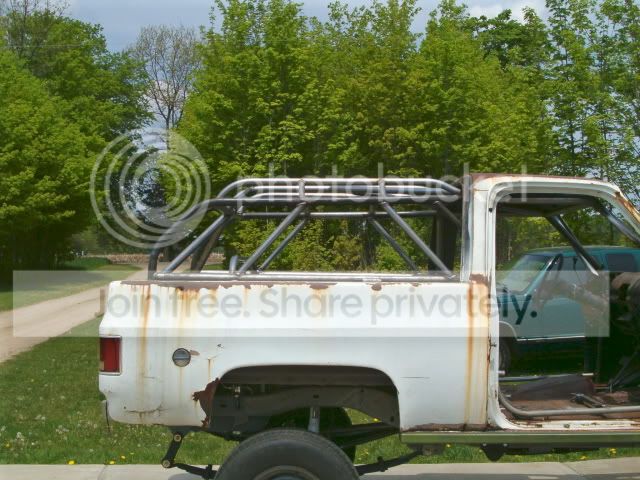

find another blazer or pickup what ever, with the same body. then cut out the rear part of the fender well taking the whole flat part on top of the opening with. stretch the wheel well to were you want it(keeping in mind that the axle moves backwards a little at full stuff) and weld it in matching the old body lines. this way you can keep a factory looking fender lip. but with a much wider opening.
