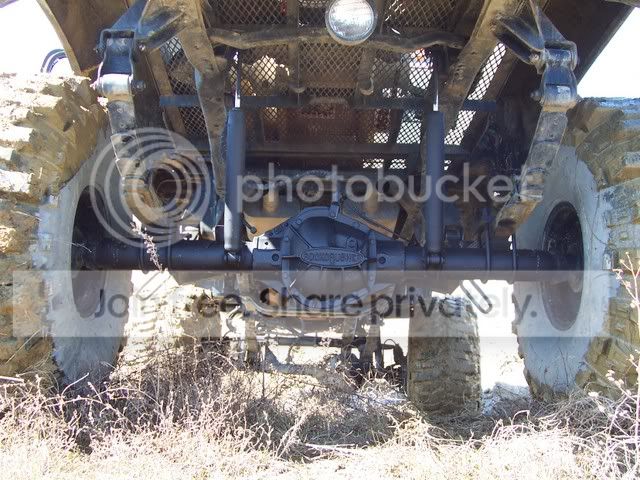

I have seen some pics of the Burb that y'all built and both of the shocks are mounted behind the axle. Any reason for that? Did you modify anything else for that set up to work? How did it work compared to stock?

Are you talking about this setup? They are mounted off the front of the axle.
shocks mounted same direction

The benefit is just ease of mounting longer shocks than what was originally intended. We're talking 12"-15" travel shocks.

I musta missed this tread. Like Jay said, I have mine mounted on the backside of the axle. They are also angled to the back. I have them just inside of the frame rail. They are 15" travel (Probably could have got away with 13s)
No problems with flex. I'm going to be lowering the truck 4" soon, so I'm not sure if I'm going to reuse this shocks or try and find some shorter.
