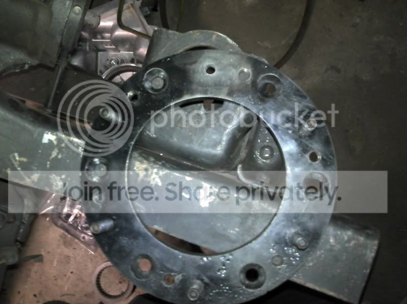

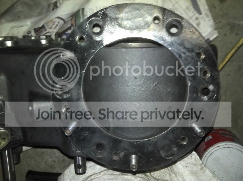

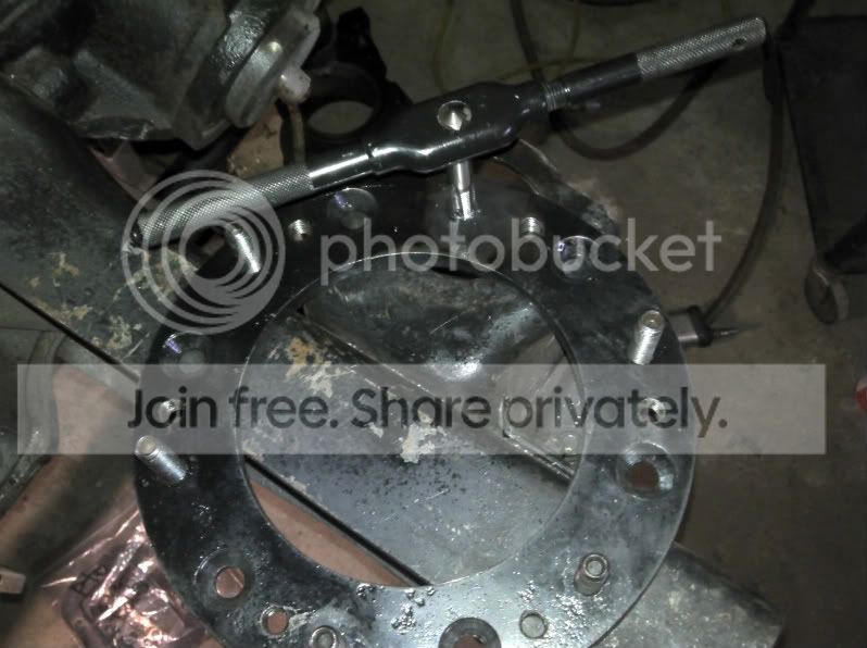

I did it right here.
it was hard as hell to re-drill it. just like Eric said cool it with constant flow of cutting oil.
Mine worked out, but it took a while to drill.
Tapping the hole was even worse. but, it worked as well, just took a while.
