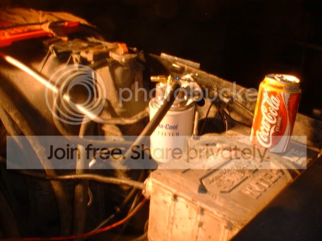

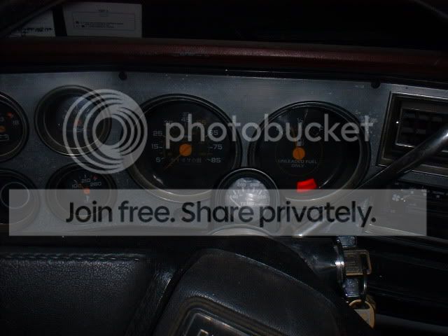

ordered the Perma-cool remote transmission cooler with temp guage. Got it from summit. Was a little pricey but i think it will be well worth it.
The hardest part for me was figuring out the wiring schematic in the instructions. The instructions are great for running the transmission line. But only a picture for wiring the guage. But i got it figured out.
I need some more hose that i got to get in the morning. Then i can wire up the gauge with some well needed sun light.
fyi: first few years of 6.2 deisel have almost the same exact mount with 1/8 port in it. thats what i have for mine. bolted to the fire wall pass side.
plus i am going to install another one for the tbi fuel filter. so i dont have to contend with that crazy filter on the frame rail.
That's some good info, thanks!
