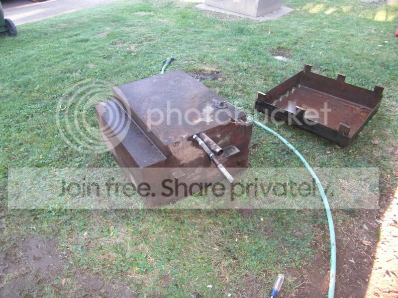

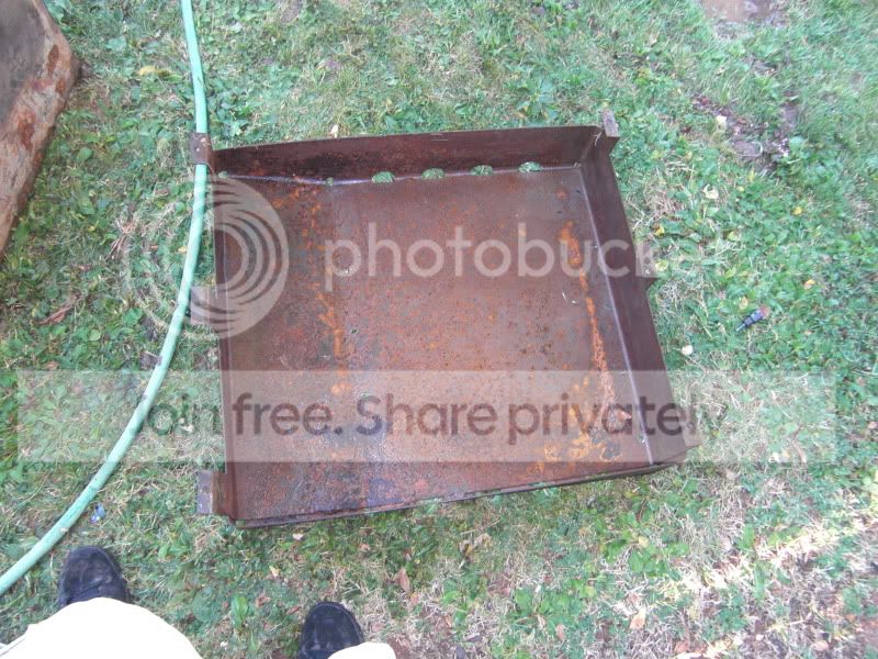

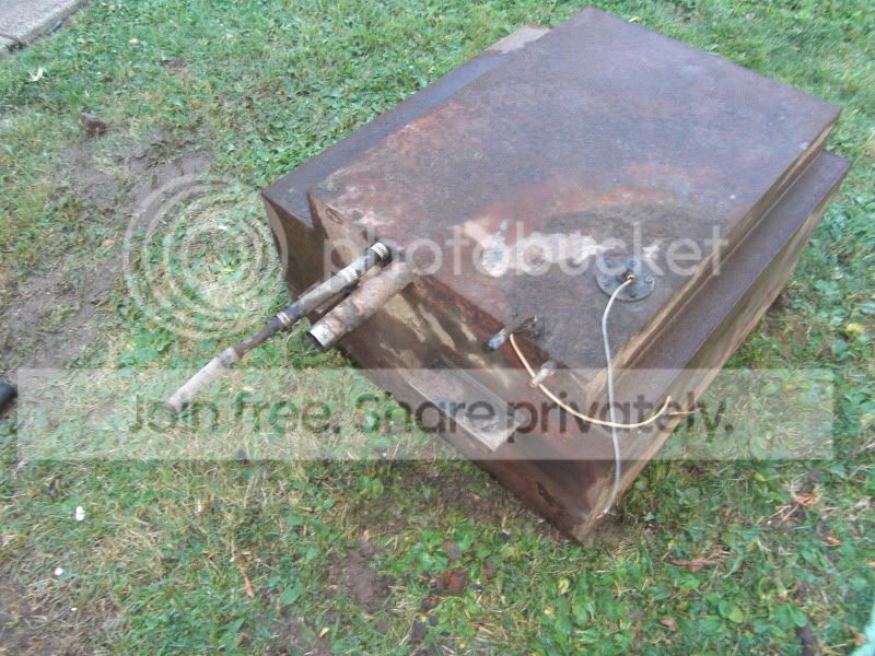

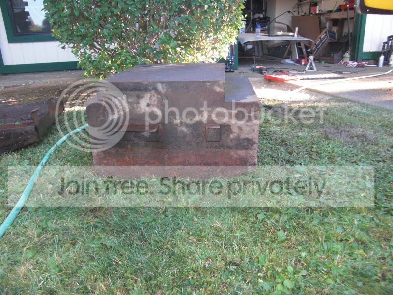

this is the tank i had.
http://www.nwmp.com/index.php?option=com_content&view=article&id=4&Itemid=4
