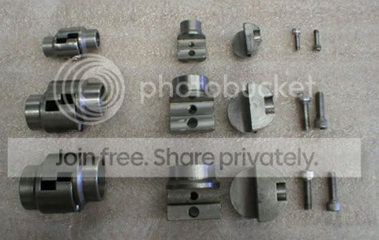

Somewhere within the past week or two browseing through the web, magazine or, a catalog I ran across a tubing coupler for in a roll cage. The coupler appeared to slide into the end of the pipe and weld fast. The coupler was in two pieces and when the two pieces were welded to the two sections of pipe the would then interlock together and a bolt would somehow hold it in place. I can't remember where the heck I saw this thing. Mabye I dreamed it. :D If any of you know what I am talking about and where to find them it would be great. Thanks :burb:

Like these?

Yep stomper shows the ones I was thinking of. They are nice for engine cages and such.
