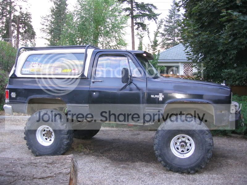

Built one before for a soft top.
It fit on the bedside, under the soft top mount rail. 4"x2" angle length of the bed top with two hoops the followed the window angles, up and over with cross rails on top between them and also ran out over the cab for little extra storage.
Worked like a charm but it wasn't a roll bar as the guy I sold it to found out. :doah:
REAL simple. I'll see if have a picture of it somewhere. And it fit under the hardtop as well.
edit:
had a look but must be on another drive. Did find this picture on here and looked kinda like this.
