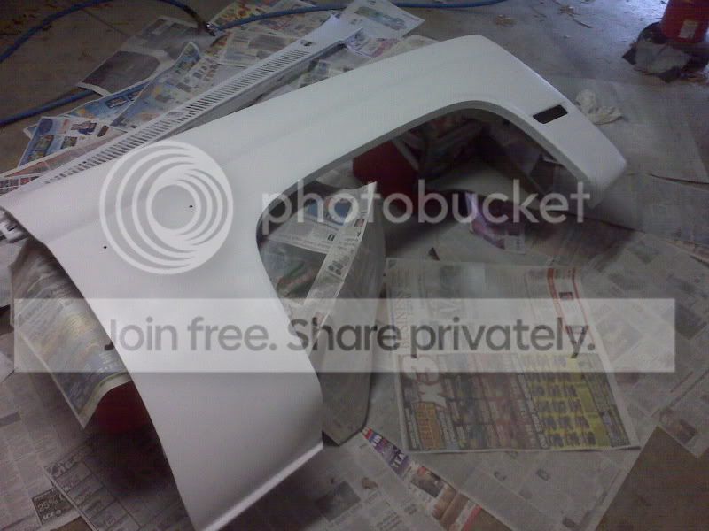

Update from my weekend of "work"...Took the fender off and did some bondo work, sanded it down good, primed and painted. Here is a pic after about 3-4 light coats of paint. I decided to go with rattle can rustoleum gloss white, then I'll put a clear coat enamel on it. It actually is turning out better than I expected!
No clear coat on it yet...That is just after a few light coats of paint.

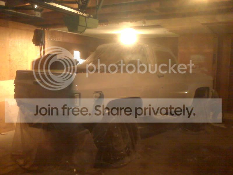

Just wanted to update this thread real quick. Ended up borrowing a spray gun from a buddy of mines dad who does paint and body work (Ditched the rattle can). After a weekend of sanding and prep work we finally put the first coat of primer on tonight.
Its rustoleum white primer, works pretty well. Will be hitting it with a little sanding tomorrow evening and then another light coat of primer. Anyway, here is a pic, sorry- blackberry quality. I'll keep updating as I go.
Looks good so far. This makes me want to speed up the process and paint my truck LOL

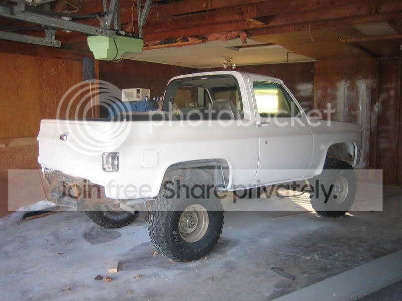

Two coats of primer and five topcoats later I finally removed all the tape and masking today and I'm real happy with how it all turned out, although I'm not 100% done quite yet. I'm going to let the paint harden for a few days, hit it with 1500 grit and then use polishing compound and buff away! Anyway, here is a pic from today.
