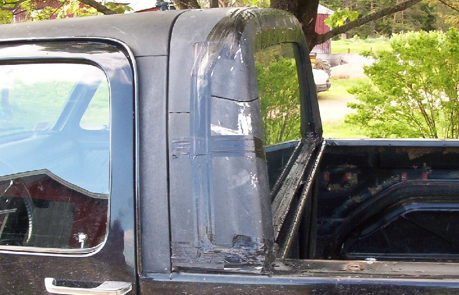

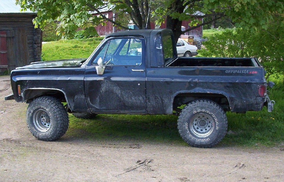

I made one like this:
Stock rear cab, just cut off everything between the front and rear, used stock rear glass.
Unfortunately, never finished it properly:
I used fiberglass to keep two halfs together, and duct taped the seam because I was in a hurry. And it was like that half a year, then the end came for that K5 on that form :wink1:

Yeah, I was thinking sheetmetal and pick-up cab too, but more thought I gave to it, I figured it would be easiest to do from stock cab. Took about a day to cut and fit it.
