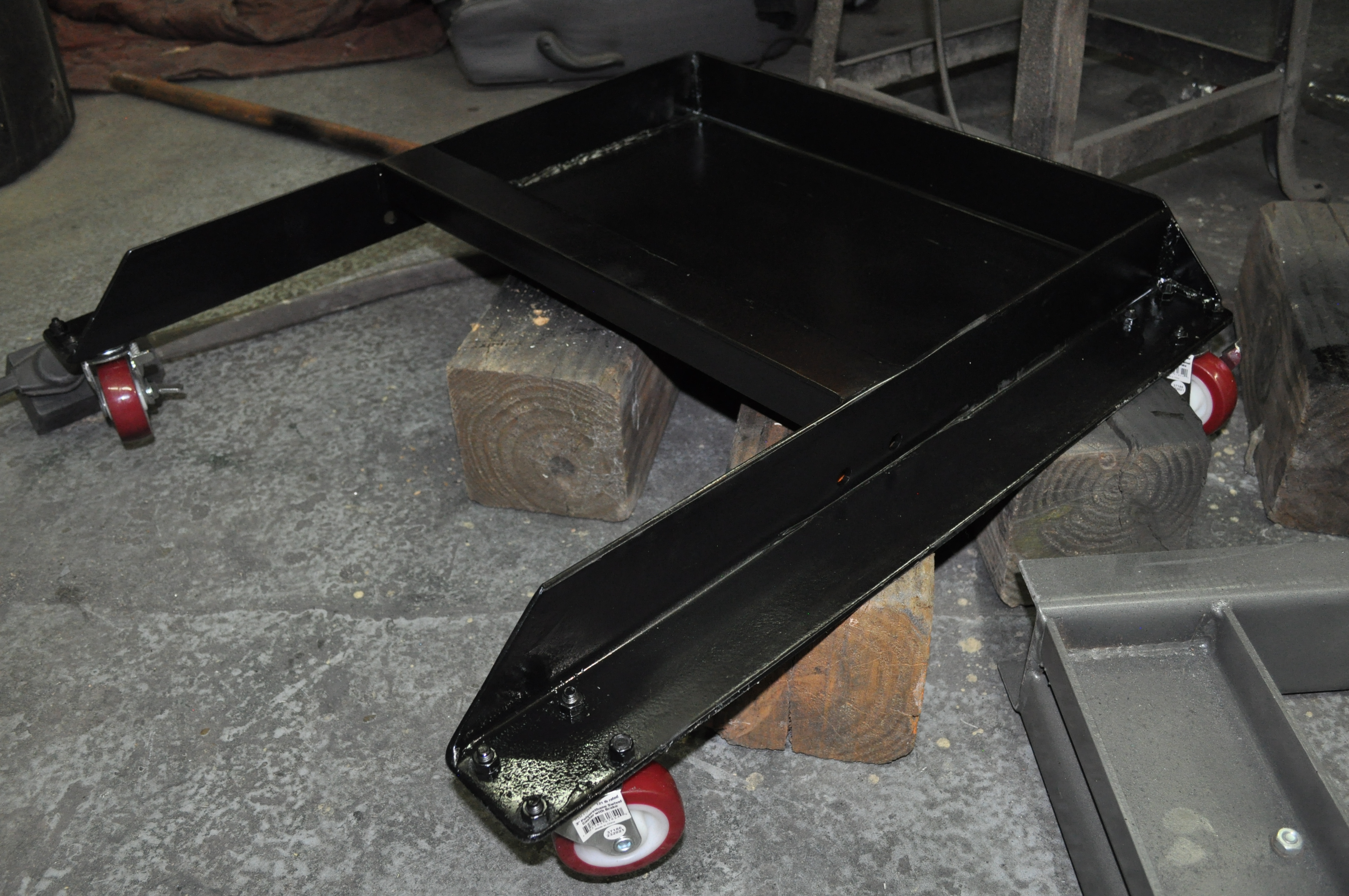

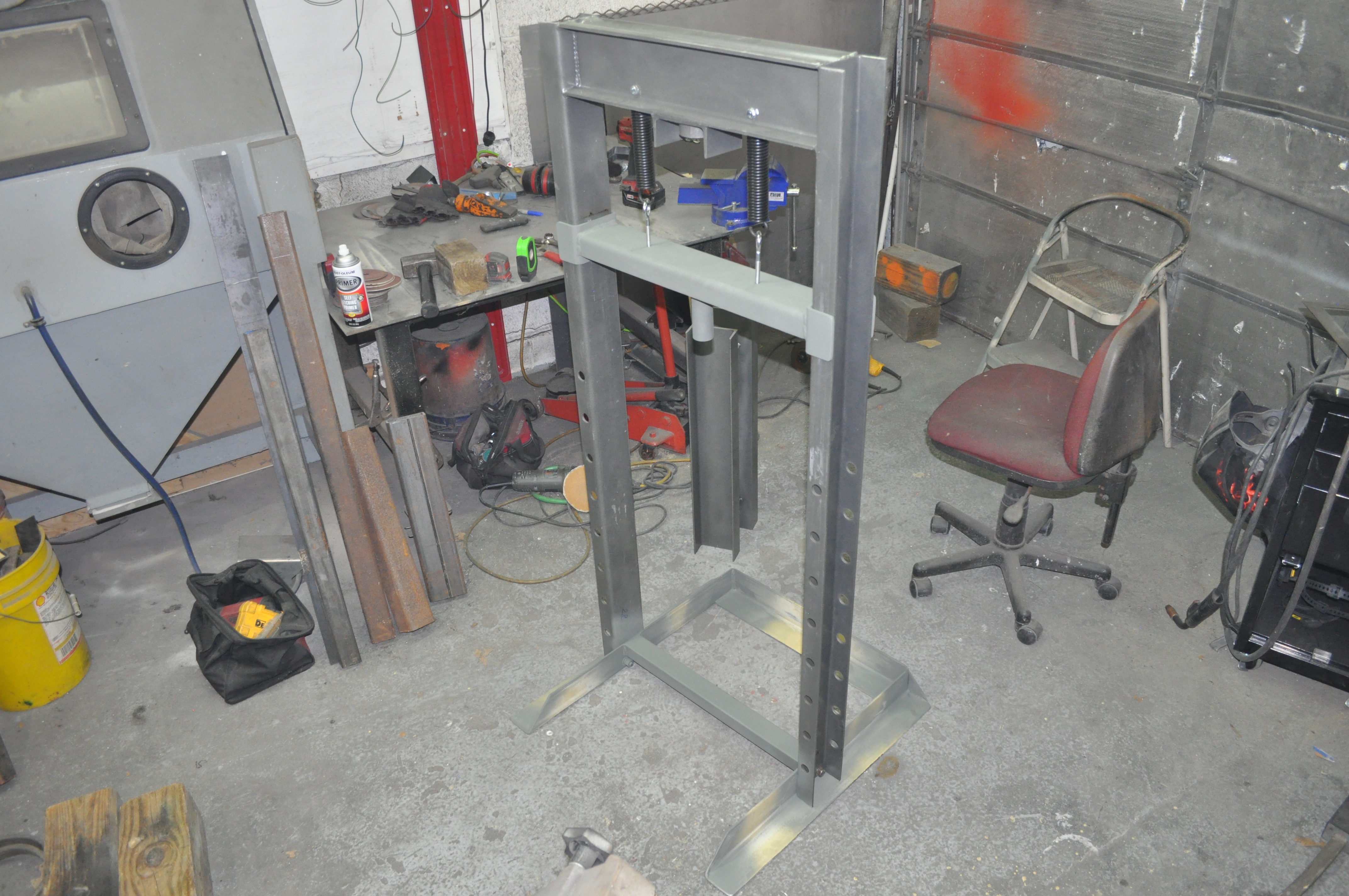

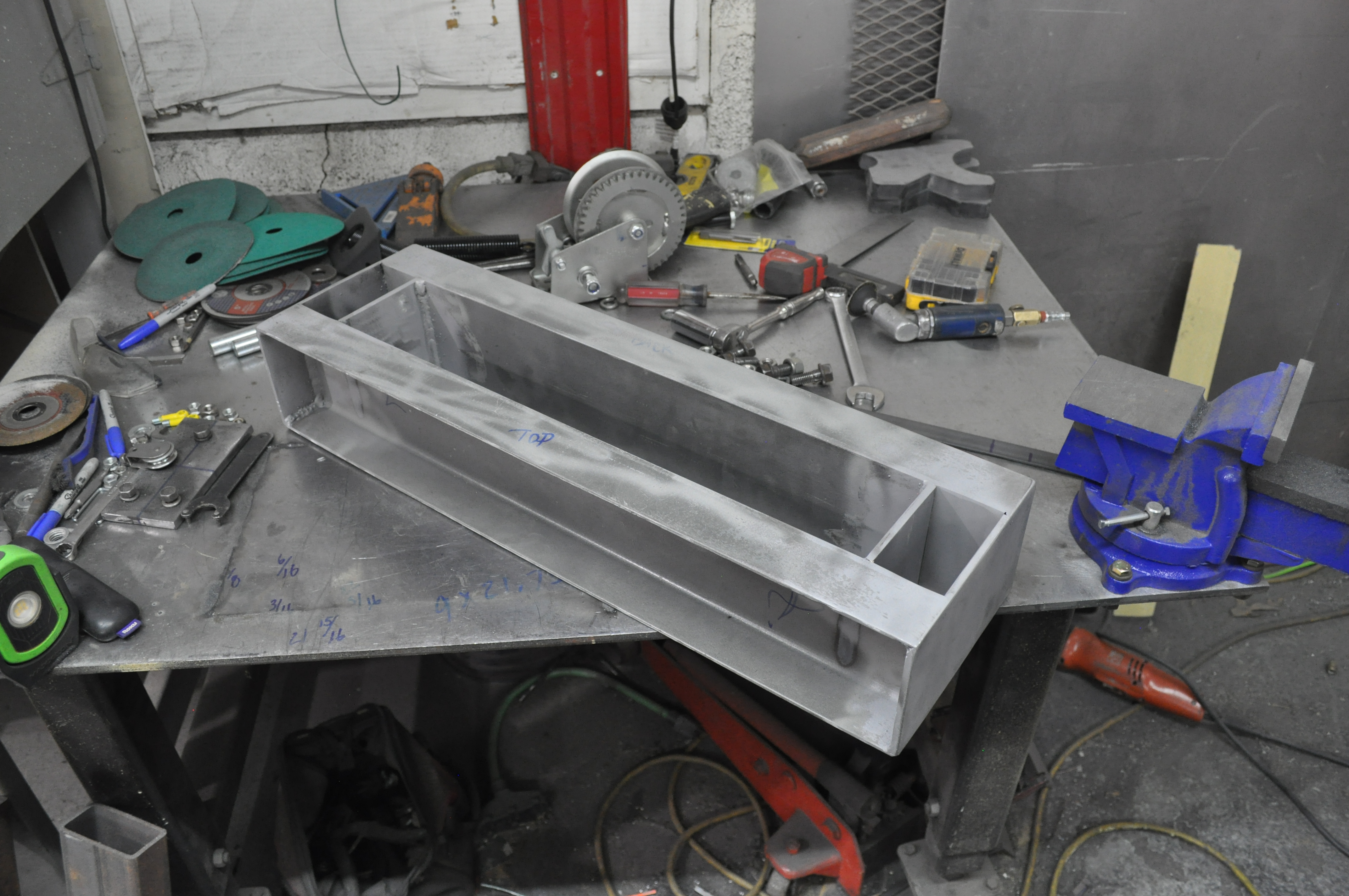

here's how the base turned out for now.. hopefully the casters get here monday... I added the back wall for the box..
full
still working out the details for that box... wish I had a piece of diamond plate for a top door/cover...
next is to do the lower cradle...

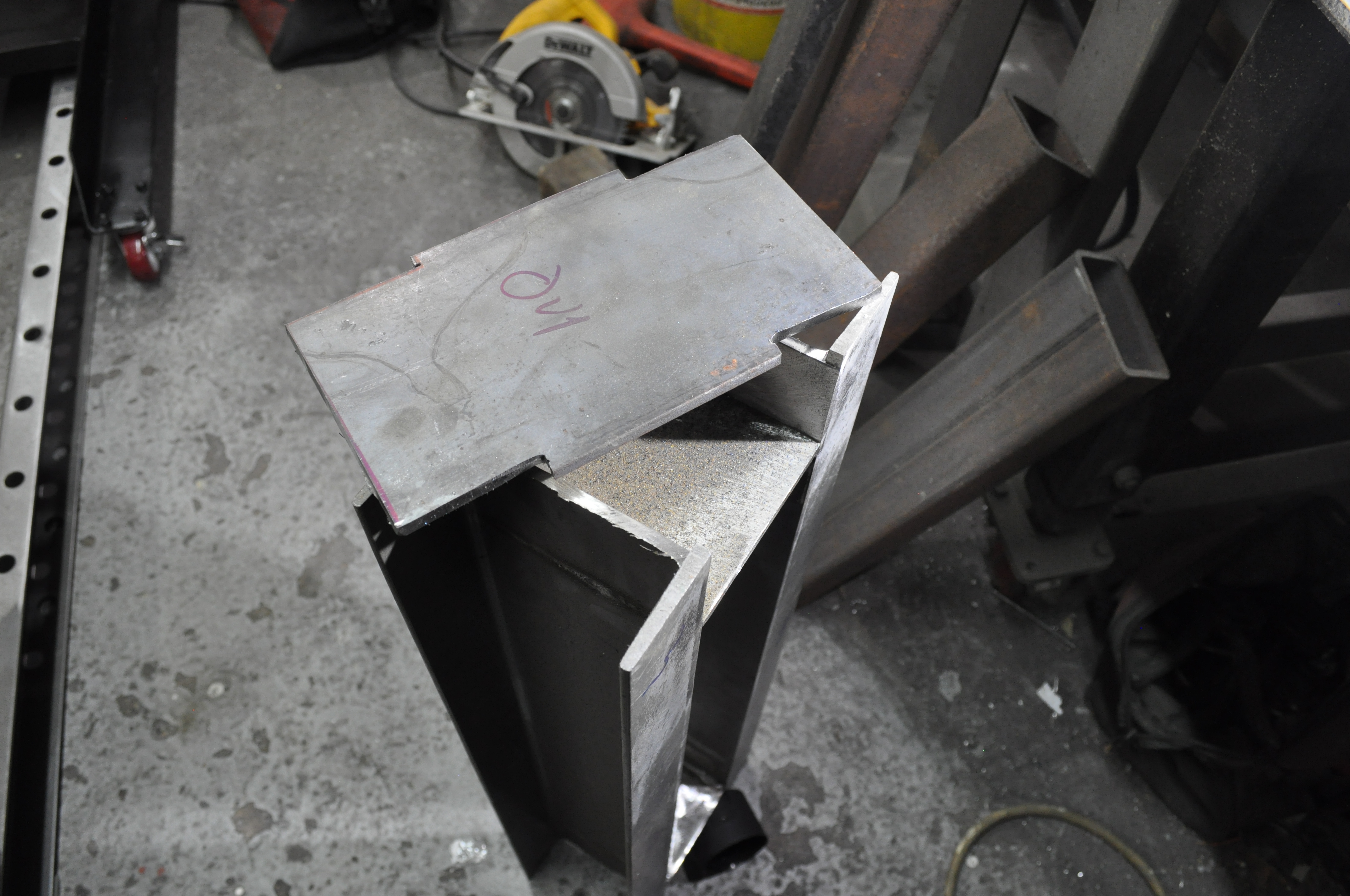

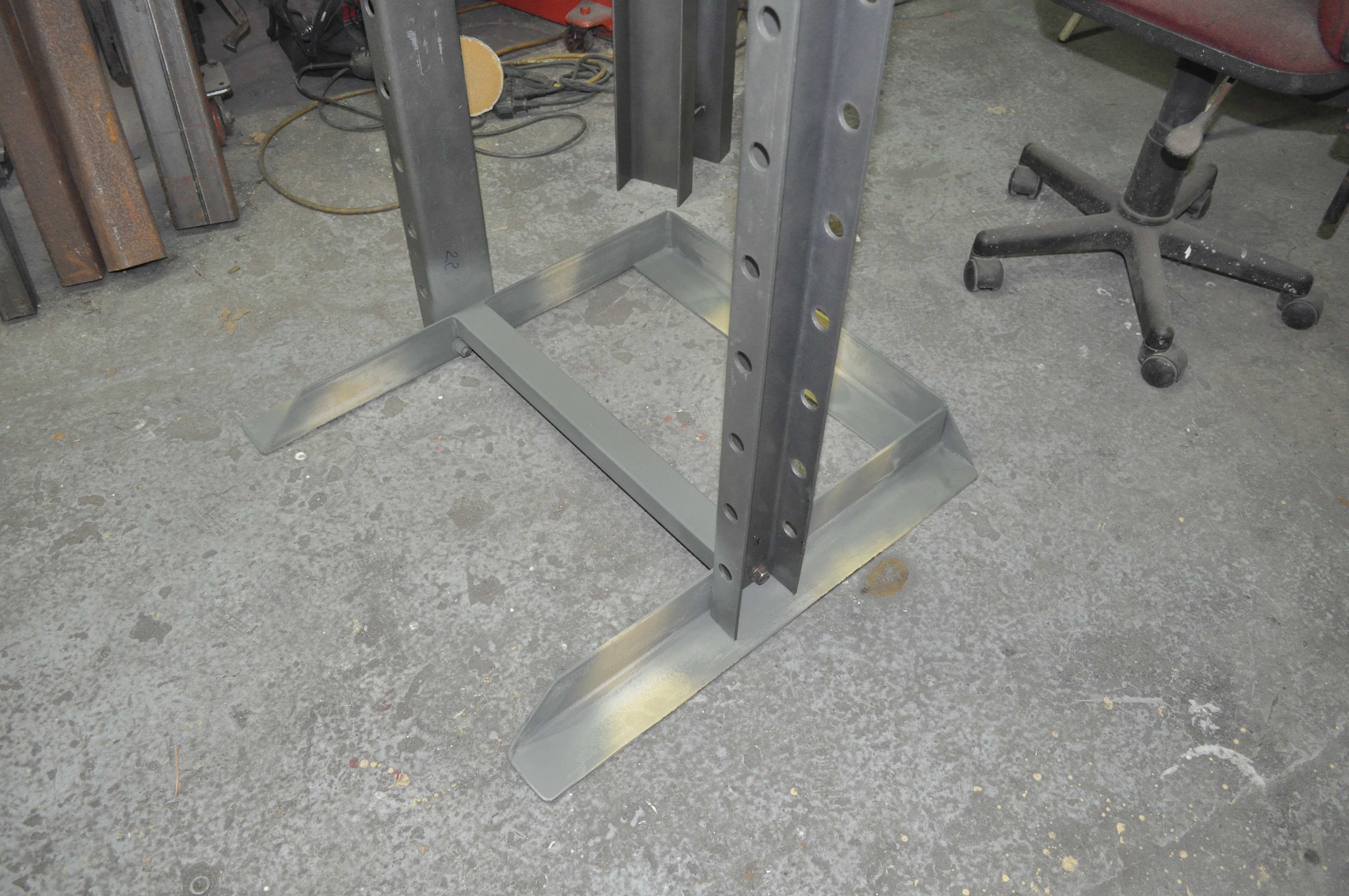

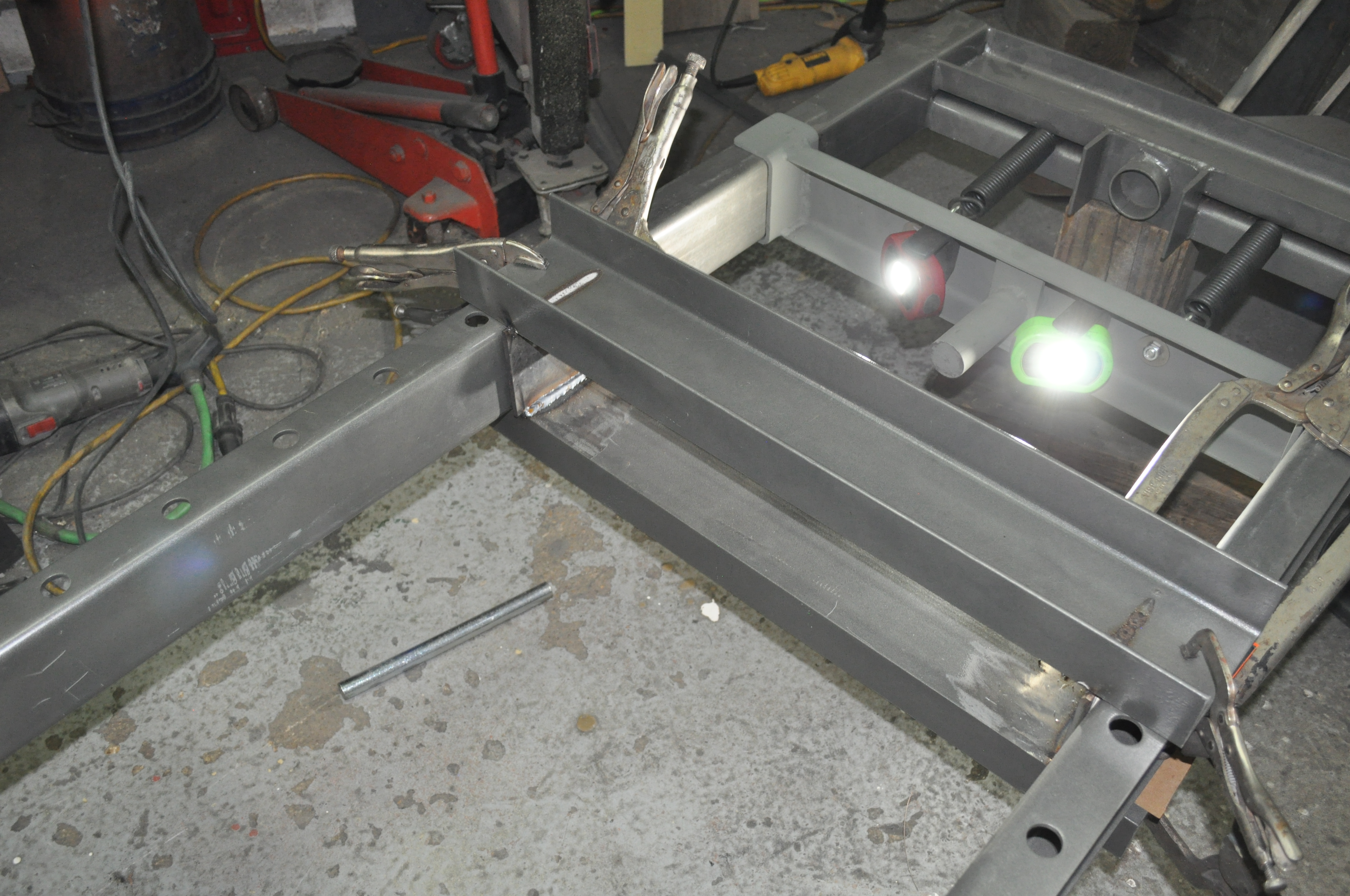

got the cradle chopped up and ready for modding tomorrow...

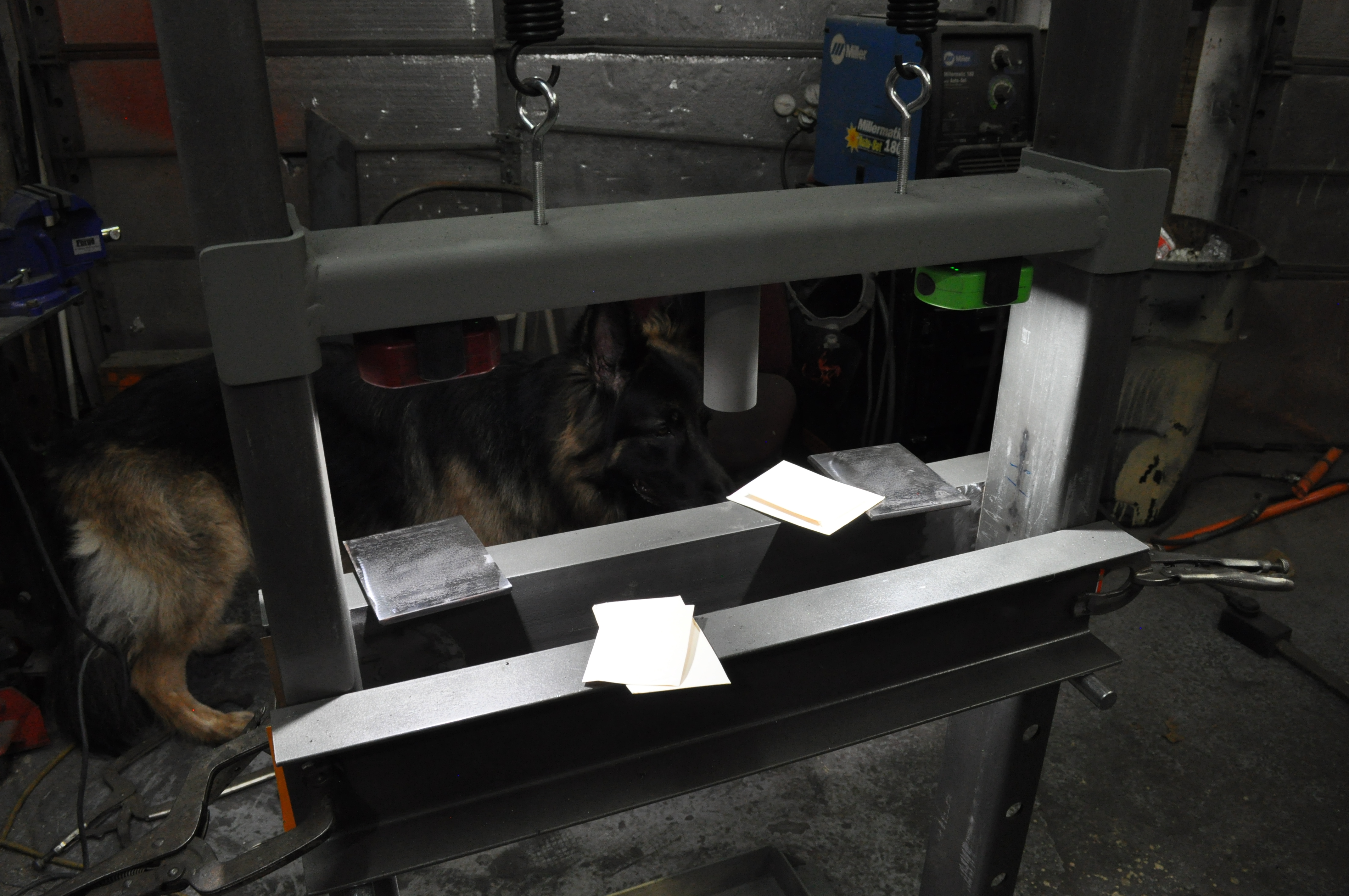

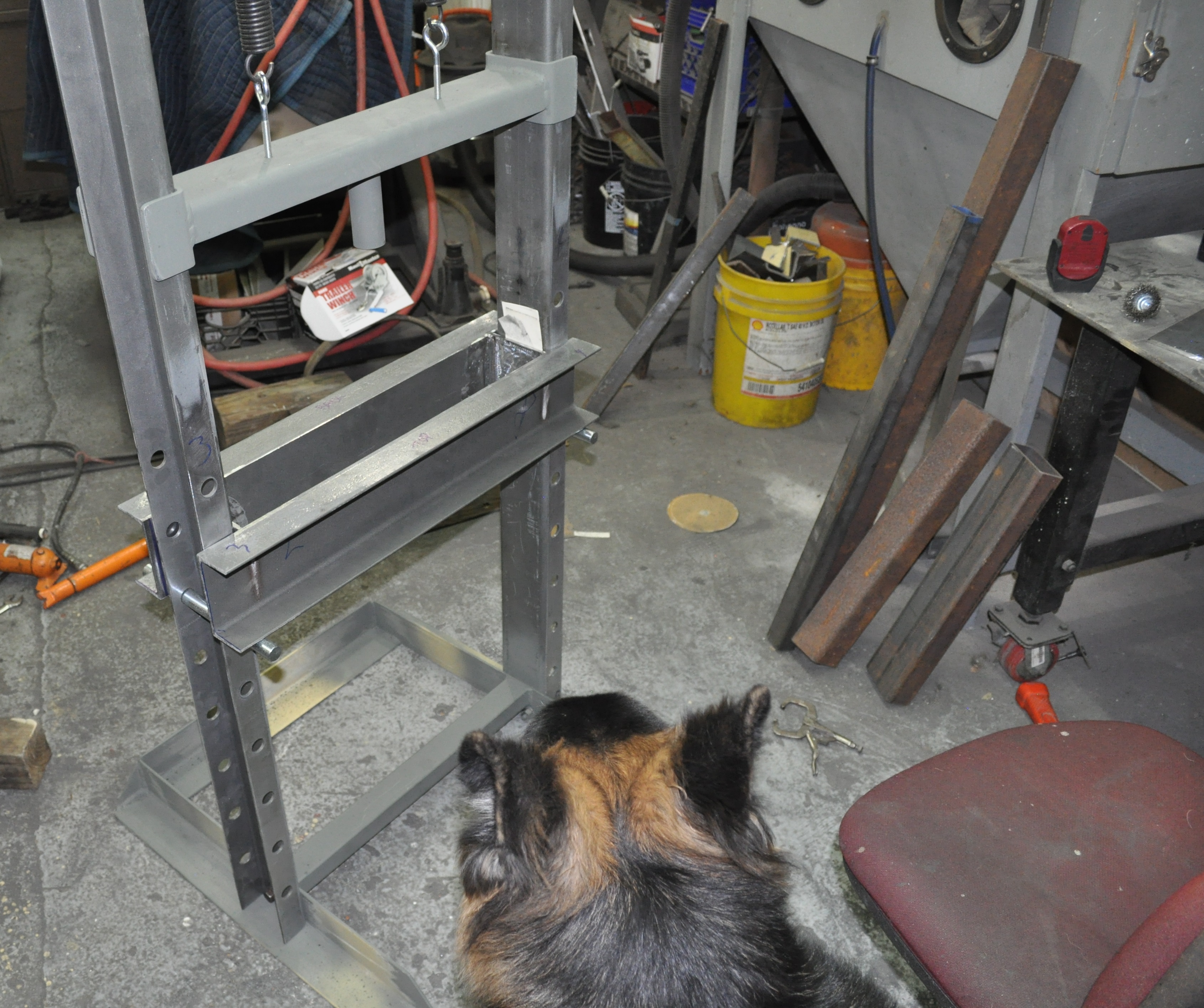

just a couple pics of my psychosis... lower cradle build...
#CyclopsFTW #Kaibomb
full
2 biz card gapping....
full
cradle will have the outer lifting plates done tomorrow... they're cut already...
full
full
so all the structural, time-consuming stuff will be done for the most part, other than the box...... I think I have a plan for that... but part of that plan involves needing the break, I've yet to build... ;)

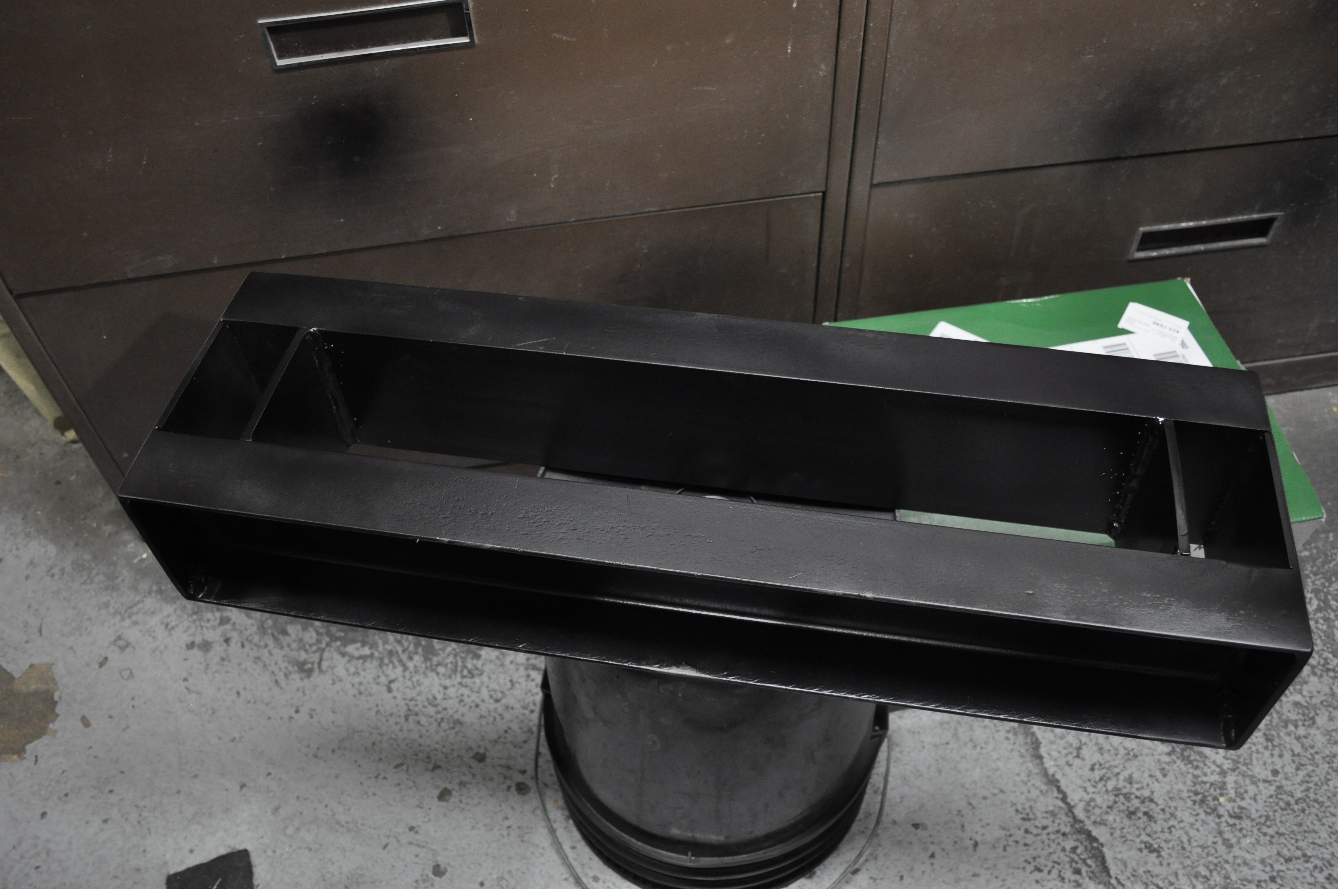

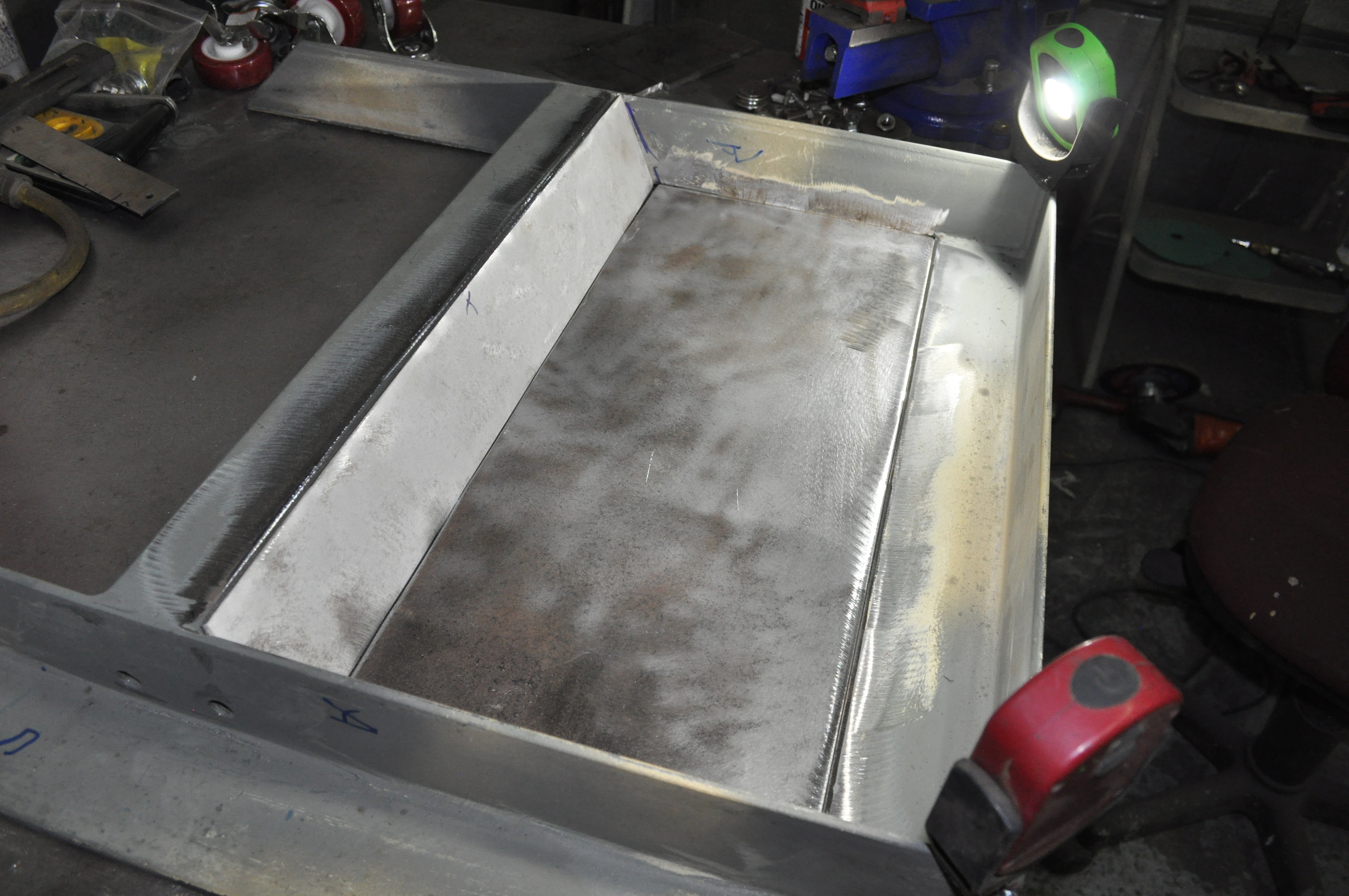

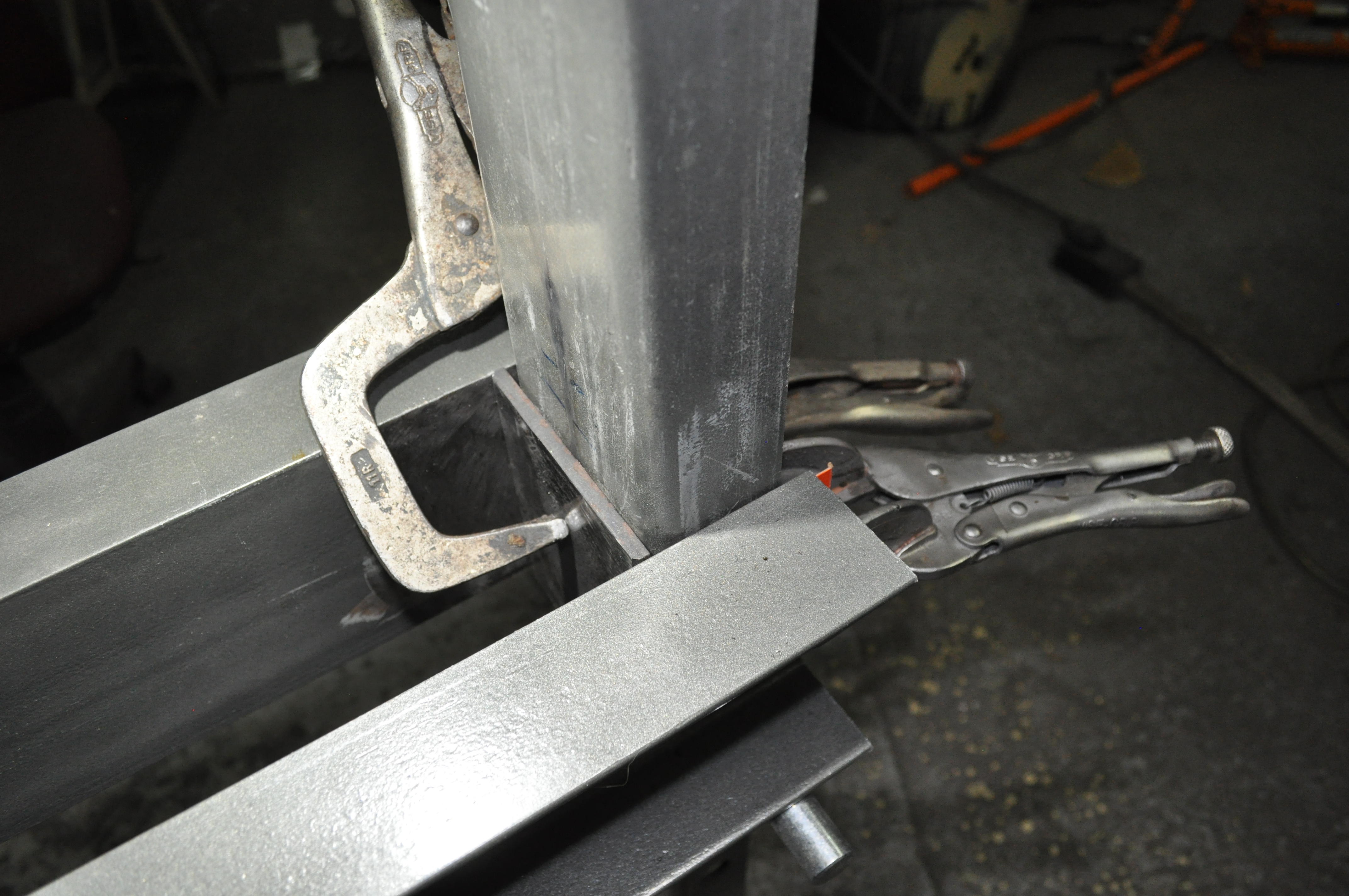

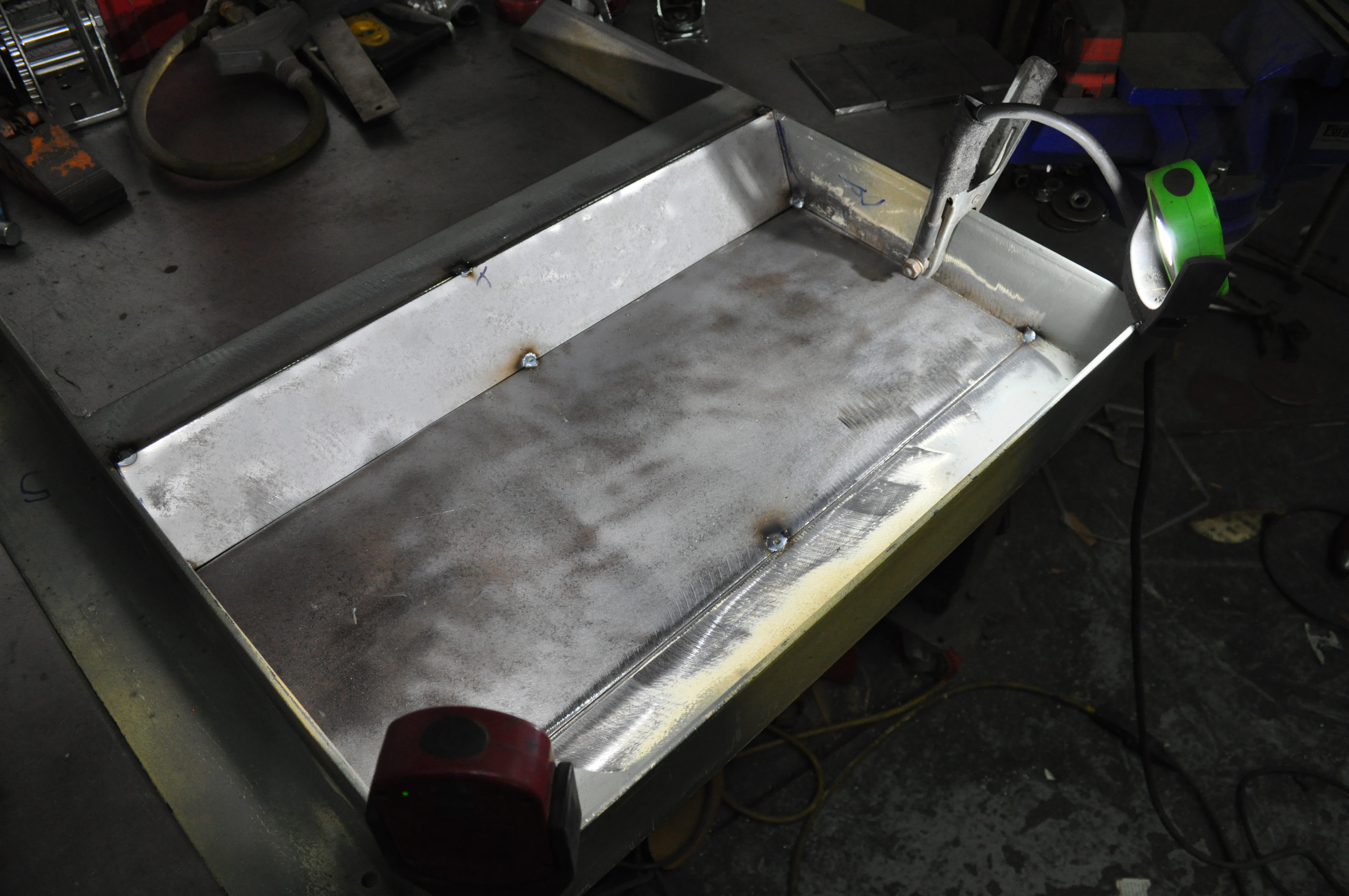

I'll figure something out.... got diverted today... ended up drilling the base for casters instead of finishing the cradle..... and boxing in that front tray deal... I had a couple hunks of 3/16 around for it that where nearly perfect, few cuts...
here's a couple mockups...
full
the forward wall is angled for the bolt clearance.....
full
I'll burn em in in the morn... 3/16 should be plenty stout for throwing plates down in.. not sure what to do about a top.. i don't have material.. other than alum, and not sure i want to do that.. I'll add it down the road..
for now tho, I'll throw some black on the base, throw the casters on and that's done.. at least I have a tray for plates, drivers, etc now...
after draining almost my entire 5/16, 3/4" long bolt/nut collection, here's the base... for now...
full
off the top of the head, I would say it weighs 30 to 35 lbs...
a future foot pedal would basically be a plate welded to the inside, forward right leg for it to mount to....

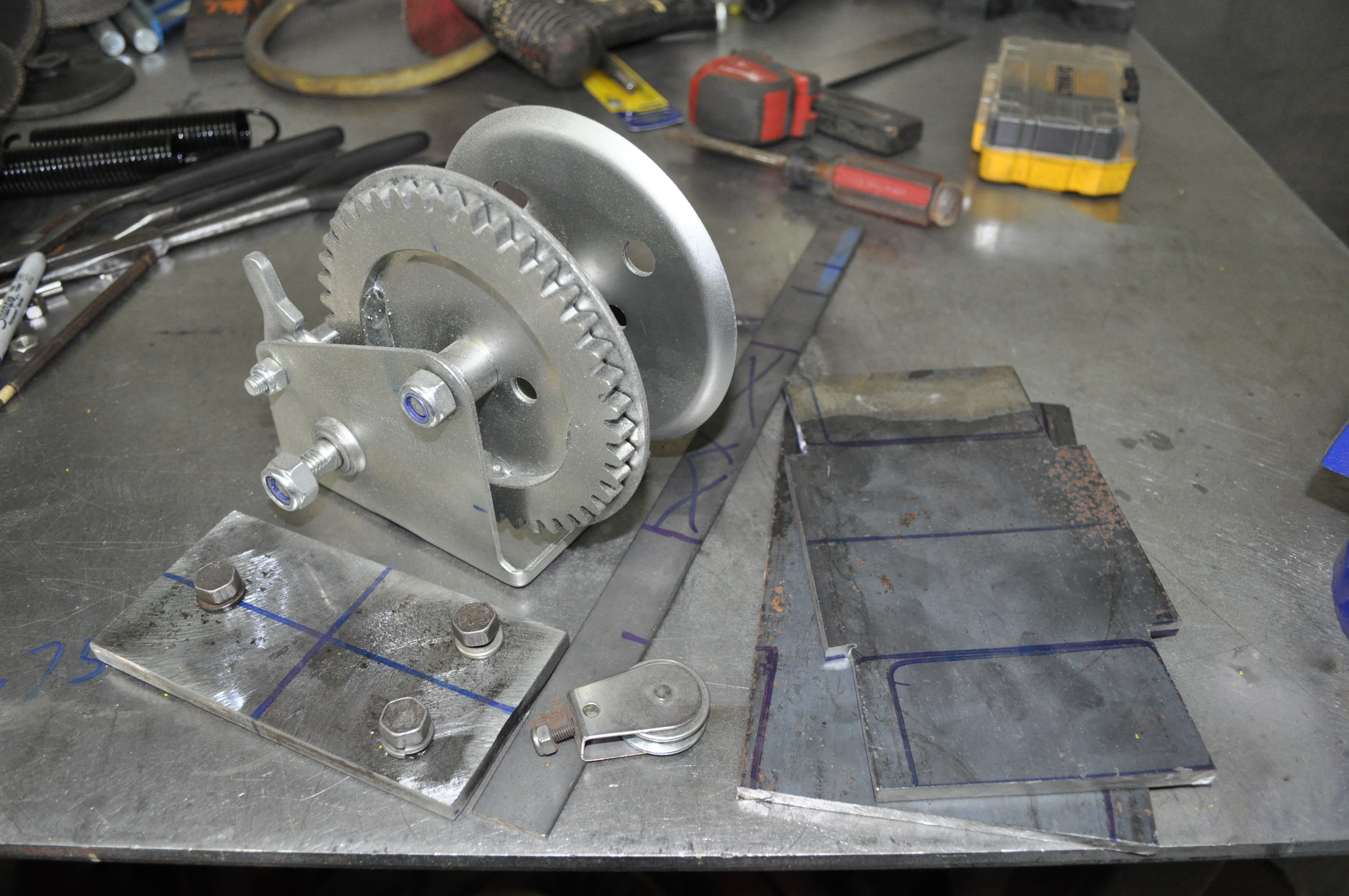

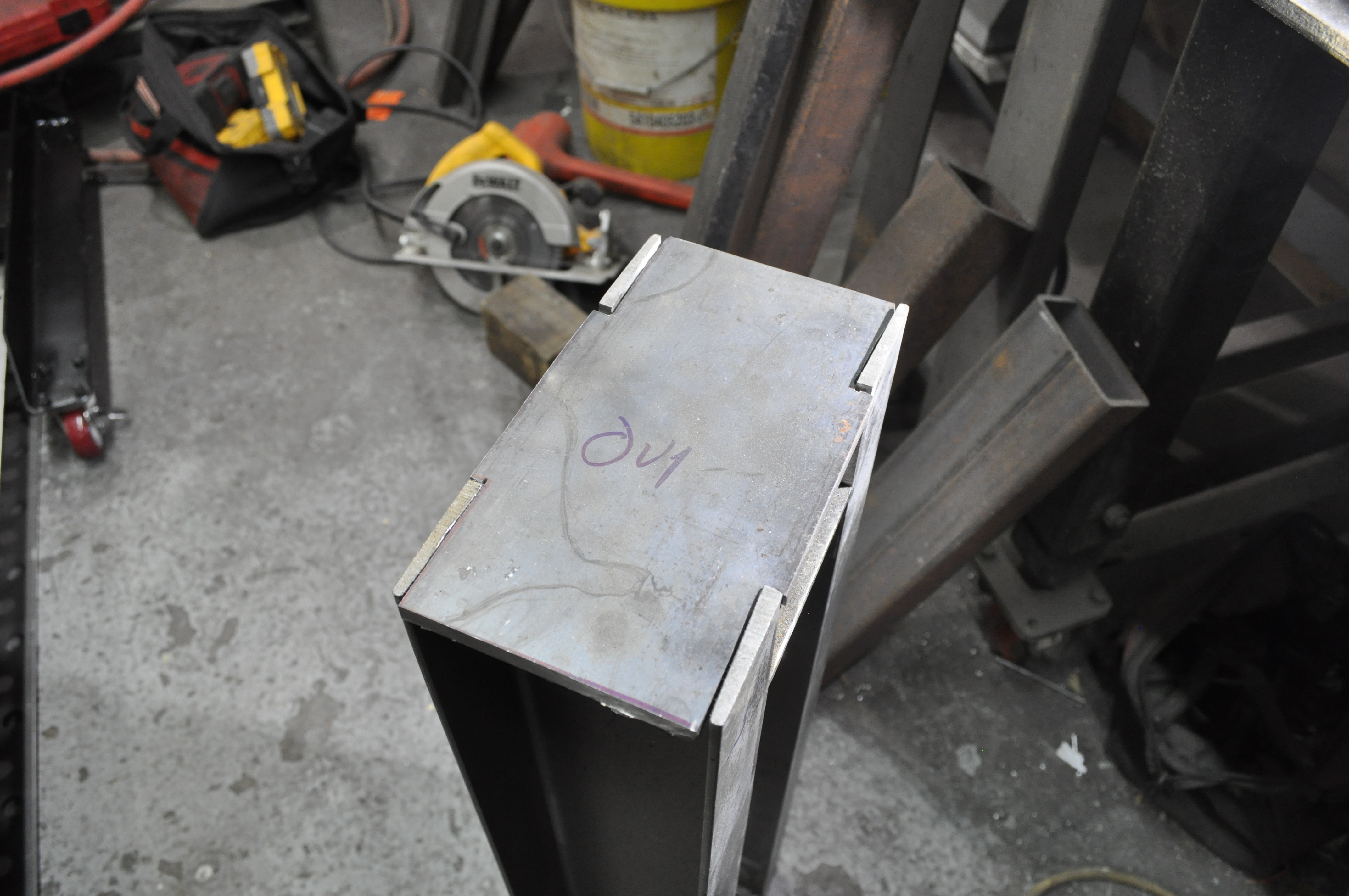

here are tomorrows projects...
on the left is the tapped, winch plate to be welded to the top... the middle is the strip steel to be bent for the pulley brackets... and to the right are the stoopidly excessive end lifting plates for the lower cradle...
full
God forbid I just put a little plate in with a hole for the winch line... nah, I gotta stiffen the whole thing up.. ;)
full

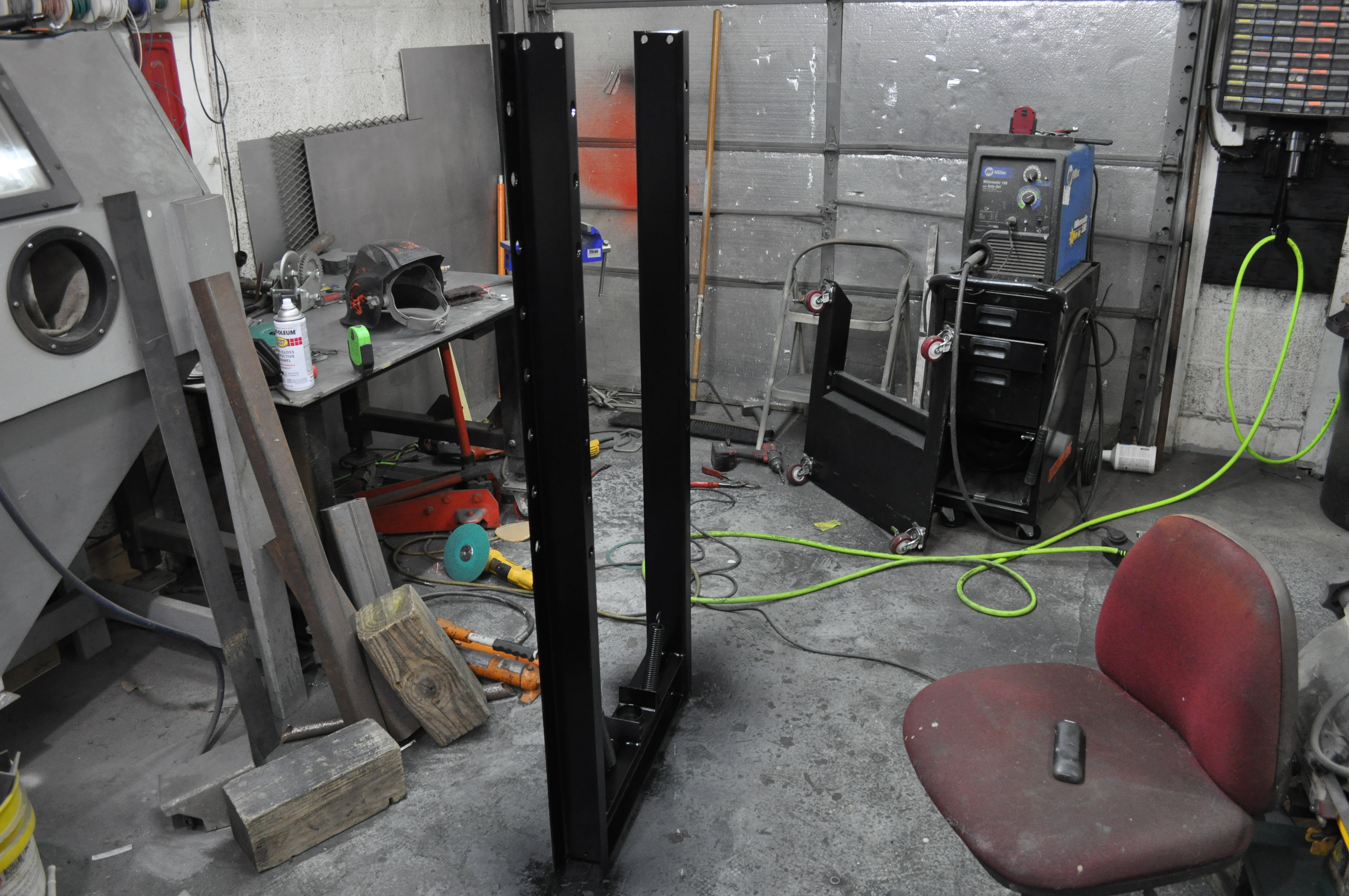

ready for some self-etch/paint...
full
full
threw a little on the rest.. tho there is a bit of welding to do up at the top still...
full

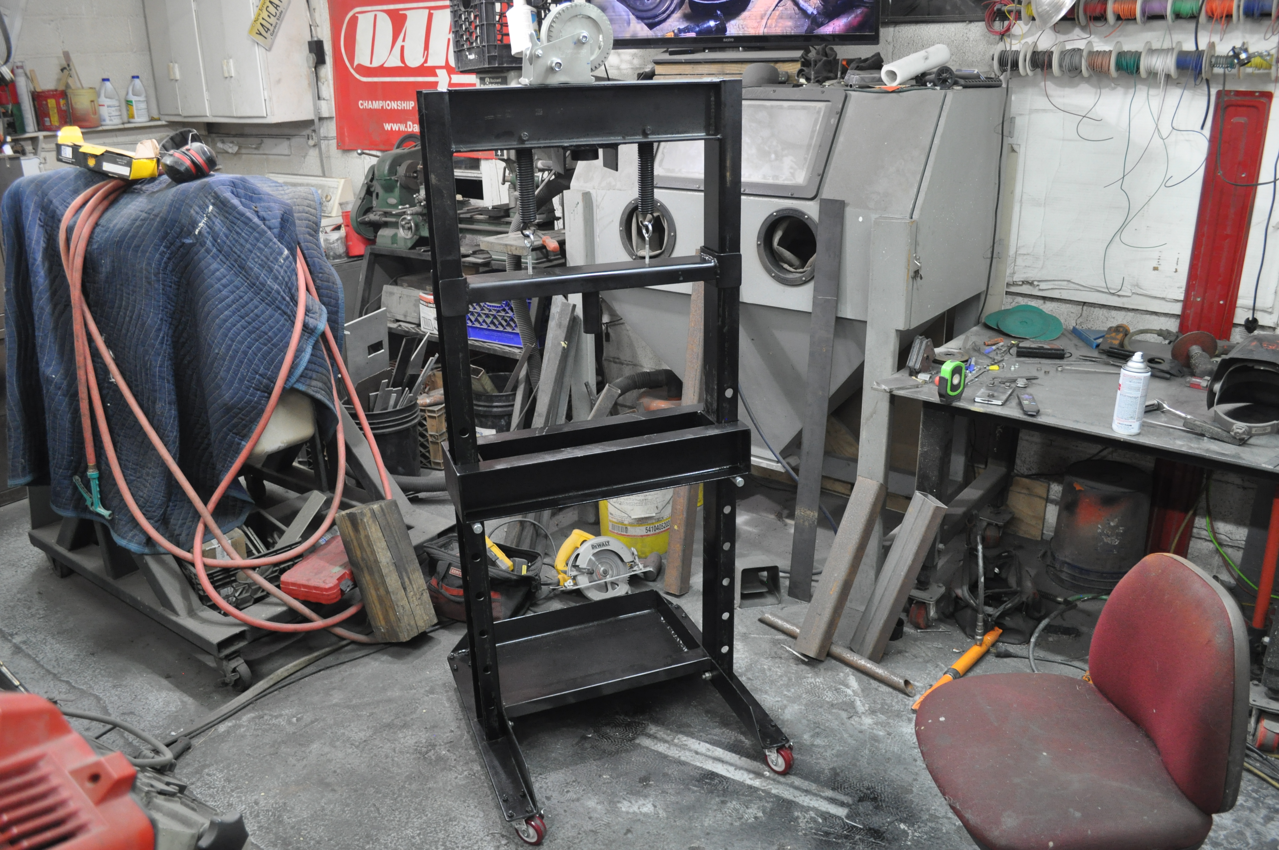

tomorrow I can put the cradles and base on for good.... than it's on to the fun stuff....

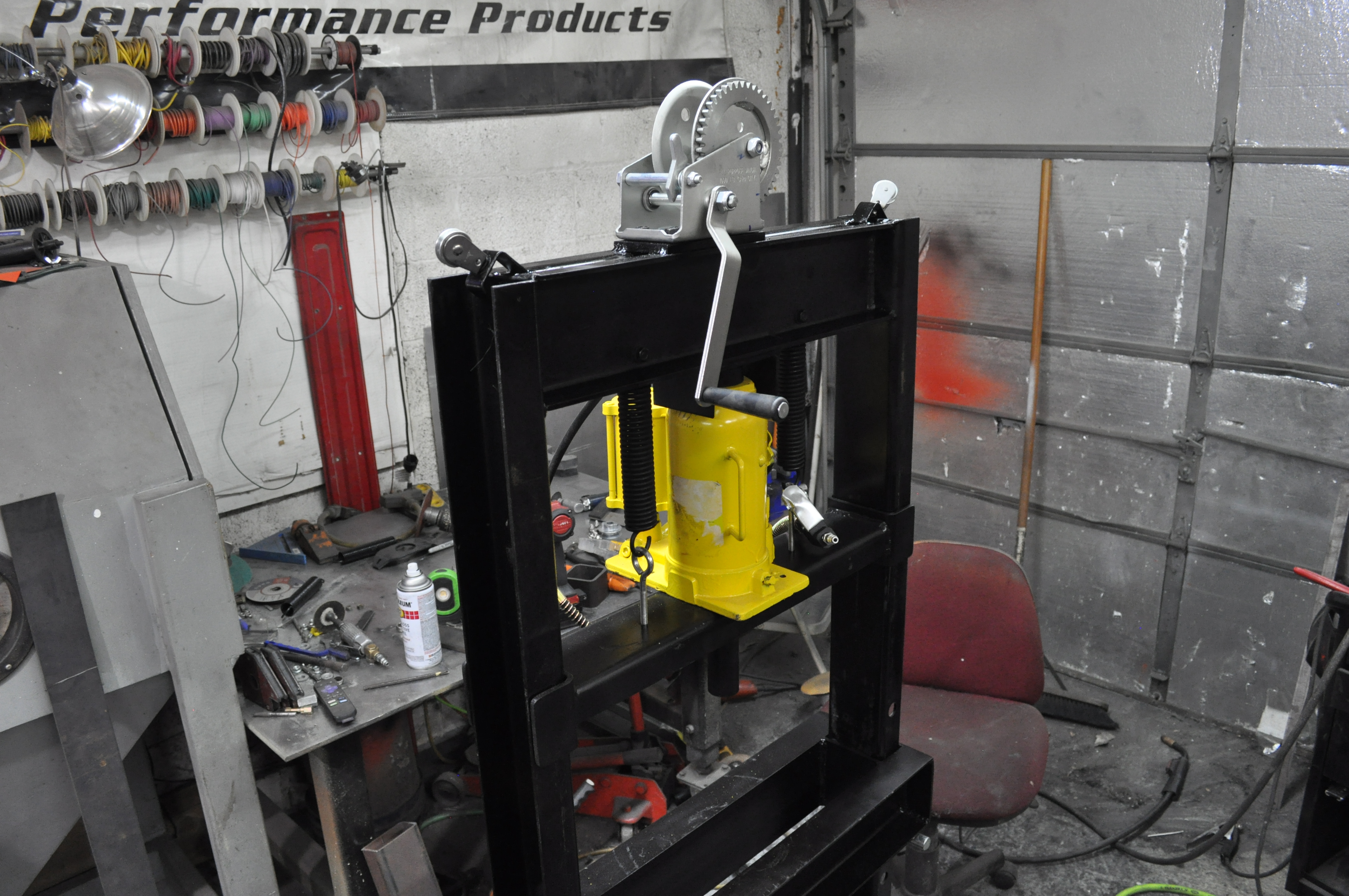

lathe motor showed today too.....
now we're cooking with peanut oil.....
full
oh, and I revise my statement a bit Wade... while the HF steel has seemed pretty solid while cutting, I did run into some instances today where I didn't like that side of the weld puddle...

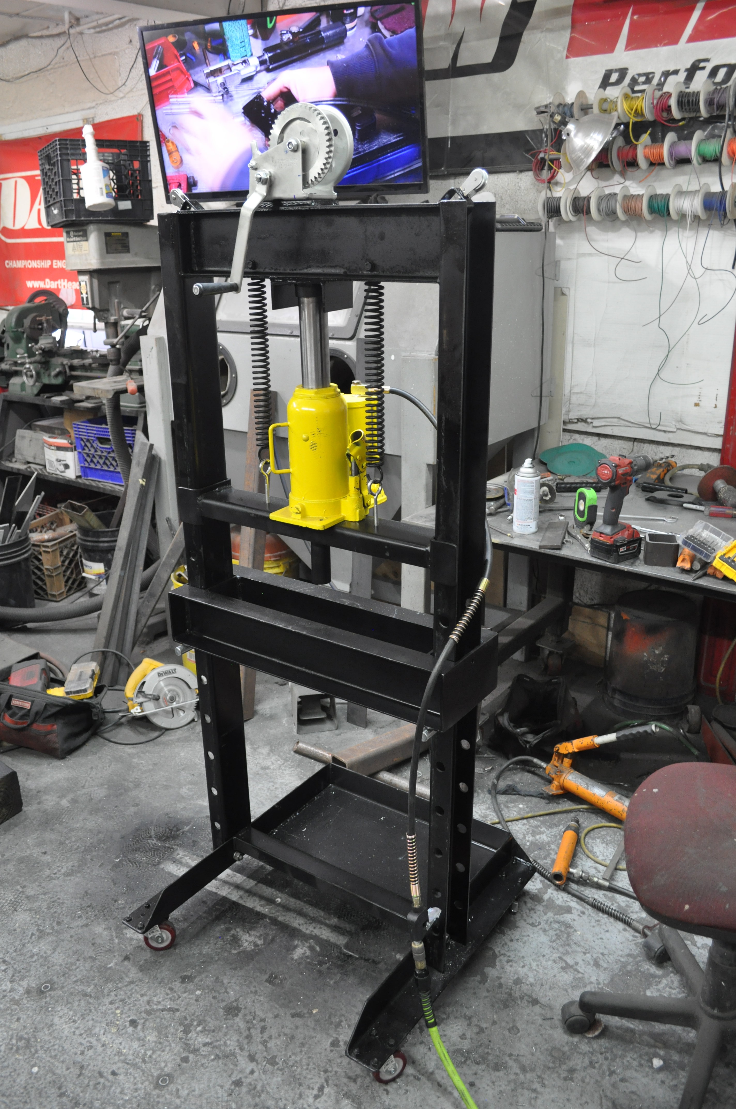

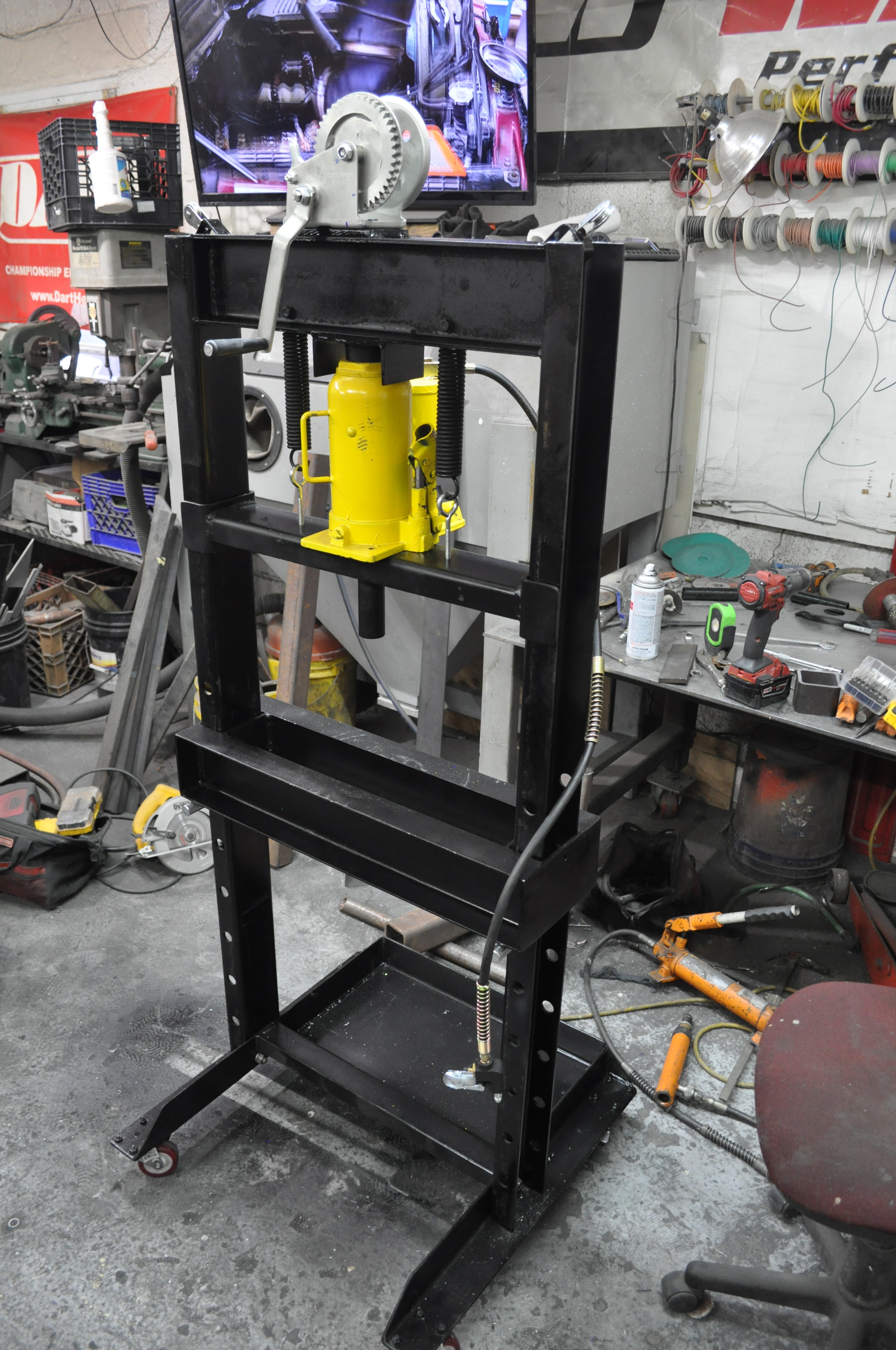

air over works awesome...
full
fully extended in about 30 seconds...
full
pulleys are done.. just waiting on my stoopid line for the winch..
full
next will be the small stuff.... new hand lever and holder.. new knob setup... pinstops... winch line...
