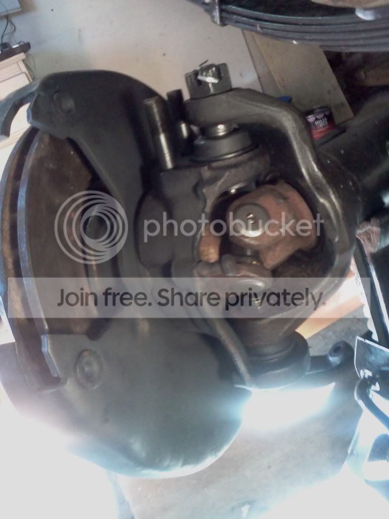

Guess who forgot to torque down the lower ball joint? :doah:
Now what really sucks is the hub wont come out. So any ideas how i can just tighten this down? And of coarse the whole shaft is spinning.
put a bottle jack under the ball joint and jack it up till it has some weight on it. Dont lift it way up off the jack stand, just enough to get some weight on it. Then tighten it with a wrench.
You will not be able to properly torque it without removing the hub and axle though.
That is a good idea. Would the offset of a crow's foot affect the torque reading though?
