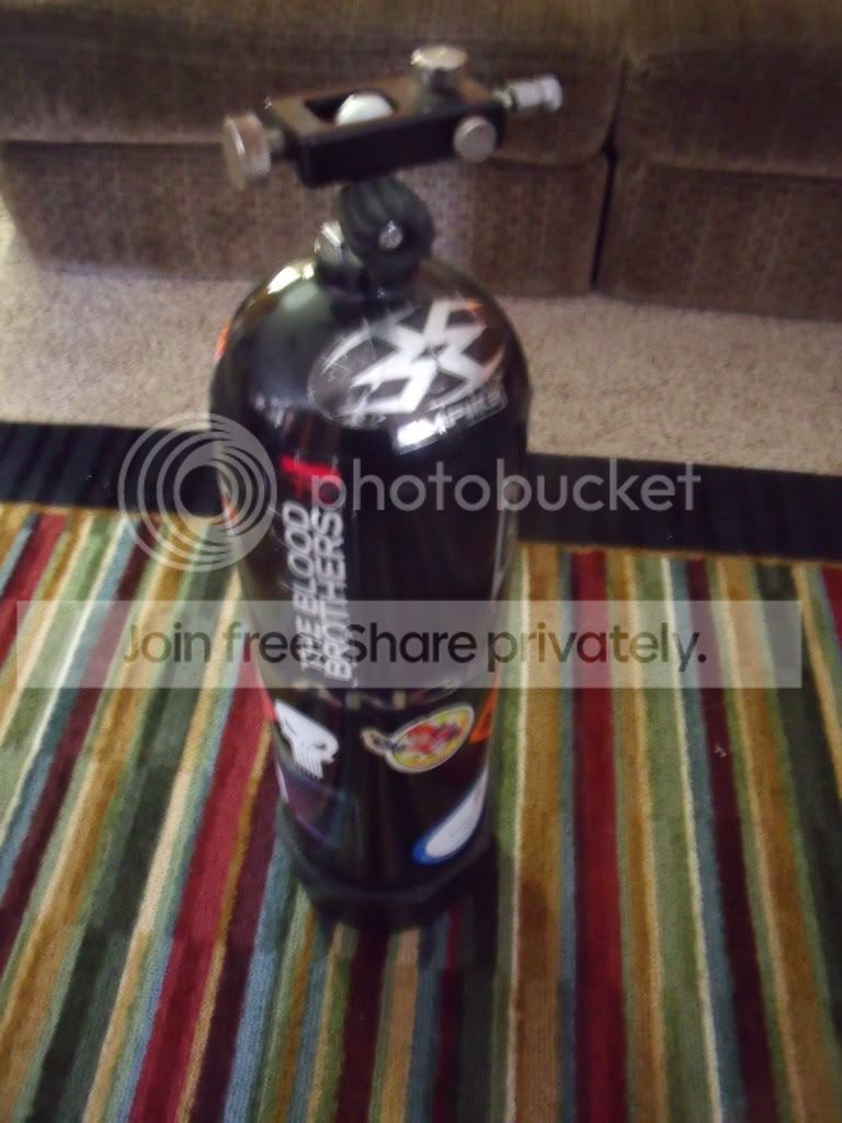

Im going to mount my Paintball Scuba. Im going to get a 120psi fixed regulator for it. But the 2200 psi would be sweet for setting a bead.... :eek1::haha:
Im just gonna run it as air. MUCH cheaper to fill. The local paintball guy will fill it for $5 and its way out of date, but he knows its never been used for diving, but only paintball so he doesnt mind.
Wow, $5??? That would be awesome. You mean for a small tank though, right? This is a big one like a diver would have on his back. Or do you mean you get a big tank filled up for $5 and then just use the air from it to fill the little tank that goes on your gun?

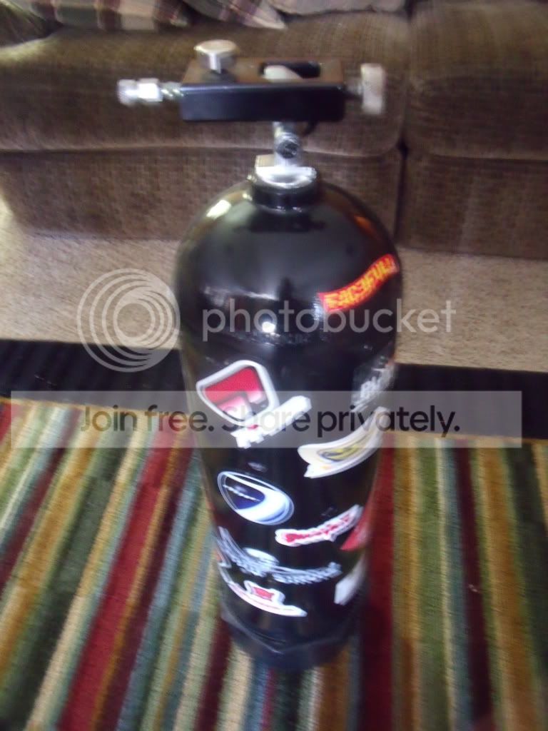

Yes fill the big tank for $5 and I have a special head on it to fill the 20oz tanks for the gun :thumb: Ill find a pic of it
EDIT: here ya go :D
The head on top has a gauge on it as well. I just need to get a fixed regulator and a hose for it and mount it behind my seat. Should look badaZZ
