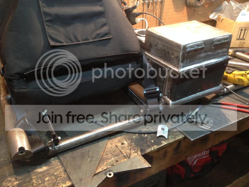

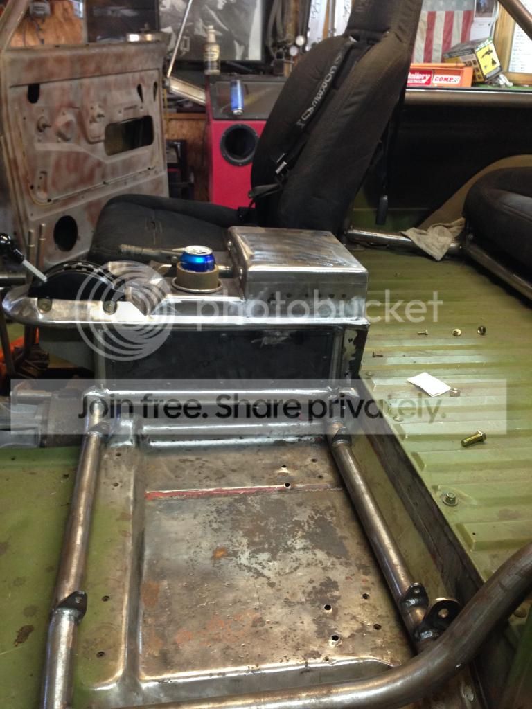

I ended up in single. Kinda glad I did In the end. With the way my back tubes bend up towards the center console section, it was pretty tight.
And let's be honest, this should be fine for the weekend beer runs to the 7-11 with the occasional trip to the mall. :pimp:
Here is what I ended up with.
Thanks for the replies, guys. :bow:
Those will due. Have done a bunch like that. Even in desert race cars. Of. Ourse thay were running in low HP classes.
