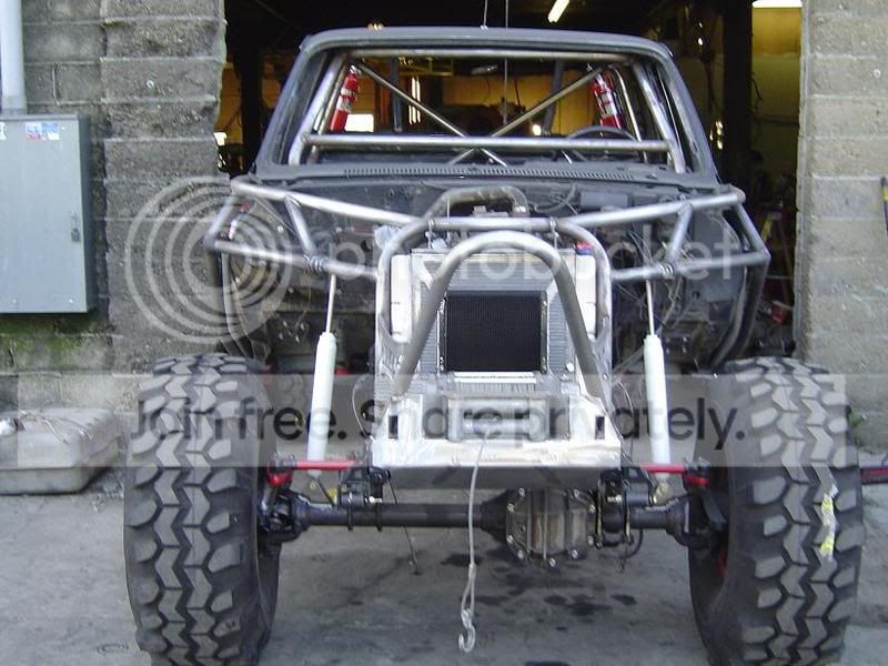

These are designed to fit as far outboard on the Dana 60 axle as possible. Welds to both the tube and the knuckle. A side benefit is the reinforcement for this area. 1/4" thick steel, 1/2" diameter hole.

They are designed to go straight up. Probably more of a buggy application or tubed front end. Could go with a shock hoop of sorts as well.
i'll try to get a picture. We put them on stompers truck I think....
