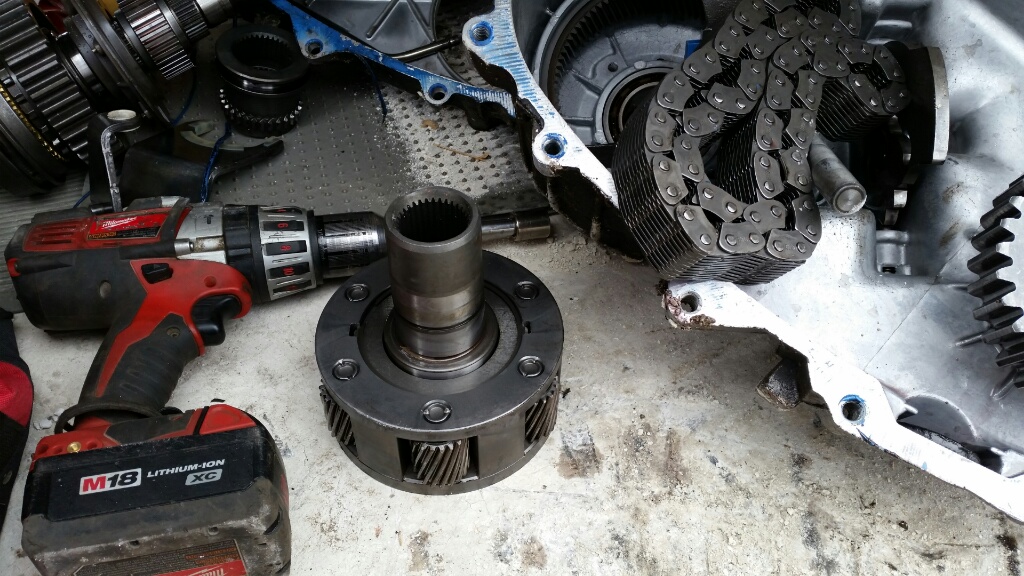

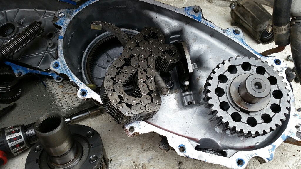

So, I went wandering the local junkyards today to see what I could find. I decided if I'm going to have to rebuild or replace I might as well go for a 241 instead.
I was striking out finding a passenger drop 241 until I find a 91 suburban and what should be sitting on the ground next to it, passenger drop 241c with a 32 spline input! :woot:

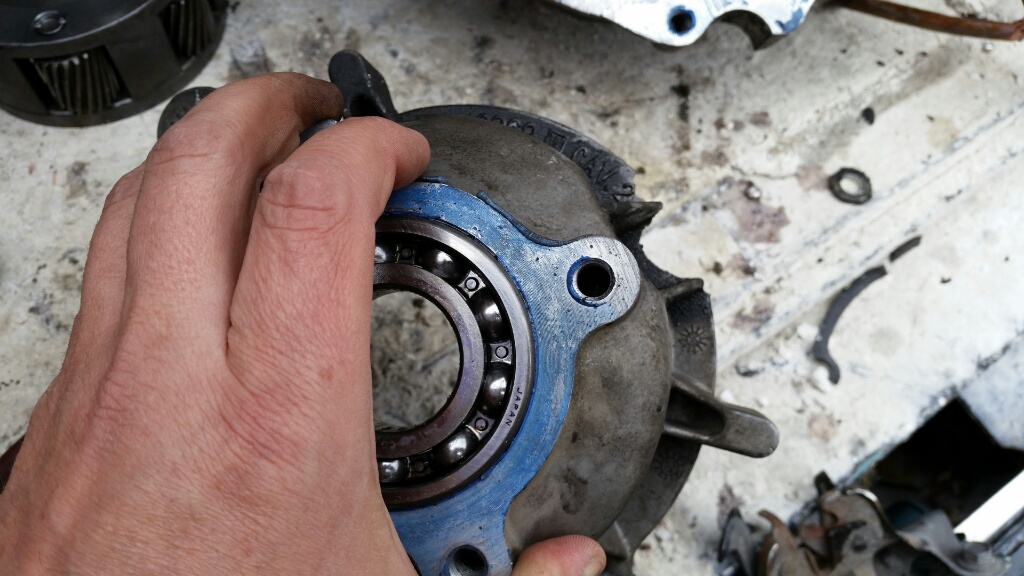

At first I think I struck gold but it was really caked with oil and someone had tried taking the output shaft housing off and failed. They managed to break off one of the tabs for the bolts.

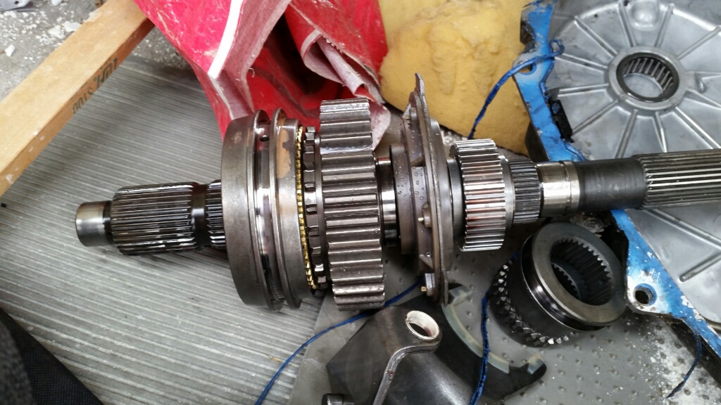

This yard wanted more than I wanted to spend for a broken transfer case, but I decided that grabbing the input shaft was worth doing so I took it apart to get it.
I snagged the input shaft and chain but honestly the rest of the internals looked pristine to me. I think maybe this thing had been rebuilt recently. Is there anyway to really tell? I put everything in the back of the suburban to protect it from the weather. Should I go back and get the internals if I can for a reasonable price?
As long as the case keeps oil in it and no water, the innards will look perfect almost forever until you break something. Remember that in 2WD you don't really even have gears running in there - it's pretty much a straight shot. The chain only turns in 4WD and the planetaries only turn in LO. The #1 sign of wear would be the pads on the shift forks. If those look great, then somebody must have replaced them. That blue silicone may be another clue - I thought they just came with a gasket from the factory. IMO, used factory bearings in good condition are better to run than new offshore bearings (even some major brands are building some of their parts in China).
IIRC from another post on here, that broken bolt tab is from someone not lining the pump up or whatever on reassembly.
Maybe that's why the truck is there...some sort of t-case issue initially, try to fix it themselves, broke the housing, figured it wasn't worth dumping more time/money into.

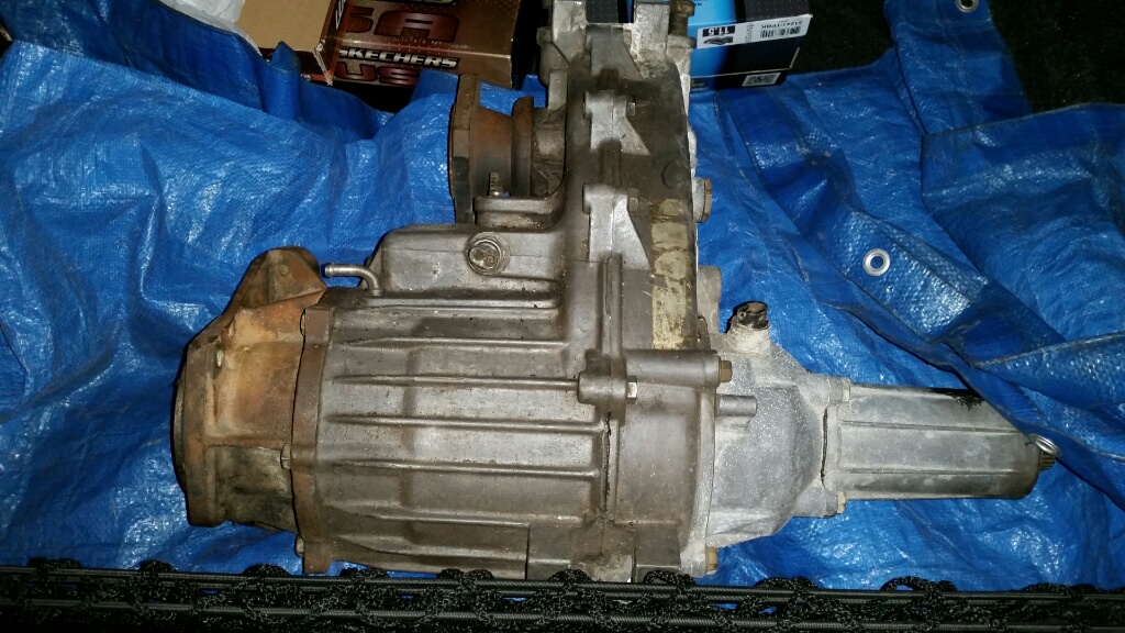

well, everything is working out well this morning. I just picked this up this morning:
Got it for $50. It has a 27 spline input so the input shaft I picked up yesterday will get put to good use too. :D
