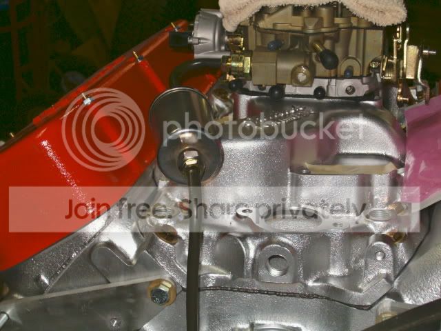

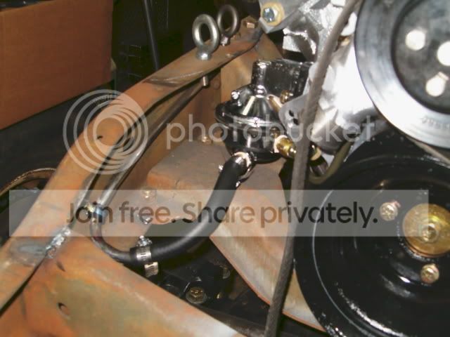

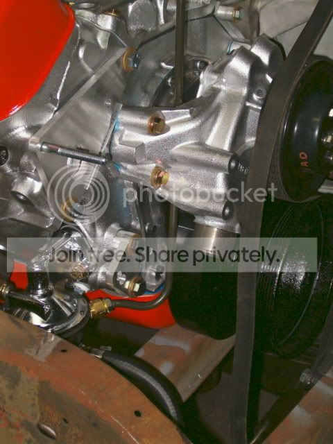

I'm curious about how folks plumbed the carb and regulator. Any pics? Any trick parts? Looking for clean, neat set ups.
Fyi, my fuel lines (feed & return) currently come from behind the intake but can be rerouted.
I ran a mechanical fuel pump 110gph? that required no regulator.
