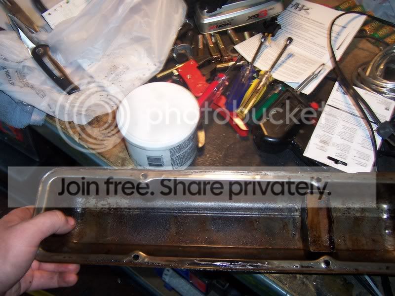

had to swap on a new valve cover gasket tonight on the driver's side...I figured it was a 15 minute job...haha was I ever wrong.
I ended up wasting a bunch of time trying to save time (you know how that goes) until I finally just decided to take the AC Compressor off its brackets to give me enough room to slide the valve cover down (the thingy on the inside of the valve cover where the PCV Valve plugs in wouldn't line up between the rocker arms)...anyways its done now :)
I spent quite a while getting the old gasket off of the heads as well as getting the build-up off of the valve cover... (check out all the black chunky build-up around the edges)...
Its a little finagling , but I can do mine without removing the compressor . I tack the gasket on the cover first , so it stays while I finagle it . I would also put the studs on after the cover is in place so it can be finagled better . Rubber ones can be finagled better .
Hmmm didn't think about pulling the studs...

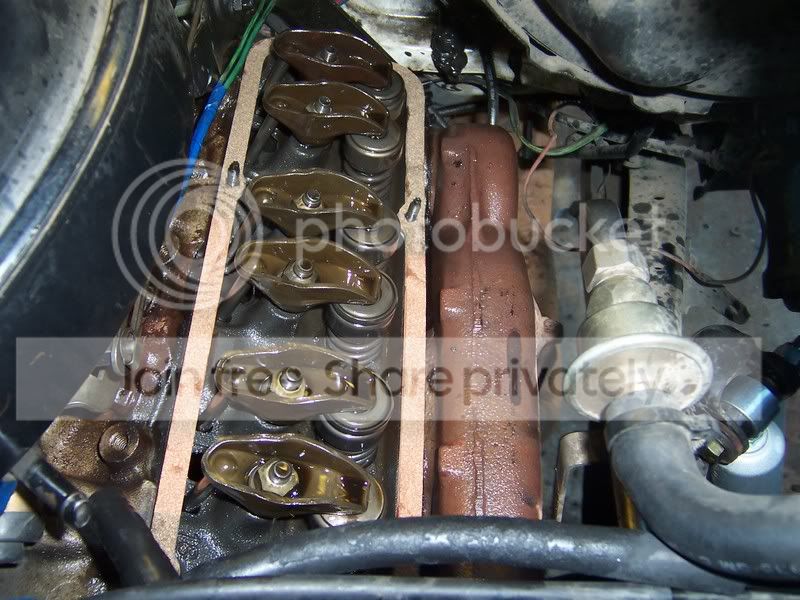

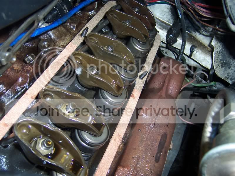

I didn't have any problem with the gasket...after I cleaned up the heads I layed it in place over the studs then just worked on getting the valve cover in place...
