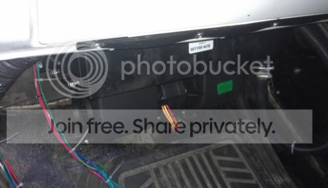

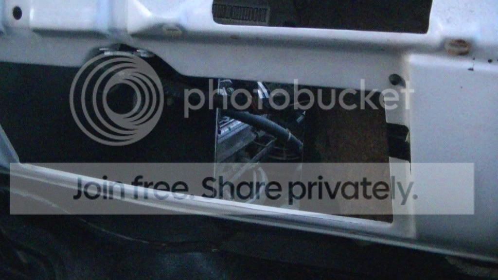

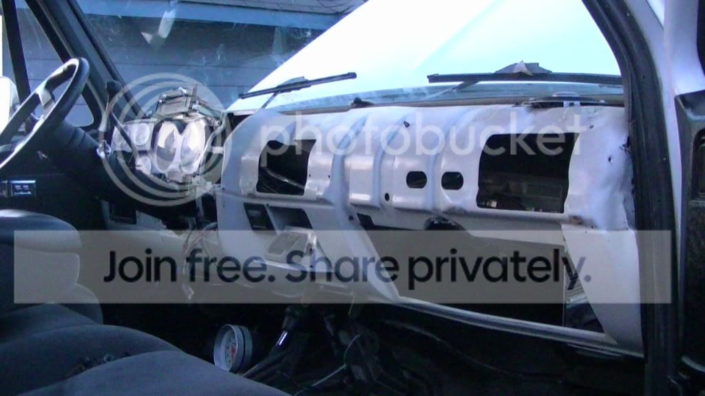

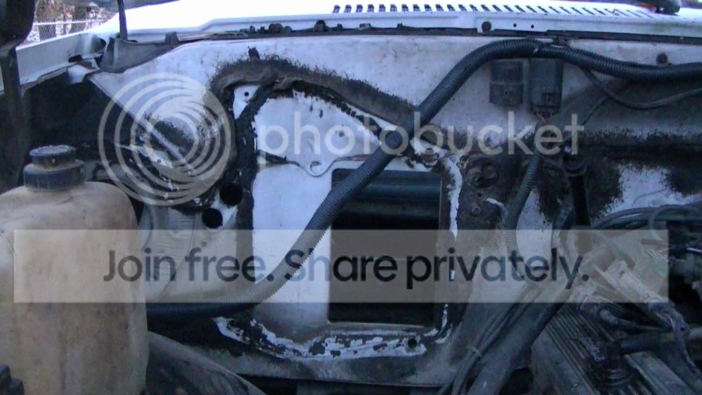

My wife got me a summit racing heater for Xmas. I have an 87, freon was non-existant in my system and I yanked everything out. A/C compressor, all lines, heater core....all of it.
Pay no attention to the wires....lol. I was in the process of wiring up an alarm when I took this pic.
