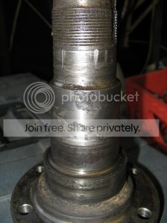

Does this spindle look trashed? My other side looks better, so I'll keep it. Also, how the hell do you get this bearing out? I've destroyed the other one, heating it, and trying to punch it out with a screwdriver and hammer. :dunno:

Just fyi to help identify a bad spindle in the future -
On the outer bearing surface you can see rough pitting running around the circumference, this is from a spun bearing. Then on the same surface you also see the short lengthwise lines/marks from a chisel, this is a temp fix to try an stop the bearing from turning - purely a band-aid.
here i whiped this up fast to pin point. CLICK PIC for full size and read better.
ah hell, I mine as well ditch the other side too. It's better, but not that great either.
Brian: It's an 8 lug D44 with 6 bolts on the spindle.
Thanks for all the help guys. Always appreciated. Never knew those marks were from a chisel, but I'll bet this is why I had a loud ringing sounds out of the front end while driving. :doah:

those spindles are junk if both have the same marks.looks like the bearing has spun and galled the mating surface.you can get spindles from your local parts store.i bought one a few years ago from national auto.i believe it was under a hundred bucks iirc.
