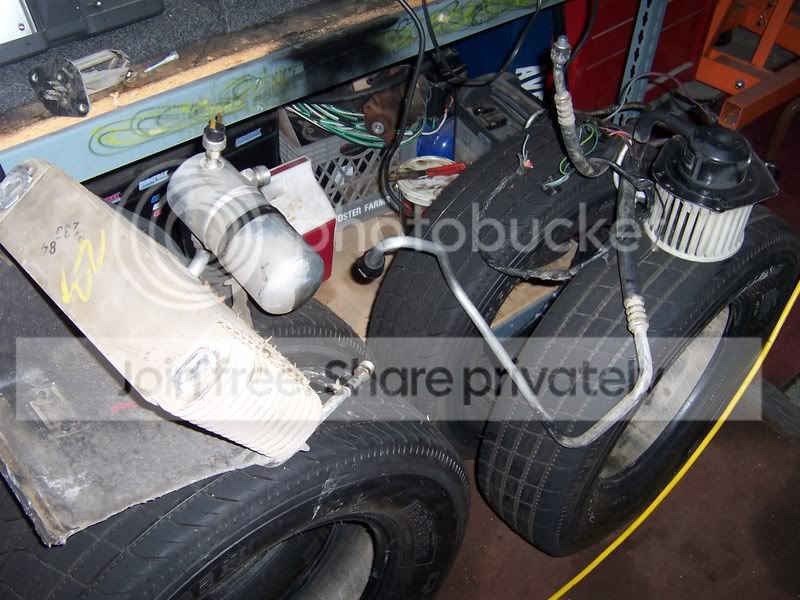

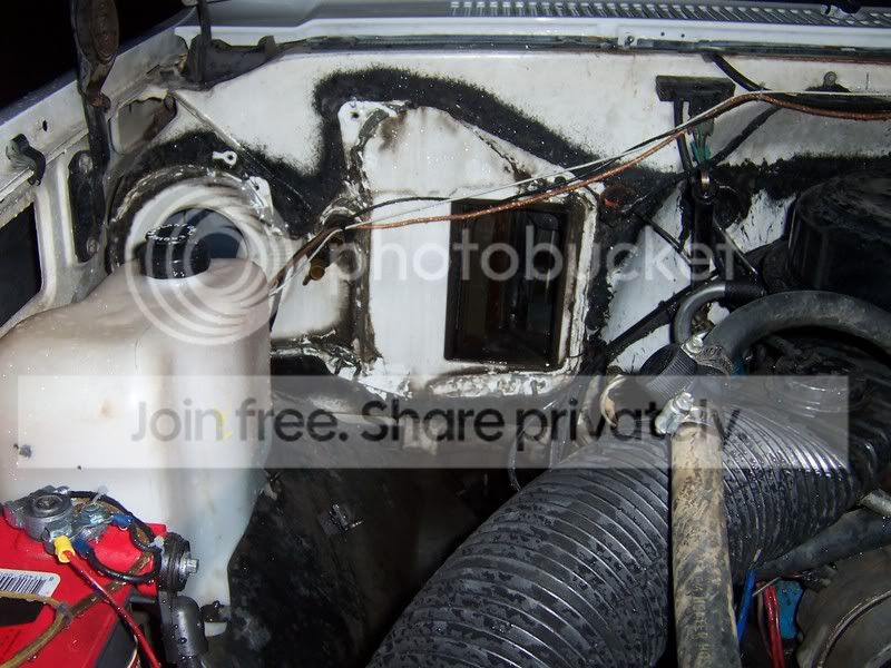

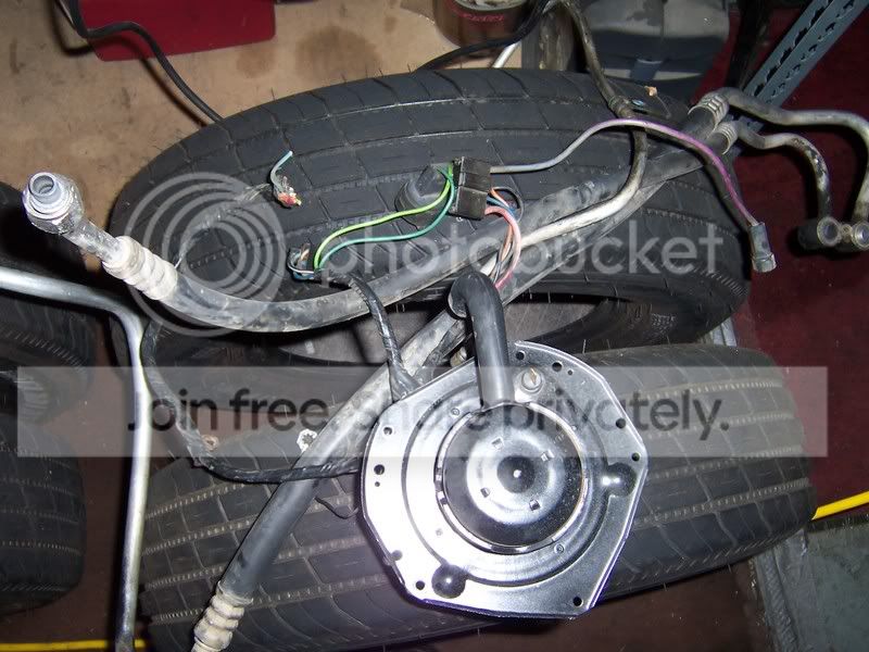

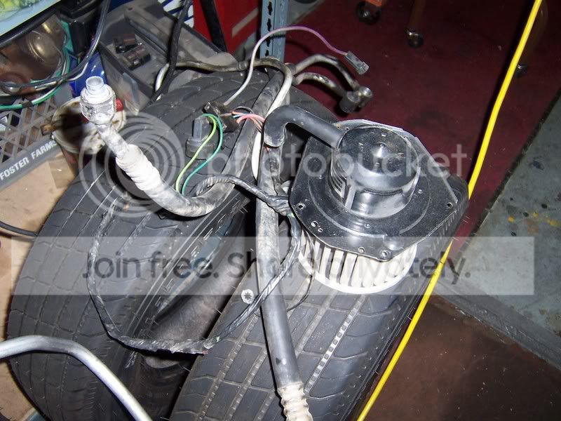

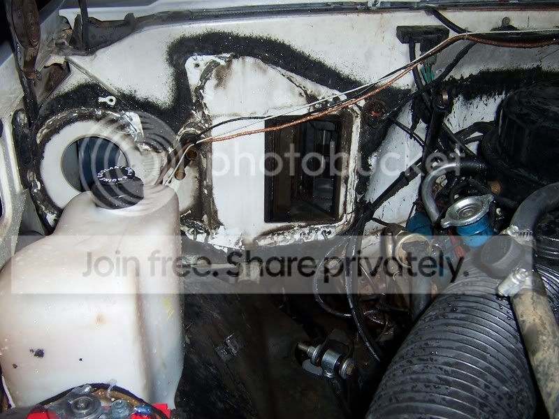

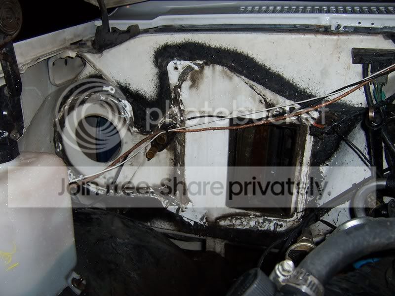

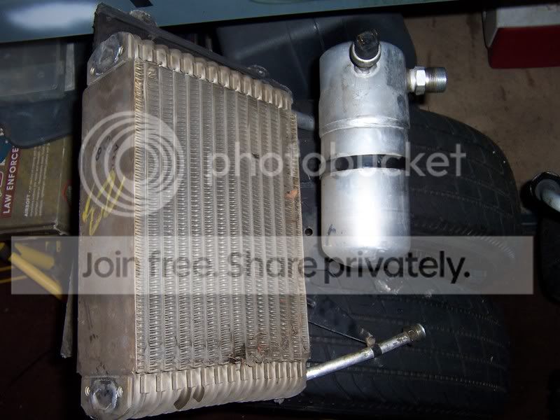

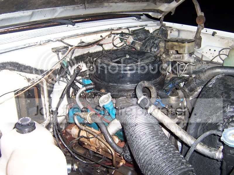

Snapped some pics along the way... the goal is to unclutter the k10 over the next few months before I start tearing into the suspension/bed project over Christmas break...
The wires zip tied in place aren't permanent... I'll get some holders for them and screw it into the firewall but I couldn't find any in the garage tonight.

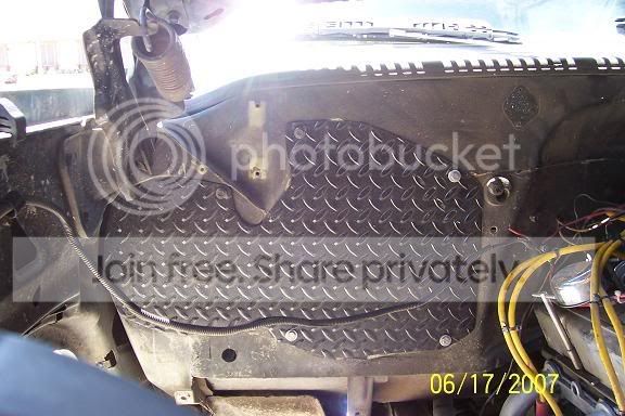

What do you guys think about the holes? I was thinking of just getting some diamond plate from the shop and cutting out some covers to bolt on... I'll hit it all with a wire wheel and throw some paint on it before though...
oh and btw I just looped the hoses together to bypass the heater core... it seems to work just fine...
Anyone need some old HVAC stuff?
Yep thats kind of what I was thinking...
On a side note... my next step is to ditch the inner-fenderwells which it looks like you've already done... the driver's side doesn't have anything on it (well it has the wiper fluid tank but w/e I don't need that) but the passenger side has the radiator overflow tank as well as the battery tray...
What did you do with the tank/tray?
BTW I love how clean it looks all finished like your's is...
Thanks
The Battery is in the stock location for now, I'm going to move it behind the passenger seat. The overflow tank is next to the radiator. I don't have a pic of that.

Yeah!! Time to start cutting.That's what I did with mine, Just used flat instead of Diamond. You plan to keep the heater, right??
Use adhesive/sealant to hold the panels in place. saves drilling holes. Use the good stuff from GM.

Yep it's nice to tear this stuff out... I've always envied my dad's truck when it comes to under the hood space... it's a '75 ford with a 390 but it doesn't have ANY extra stuff which makes it a piece of cake to get to stuff...
Until I green sticker the truck I can't go as minimalistic as his is (still have to keep the smog junk) but for now I can ditch stuff like this.
That's a good idea... the good stuff from GM? Do you get it from a dealership or something? What about good ol' RTV?
I would still use the bolts to hold it in place. There is going to be a lot of vibs and banging going on. I think he is talking about the stuff used in the ?hump? at the shifter area. The floor part you can remove.
Oh, I guess I misunderstood what he was saying... I could always use both like the factory did... put a little RTV along the perimeter as well as bolt it on.
