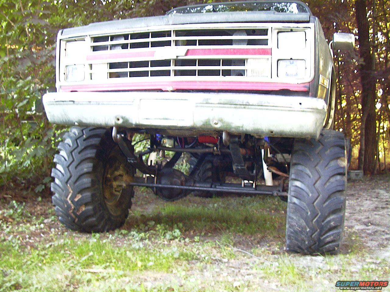

oh and with that much lift... not sure how you would keep the sway bar parallel like it needs to be, to be able to have it effective.
also I'm not sure why it wouldn't work, how would it interfere? Id as ORD to confirm... 8" lift should clear the swaybar... and fyi I had a 3" swaybar drop with 12" leafs and look at this.. I didn't want it... long story I don't want to get into now as I paid someone to lift my truck and was a total ripoff...
another pic and a funny one too.. but even closer shot of what a swaybar would kinda look like...
