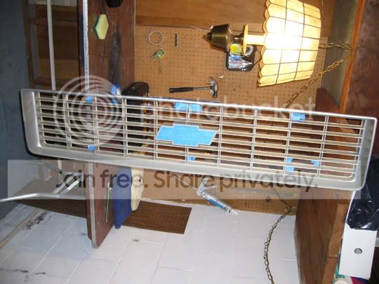

Thanks to Root Breaker I now have a brand new genuine aftermarket replacement grille for Big Ugly and want to paint it to match the truck. It's the non-chrome silverish paint finish (argent I think?:confused:). Should I just spray bomb it with primer and then spray the topcoat on or is the primer unneeded?

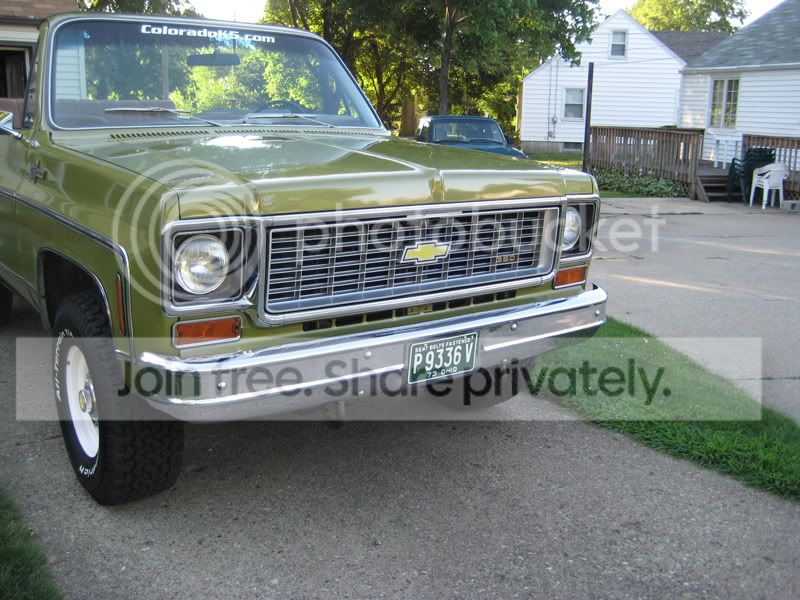

I painted my stock grill on my 88k5 flat black. All I did was sand it down with some 320 and sprayed it with the ole rattle can and imo it came out great.
grey scotch bright, degreaser and some elbow grease

1.5 years later I have seen it and it still looks nice.

I painted one walmart flat black, it turned out great and has held up great. I washed the parts with simple green and a blue shop towel. Then used some Bull Dog adhesion promoter spray I bought at Oreily's, then sprayed the walmart flat black. Very easy t do, looks good and easy to touch up if needed.
I just cleaned mine with degreaser, masked it, and shot it with rattlecan Argent Silver urethane wheel paint. Last summer.
I did the same flat black spray bomb job on my grill. Turned out really nice. Best part is flat black is pretty much flat black. If you ever get a chip or scratch in your grill... easy touch up my man.:cool:
Flat black it is. Already did the light buckets as the CARC makes a nice base coat.
However here's a lesson for ya...always check the paint cabinet to make sure you have enough paint to do everything. Grille just has a few splotches of black on it right now.
