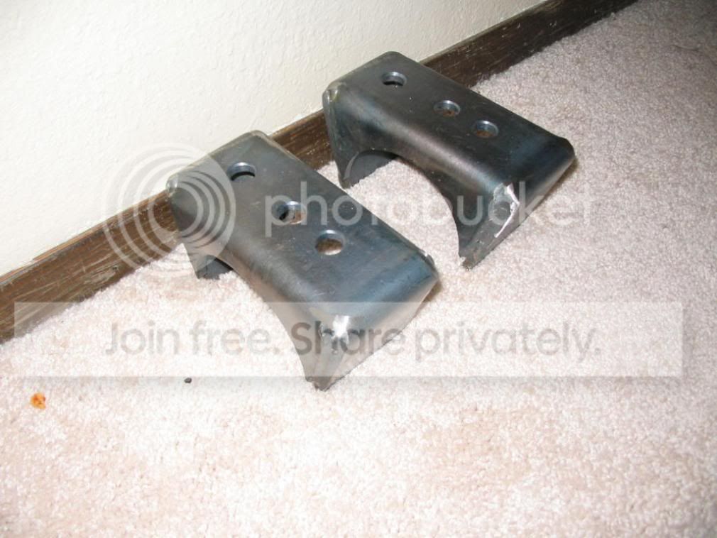

An option other than the zero rate is the perches from Kert. They have 1" and 1.5" offset holes to relocate the axle and don't provide additional lift if thats what you need. I just put them on my 14B because my heigth was good but wanted a little more wheelbase.
could you splain me a little more better please? :D :confused:
I think thats exactly what I'm looking for!!!
The perches from DIY4X.com
They have the offset holes like a zero rate, but without the lift.
