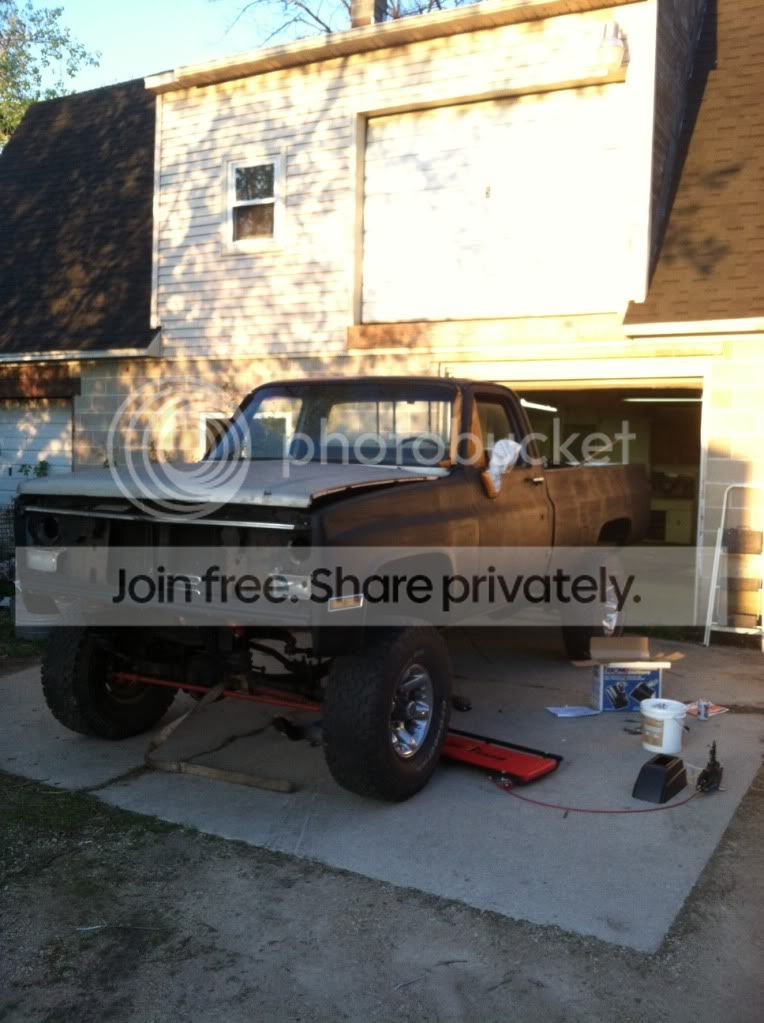

I think we deserve a pic. Can you post one? Use picturetrail.com to upload one and past the "forum link" into your post...
you asked and you shall recieve. i admit right now it doesnt look like much but im putting my build thread together and from what it was its alot better
Hey man, I think it looks great! Must have been fun drivin' it for the first time, congrats. Thanks for the pic.
