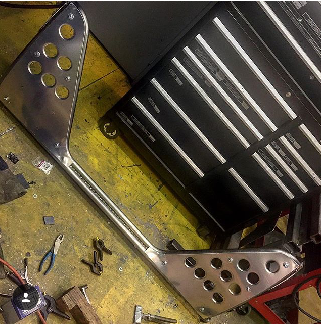

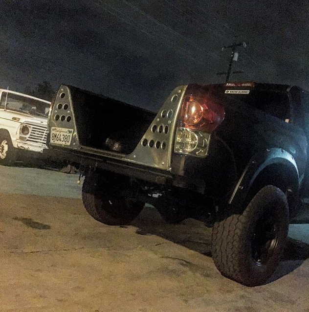

You can easily make a frame out of square tube that will very neatly slot into the tailgate area. You do have to notch the top of the body just a bit. At least on my '74, there were captive nuts welded into the sides of that channel, so you drill through the sides, weld a round tube through so you don't squish the frame, and you can bolt the thing in place nice and solid. If memory serves it's 1.25" square tube, but maybe 1.5". You can measure easy enough.
Hard to see with the crazy paint, but some pix:
from there you can do anything you want. Expanded mesh, the fifth-wheel pattern instead of full rectangle, whatever.
Then if you don't like it or wanna switch, you unbolt, slide it up, and switch back to the original tailgate.
