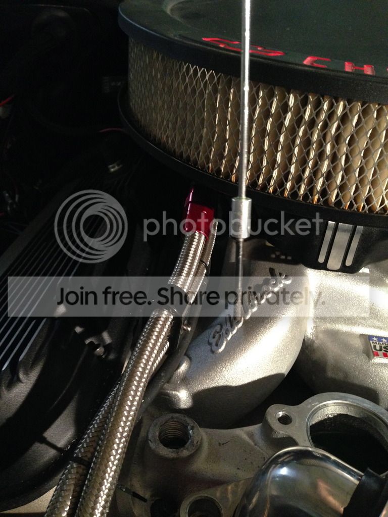

Oh boy... the driver's side NPT plug (aluminum) seized in the intake when unscrewing it. Ended up having to drill it out and cut it out. However, in the process of cutting it out with a Dremel cabide bit, the bit pulled out and rolled down into the water jacket of the driver's side head :yikes:
Gonna run a magnet down it tomorrow to see if I can fish it out. If I can't, how screwed am I?

Yeah, they're aluminum heads. Hoping a magnet will do it.

Went fishing tonight into the intake and driver side head coolant jacket. First cast, pulled back this little f***er. :woot:
Now I just need to run a tap thru NPT threads on the intake to clean them up. That'll happen this weekend.
