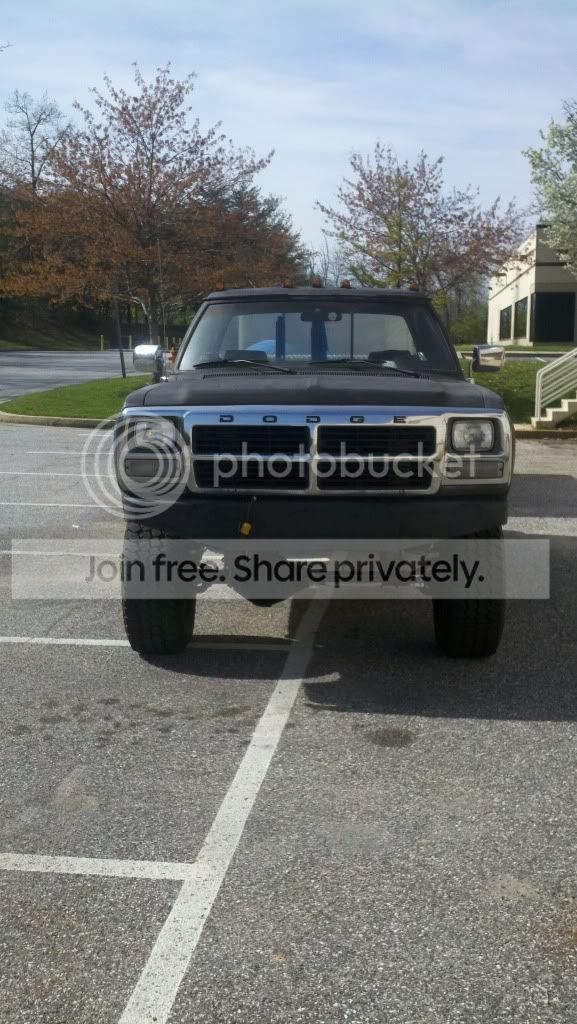

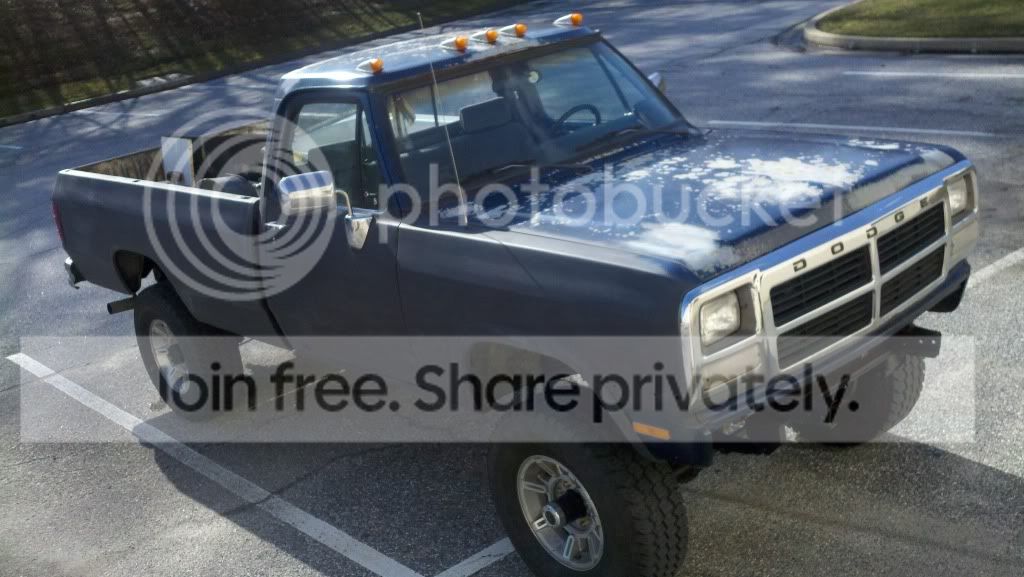

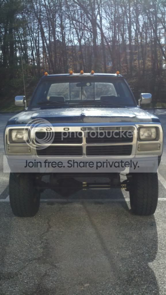

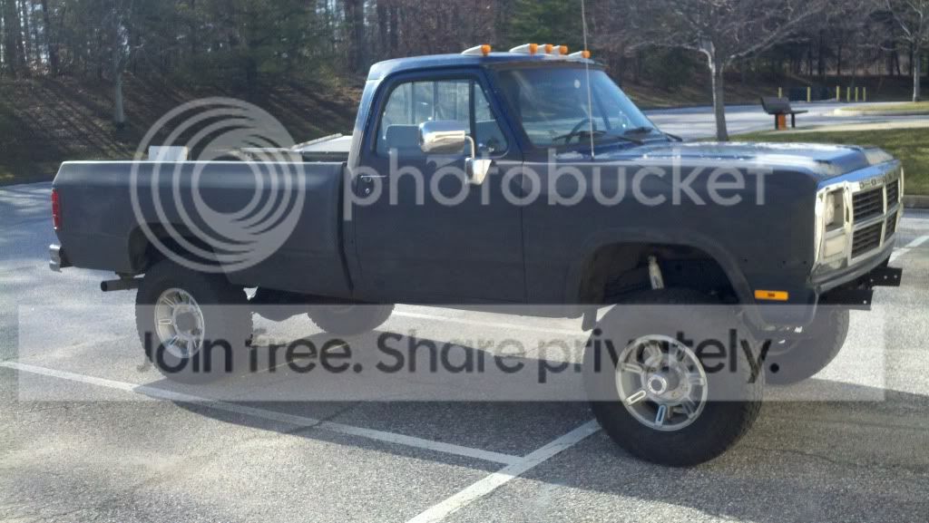

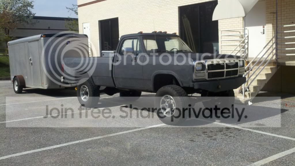

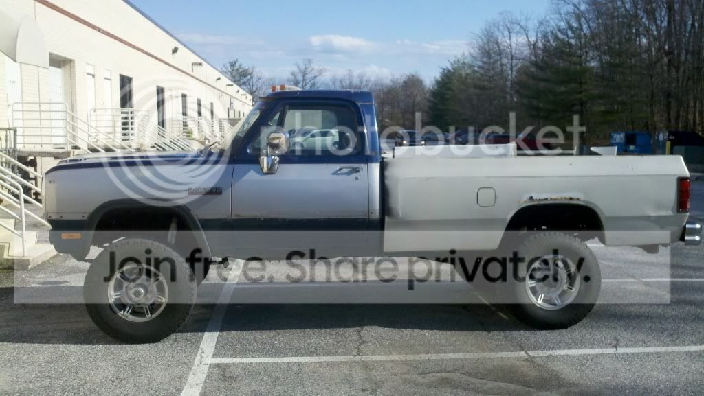

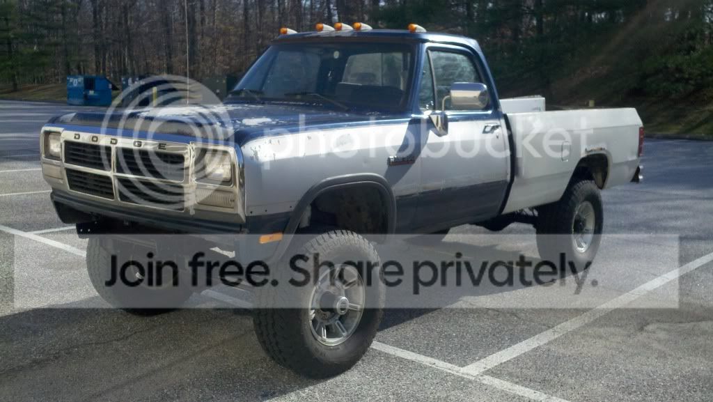

Damn, I kind of forgot about this. Truck is driving great does 80 no problem, the suspension is too stiff but thats something I can tweak and perfect over the next few months. I replaced all the steering component with new stuff and added a stabilizer and a borgeson steering shaft which really tightened up the steering. Anyway, here's a few pics
Dr. Jekyll:
Mr. Hyde
I'm still working on the body work, the passengers side is all smother out and in primer but the Drivers still need a bunch of love.

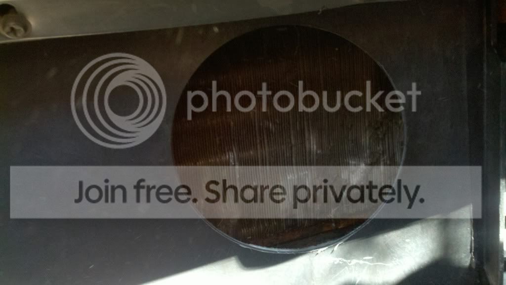

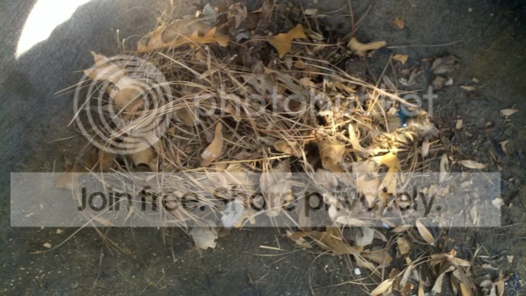

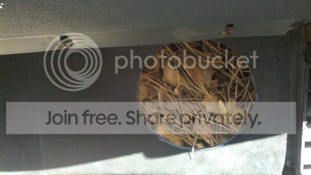

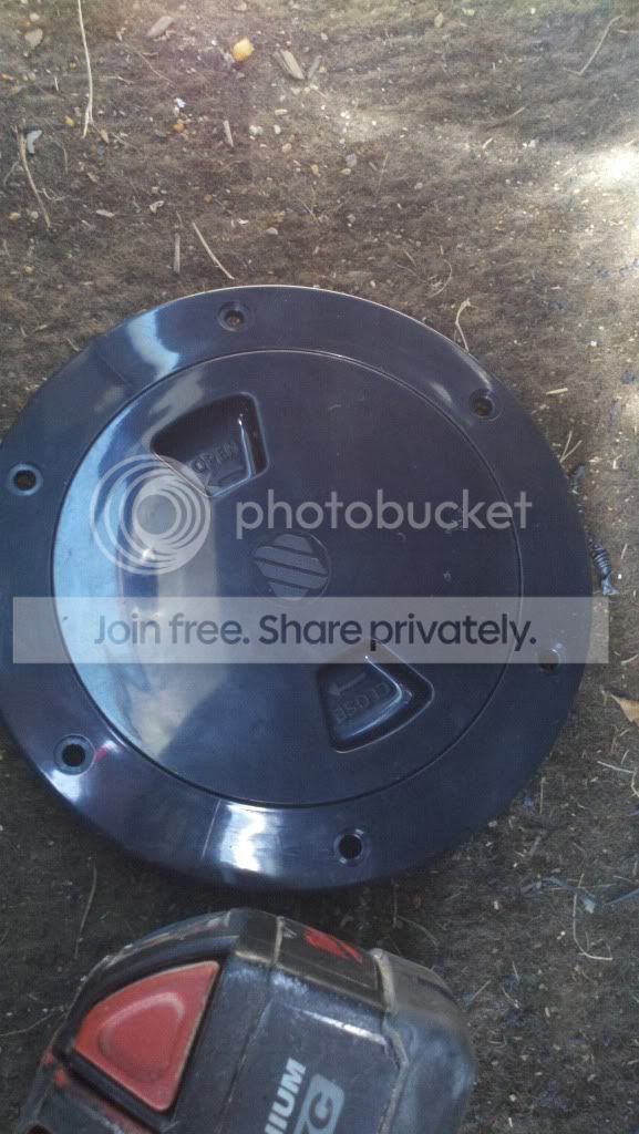

And here's a cool mod I read about on DTR, the heater core tends to fill up with leaves and junk and kills the air flow through the heater core so yesterday I cut a hole in the heater core box inside the cab. Then I cleaned and shop vaced out all the **** I found in there and they used a marine deckplate to seal up the hole, turned out pretty good I think.
I forgot to take pics of the finished product but I'll get some up at some point.
I know if not a chevy but I think it looks pretty good and has all the parts we try and put in our chevy's, let me know what you think.
Good idea!!!! That would work good i think as a cover above the fuel pump in my Burb!!

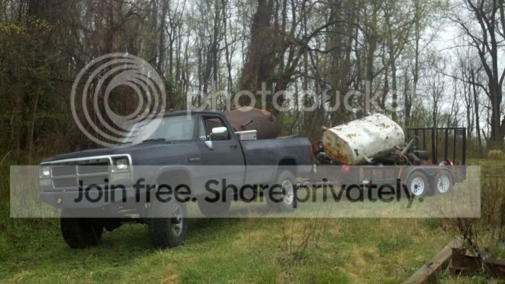

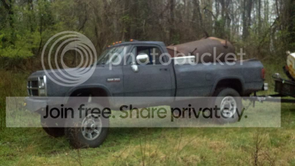

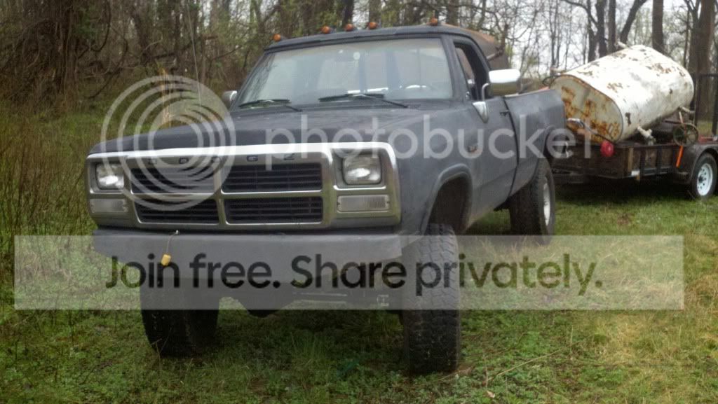

The truck has been running good, I sold my work cap and have been running it with just a truck box and the cab packed full of tools. I also got the bumper most of the way built and going it all in primer. Anyway here are a few pics of the old beast doing what it was made to do-- Work.
