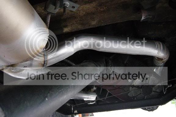

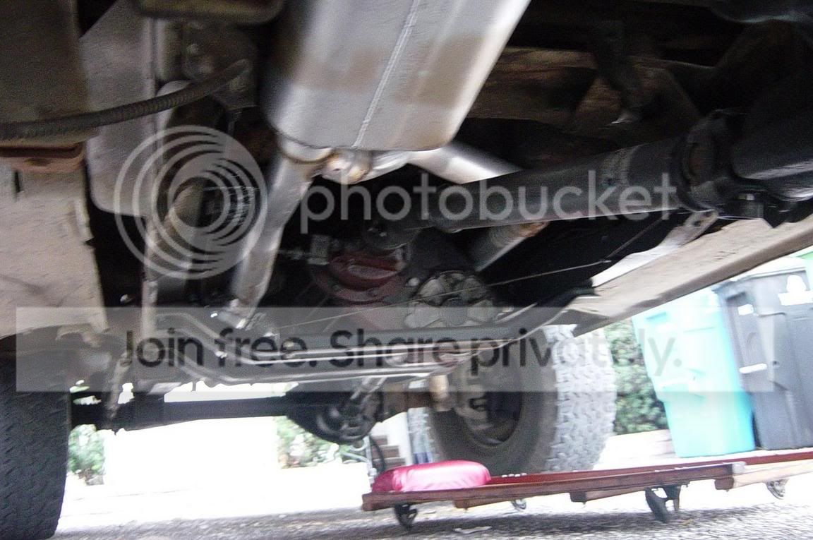

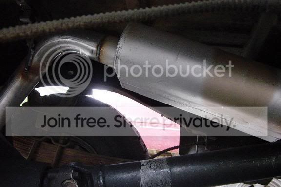

I put thorleys on my '73 and had an exhaust shop make me a custom crossover that crosses behind the transfer case, up over the driveshaft. You can't really tell from the photos, but there is plenty of clearance, it will neve hit, no matter how far the rear end bottoms. I did dual 2 1/2" back to a 3" y with a Flowmaster 50. I am smog exempt, so I don't run a Cat, and it's too loud inside the cab for my taste, but the exhaust routing sure is sweet!
Nice.:thumb: I can see in the pic from the rear that you have plenty of clearance.

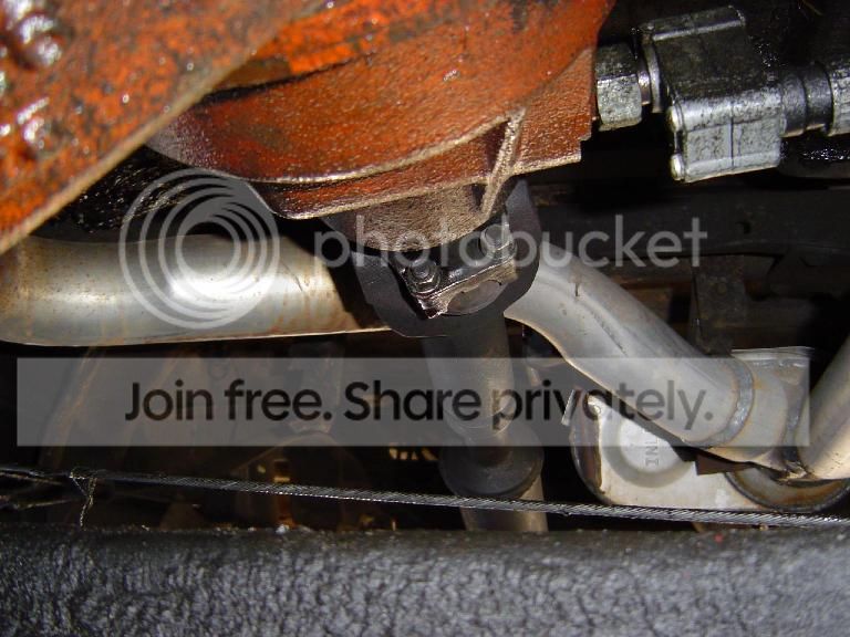

I have an 89 K5 with a set of Doug thorley try y headers that came with the stock height y pipe but the mufler shop bent it to clear the front drive shaft and it has no problem with clearance. It sounds awsome. :k5:

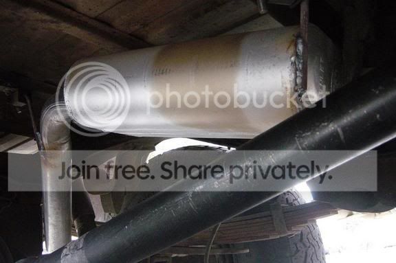

My flowmaster 50 is a pretty long muffler, I think a 40 is shorter. My exhaust dumps right behind the rear axle, so there actually is a bit more room available to try to fit a cat in if you want to dump farther back and use a shorter muffler.
