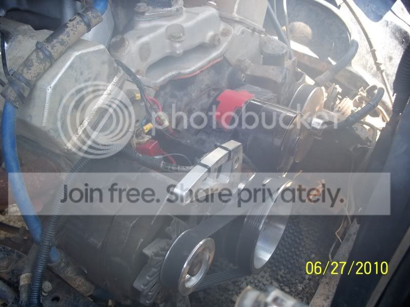

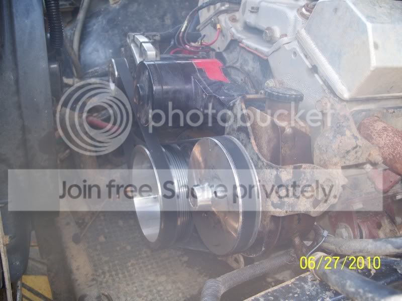

finally got around to installing a set of serpentine pulleys my sponser hooked me up with.
the crank pulley is only about 1" smaller in diameter, and the alt. and power steering are about the same size. these are 6 groove pulleys but i could only find a 6 groove belt for the alt so far, i have a 5 groove belt on the pump.
i'll try these out this coming weekend and see if it's any better. if not, i'll try to find a smaller crank pulley yet. the v-belt pulley i had on there was over 7" in dia.

well, they stayed on for 6 passes thru the pit. the truck didn;t have to really dig in this weeks mud though.
the belt on the power steering pulley did start to try and come off, it has one rib off the edge of the pulley.
this sunday is another bog, and it's longer so we'll see how it works. i think there is too much drag from the hydroboost and it creates slack for it to crawl off the pulley.
