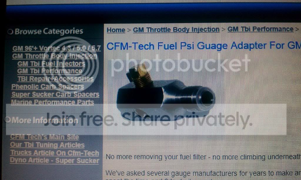

Also get this
With the gauge, however I might try to re-route (just the gauge) elsewhere to avoid more mods with lines, brackets etc... Has anybody done this?????

eh, I've always found it to be a valuable bit of info at a glance, a bit excessive maybe...
came in handy today actually when I was running on fumes and it went from my usual 14 and change psi, to fluttering at 12... apparently my rig likes to have more than .2 gallons in it! :doah: :whistle: :haha:
but I've also been informed it's pointless too... :rolleyes:
