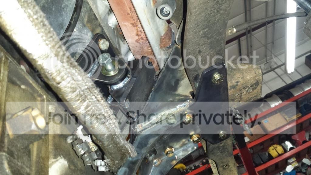

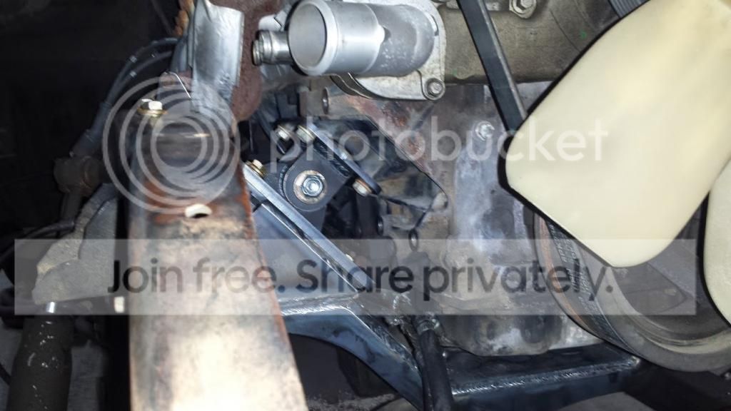

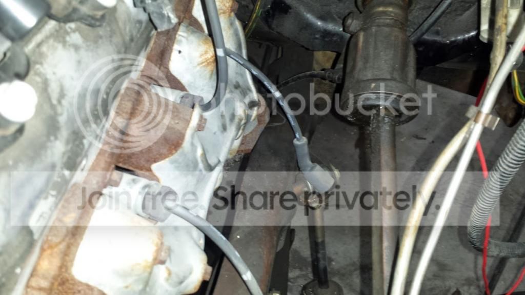

Exhaust manifolds had to have the frame clearanced just a bit and we also clearanced the frame where the EGR block-off plate was installed. Other than that, and the removal of the AC compressor, things fit nicely. These trucks fit around an LS like they were made for it!
The sharpie lines in this pic are where the frame needed to be clearanced on the passenger side:
The sharpie line at the back in this pic shows where we clearanced for the driver's side exhaust:

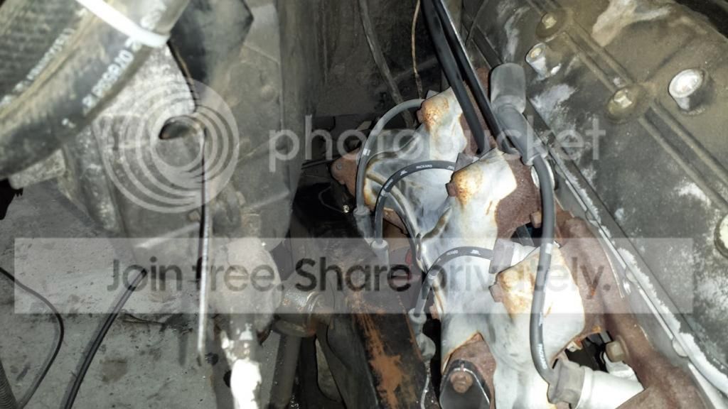

Driver's Side from above:
Passenger's Side from above:

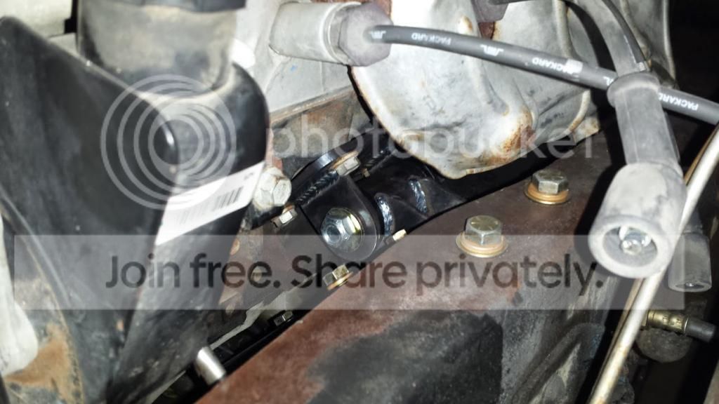

This is what they look like from underneath (Passenger's Side) mounted to my HD Engine Crossmember:

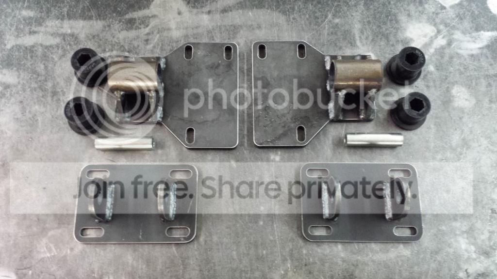

...and finally, here is what the "set" looks like on it's own:
