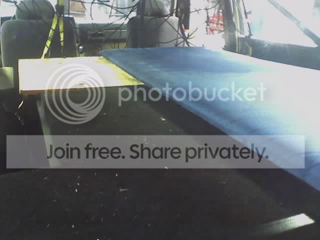

I carry lots o shiot.... tools, spares, I also have and ignition module, dist rotor, fuel pump, brake hoses, about 14 ujoints, cordless impact, a sleeping mat and sleeping bag ( I spent the night on schoolbus at tellico in a hailstorm with no doors or top... that sucked. )
