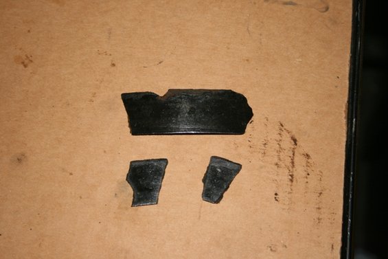

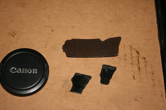

Well, I finally was able to drop the pan and inspect. The fluid was not burnt smelling or black/dark. I wasn't pink either (a little darker - toward red). The filter seemed loose but the bolt was tight. There were two small pieces of material (see pics) in the pan and one larger piece in the filter. They are flexable, yet stiff. They are black on one side and brick red on the other and look similar to gasket material. I am guessing a rebuild is in my future.
Looks like that could be old pan gasket material? My old transmission did the same thing, Tranny guy said that the seal for the 1st/reverse clutch pack was getting hard, so fluid would go past it eventually heat the seal up enough to swell it and it will go into gear. You can try some seal swelling stuff to get you by, But that causes another problem of the seals dont know when to stop swelling
