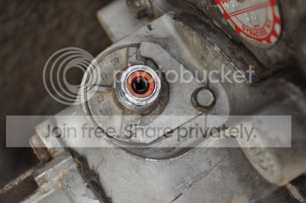

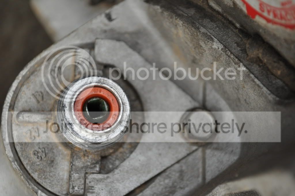

I called the tranny shop and asked him about the bouncing speedo as possibly contributing to the transmission shifting around. He said it could be possible that the gear for the speedo within the transfer case was worn.
So, I disconnected the cable and put it on a drill. Everything from the cable forward to the speedometer was smooth pointing to the transfer case gear as being worn.
I think I'm going to change this out and see if that helps. How do I go about removing this and will t-case oil drain out if I remove this cap? I was thinking to first remove the bolt and then maybe use some pliers to turn the large cap (is this threaded into the case??)
thanks for any tips. As an fyi though, the tranny guy was concerned that if it didn't fix it, I am putting the tranny in jeopardy so I do need to fix this issue.
It's easier than you think. The whole gear housing just slips in there on an O-ring. Remove the retainer bracket and give the housing a little twist/pull and it will pop right out. Easy to do on the truck. A little fluid may come out, but it's no big deal. Top off when you're done.

Thanks for the tip. Sounds pretty easy to remove/install.
Glad to hear that the ECU only controls the torque converter as it feels like it's just the converter going in and out. Shifting from OD to D.....still same converter reaction.
I parked it today and will try and find a new gear here locally. If not, may need to order online somewhere.
