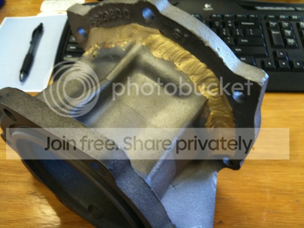

I had my friend in Denver send me the adapter via UPS and as I unpackaged it and threw it into the media blasting cabinet, this is what I found...
The crack goes all the way around the top half of the transfer case side mating surface. It was completely "fixed" with the bronze brazing, but as I understand it, bronze brazing is not a structural weld so this adapter is pretty much worthless...is that correct? The adapter is perfectly square and in fine shape for mock-up use, but I can't really use this one for any sort of actual "in-vehicle duty" can I???
thats a nice paper weight you got there. :sign5:
hope you get the specs you need and get a refund on that pile of crap. :poo:
yes braze is not as strong.
