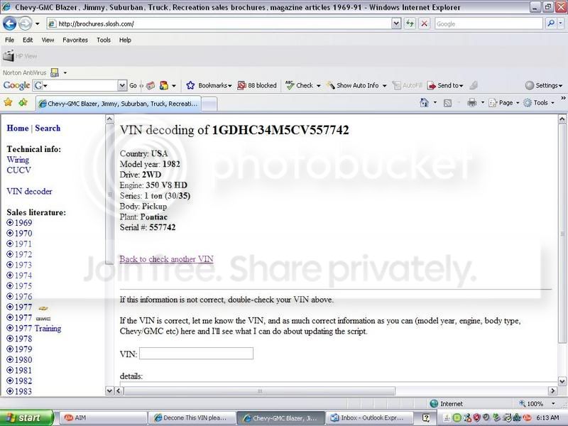

I did a vin search on the cab I got. I was having some problems at first, when I was using a regular decoder, from LMC trucks, and it was going good, for the first to characters, but the there wasn`t anything for the third character, which is D. So I used the decoder on slosh, and this is what I got:

Heres what I came up with.DECODED1982 GMC C3500CountryUNITED STATESMakeGMCVehicle TypePickup TruckGVWR ClassClass H: 9,001-10,000 lbModelC3500Body Type2 Door Cab; RegularEngine TypeV8, 5.7L (350 CID)Check Digit5Model Year1982Assy. PlantProduction Seq. Number557742Brake SystemHydraulicTrim LevelBaseDrive Line TypeRWDSeries1 tonVehicle ClassFull-size PickupFuel TypeGasolineManufacturerGeneral Motors Corporation
I should know, as I wrote that decoder... but I can't remember where the info came from. Prolly the GM manual, so I'm gonna suspect that what it means it's a 4BBL with "heavy duty" emissions, i.e. a higher GVWR meant they could get away without an AIR pump or something.
