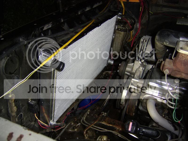

yes. i have a mark VII fan. people say they are bad a$$ (we'll see). it fits perfect top to bottom. problem is it leaves about 2" in each side of the core un-shrouded. its an 18" fan. hopefully it can cool my big block. what do you guys think?
Most likely it will be fine. How much space will there be to the engine once the fan is there? What doesthe Mark iv fan look like?
im gonna have to trim the shroud a little because it hits but after that i'll have about half an inch. it looks like this. also came in taurse

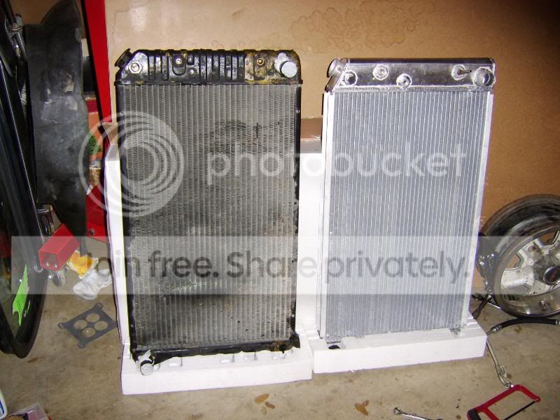

I bought my alum rad locally last year for $220 was about $15 more then the reg 4core.
that radiator is big! i wish i had that one. good deal too. where did you get it? if this summit one cant cut it im gonna need to find one like that.

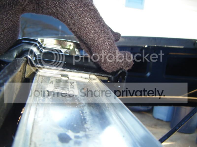

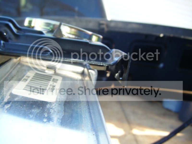

Looks like I am looking for another method. Just wish there was a way to do it that wouldn`t be so time consuming. Here`s the issue I`m having now.
I think the lower lip of the rad support may be bent down, but I`m not 100% sure....Anywho...
Here`s how it sits with the mount flat on the top of the rad support,
and if i push the front down
Maybe I do need some of your mounts :crazy:
The way I have it now, the driversside mount barely reaches the radiator
nek5 you might be able to make that work. hold the bracket flat then almost fill most of the gap on the front of the bracket with a washer or two leaving enough of a gap that when you tighten down the bolts it will clamp down tight and flat. hard to explain but do you see what im saying.
