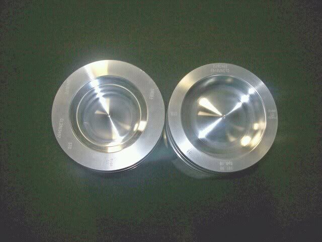

be aware of the piston bowl and injector injection angle. it is very very easy to melt a piston in an 05-06 cummins. even bone stock.
The left side is an 03-04 engine. the right is an 05-06 NON re-entrant style design combustion chamber. the is very very little material between the radius of the bowl and the top ring land.
its no surprise they went back to the earlier style re-entrant pistons in the 6.7L. same as the proven reliable 12v, 24v, early HPCRs.
