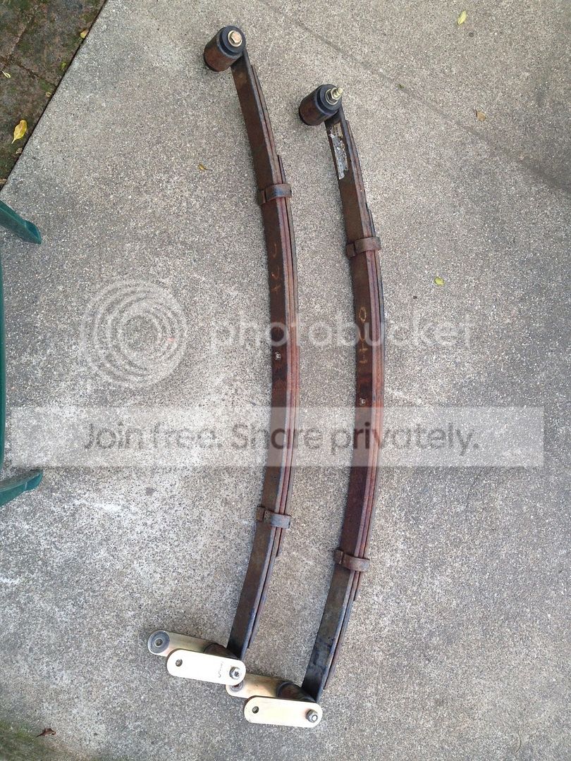

Thanks for all the tips guys. In the pictures, it's a little hard to tell with the bolts and shackles but they look like they're laying pretty flat on the ground. It'd be around 2.5 hours one way to see them in person though and I'm not sure if I want to make that trip on a dice roll...

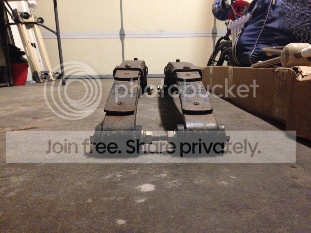

set them both upside down and have them humped up side by side . if no notable hight difference like 1 sagged out run them .
The pictures make it look like he simply unbolted them from his truck. That implies the corrosion isn't too bad. No reason to be too suspicious as long as the inspection is fine. All you have to do is change your mind on height or axle placement and end up with a good used set of springs. Many of us have taken off springs just like that to bolt on some ORD packs. A tweaked spring is more likely than a cracked one, but look closely for cracks around the U-bolt area.
I sent the guy an email through CL last night asking for some more info and pictures of them arches up to make sure they aren't tweaked. He said they probably only have a few thousand miles on them since they were on his camping truck that spent most of it's time in the driveway. He's going to try and get the pictures later today and assuming they look good (no cracks/aren't tweaked) they may be well worth the trip out there.

So the guy just sent me some better pictures and they look good to me.
No cracks by the u-bolts, they're the same height side by side, and don't have anything else that I can think of that might be wrong. Looks like I'll be making a trip to the bay area this weekend lol.
