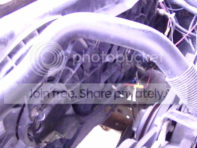

I did the mod to alleviate that additional stress on the engine with the idea that without the mechanical fan blades, it will free up more HP (minimal). I also did it for enhanced cooling. And so I can control the fans if I go through deep water, I can turn them off.
I did remove my mechanical fan.
This pic is when I initially installed it. The wiring has since been cleaned up and routed cleaner.
