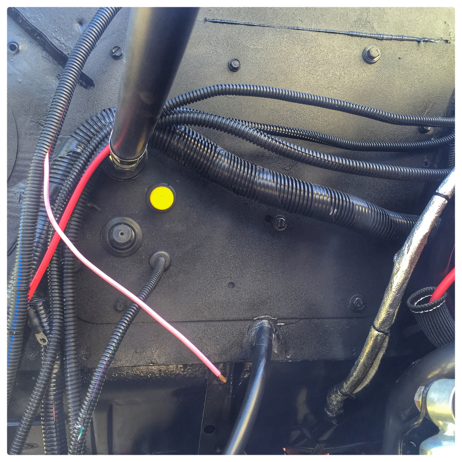

Some more of the firewall. The control unit under the dash, the template and block off panel, the pre made lines. All perfect fits. Nice and easy.

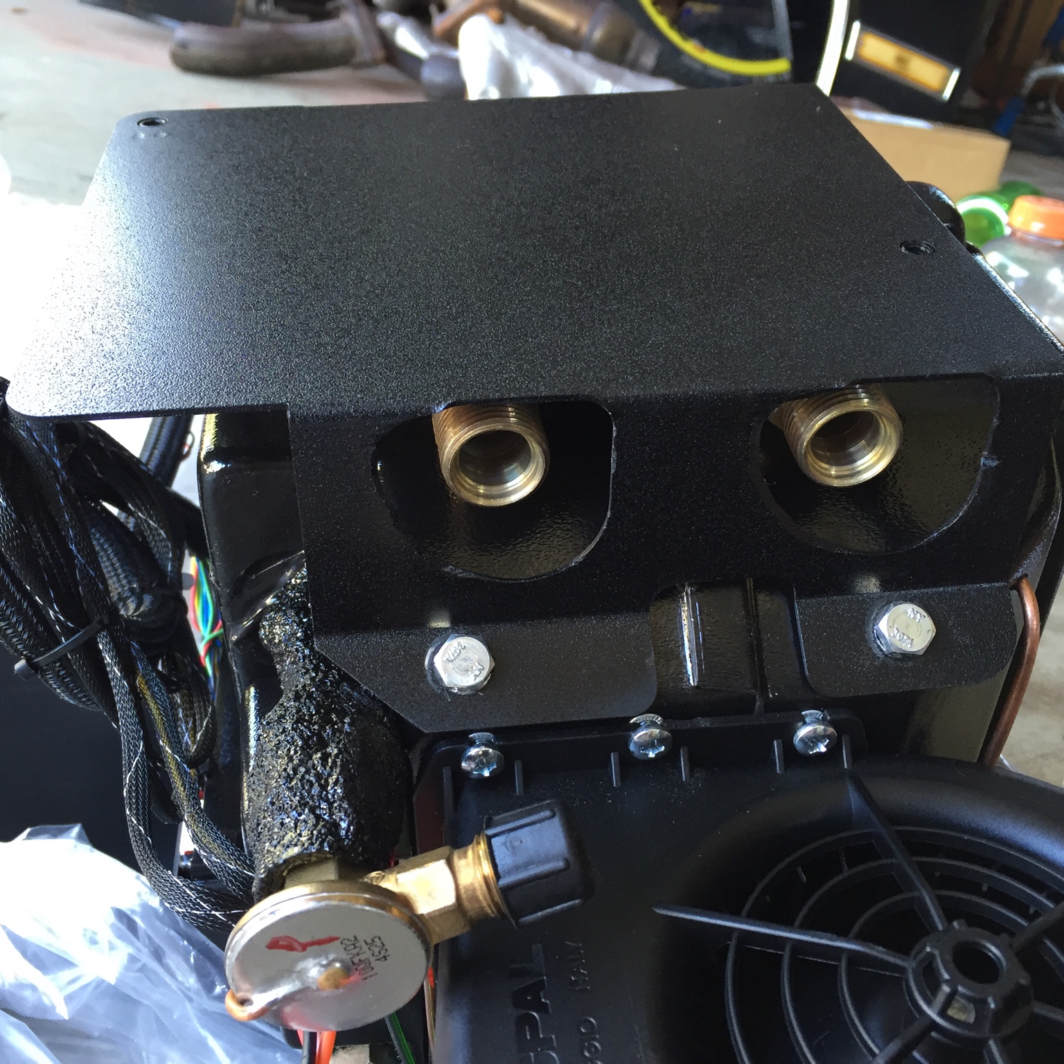

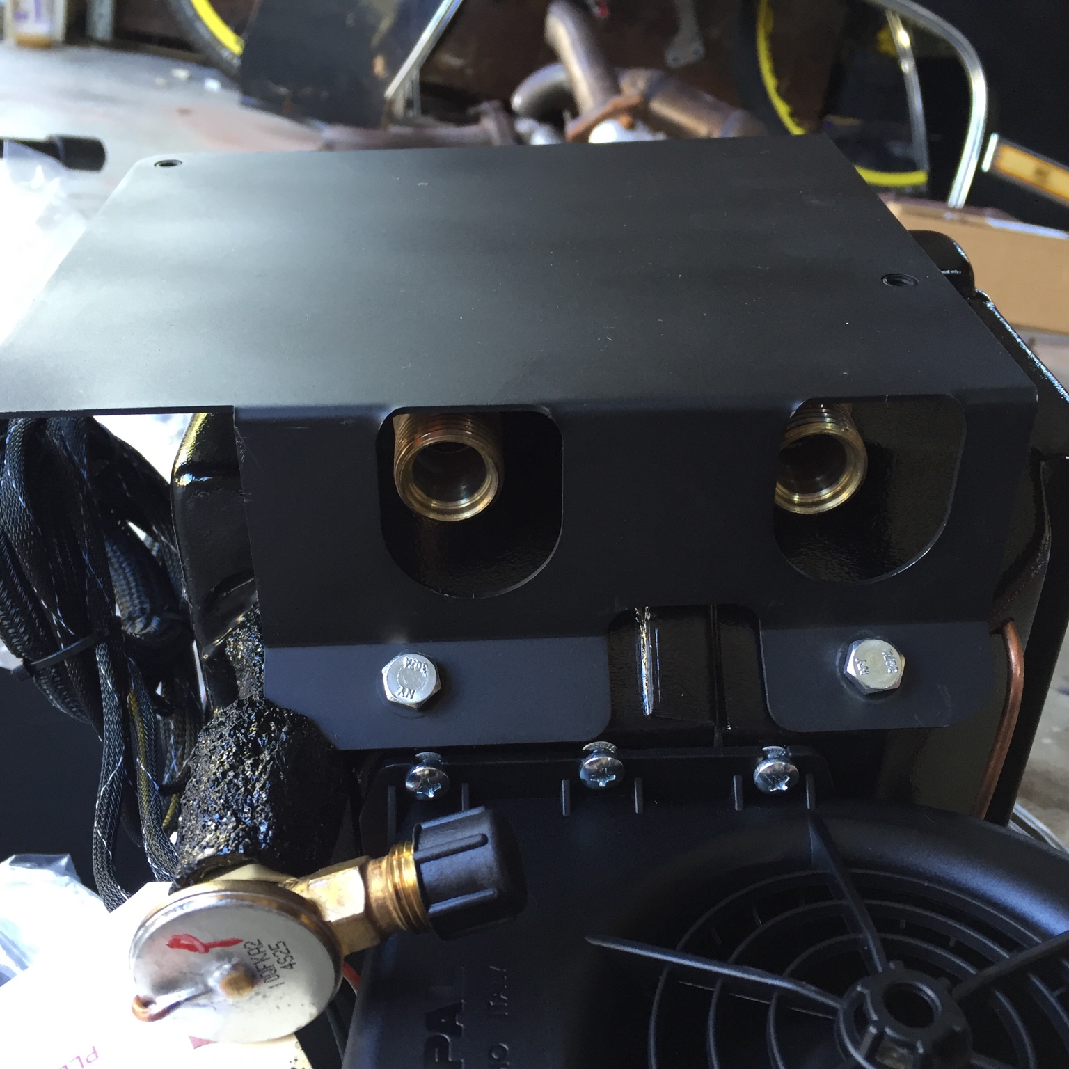

Here is the main issue I had. The control unit under the dash uses two plates to mount it. There is no way to the best of my knowledge that you can install this wrong. Problem is the heater lines and pressure line interfere with the bracket. You cannot connect the heater lines the way the bracket is, and the bracket severely pushes on the pressure line. See below:
you can see here the bracket pushing into the insulation on the pressure line and also that the heater lines are no way near lined up.

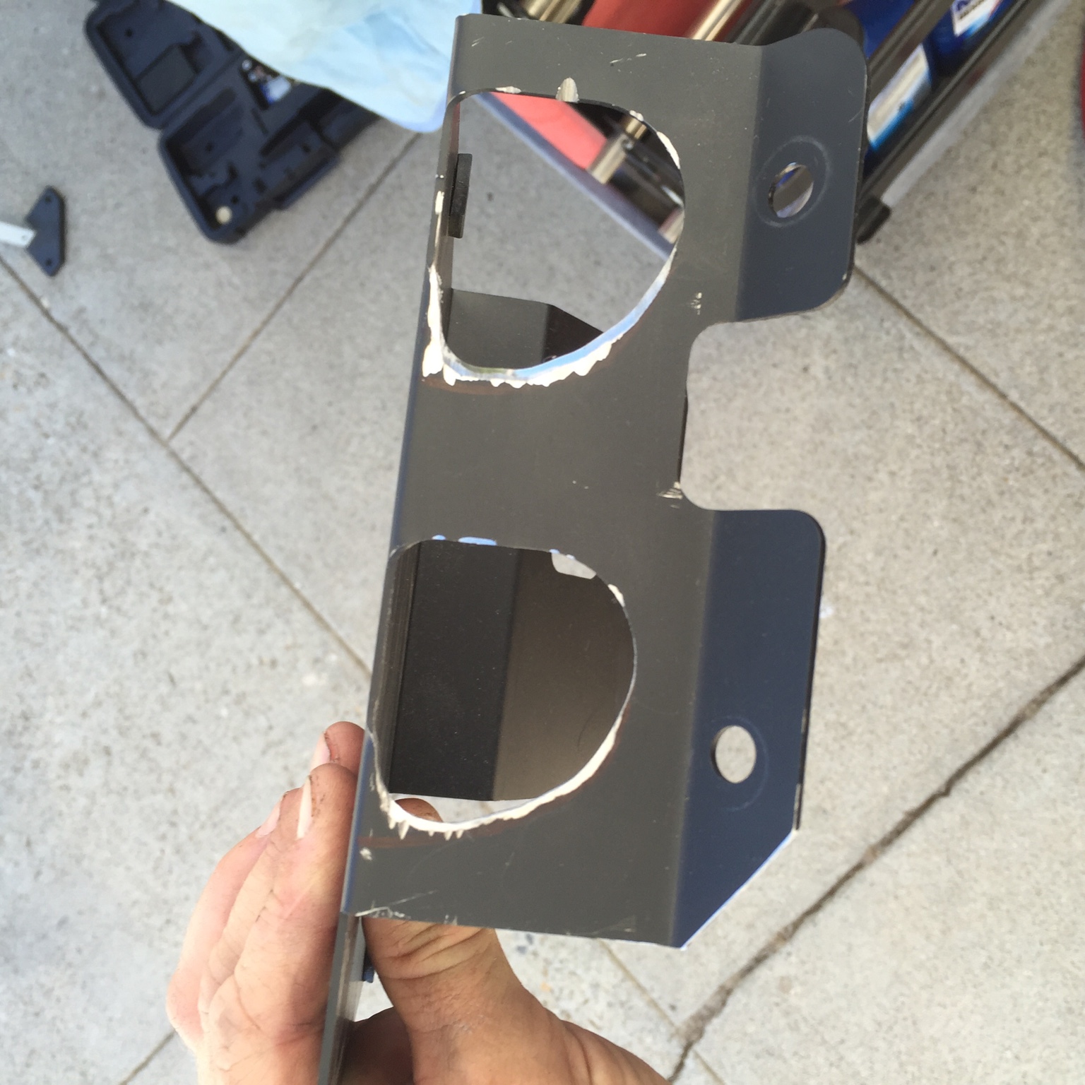

Not that big of a deal, considering the quality of everything else it was just a little surprising.
the results of my surgery.

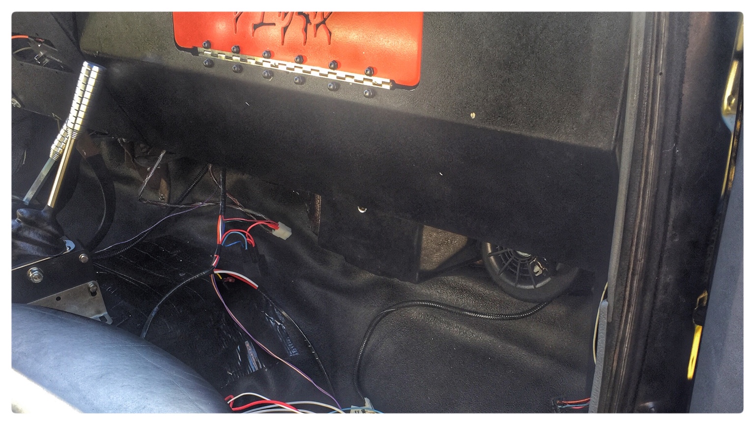

getting the unit bolted up and mounted is a two person job or prepare for some frustration. I removed my windshield a long time ago for the cage install, so that made one of the bolts a lot easier, but still two people are really needed.
Unit fits under the DIY4X dash although I did need to remove half of the dash to get the unit in and then put the dash back in. Don't think that will be needed with stock dash.
