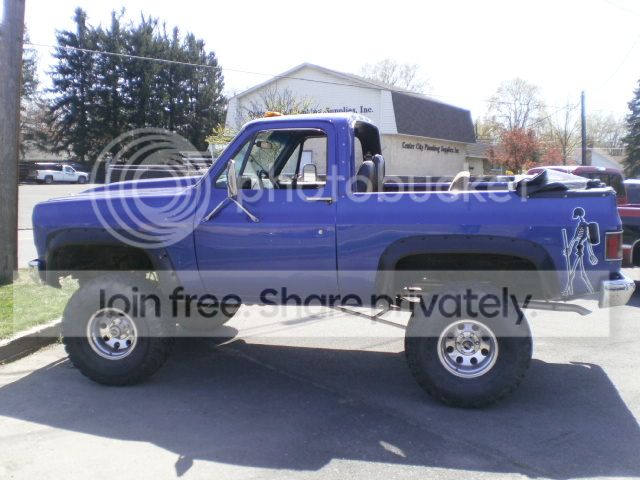

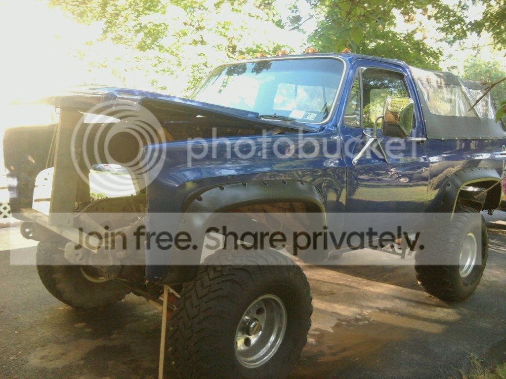

Alright guys i finally decided to dive into this k5. Heres the short story, i bought it for 3200 a month or two ago and heres what it looked like when i got it!
Heres some specs:
-400 small block engine (spun bearing)
-Turbo 350

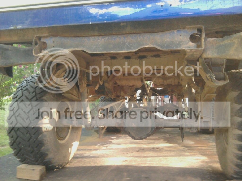

-Stock 10 bolts with 4.11s
-8" suspension lift with blocks in the rear
-ladder bars
-36/16.5/15 Dick Cepek Tires
-Bestop Softtop

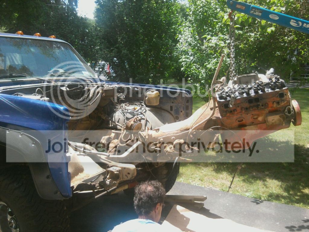

So i got it and drove it around for a week or so and it was burning oil and started making squealing noises that weren't pleasant, so i decided to pull the engine, rebuild it and go from there.

- 14 bolt rear with probably a d44 heavy duty up front, unless i find a d60 for cheap.
- Finish the interior, new seats, panels and dash (thinking the diy4x aluminum one, or i will make a custom one that is very simple)
-Bend a roll cage, want this mostly for looks and for something to grab on to pull myself into the cab
-Get rid of blocks in the suspension lift in favor of a shackle flip

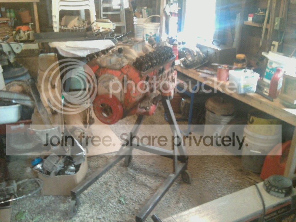

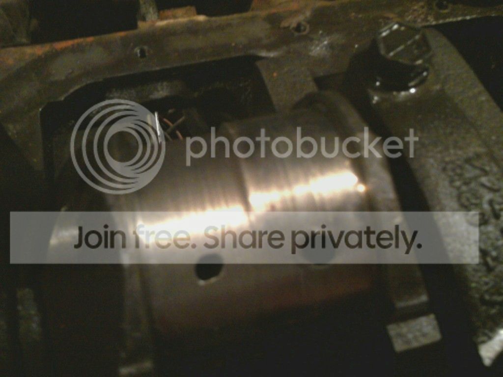

Dug into the engine, but had to stop before i could remove the crank because i dont have a puller to remove the balancer on the front. Found my problem, spun the rod bearing for connecting rod #1, it completely destroyed the crank, im amazed at how much material it took off. Need to finish disassembling and see what kind of shape the block is in. hopefully it is alright.

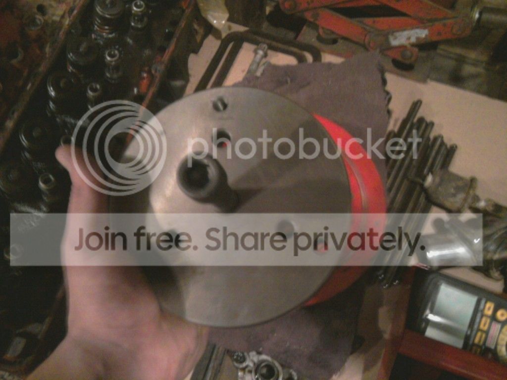

Alright, got stuck for a day on the harmonic balancer. So had to make myself a puller:
But i got it off and decided to stop for the night. Anyway, here are the pictures from the other night, the 1st and 2nd rod journal on the crank is completely destroyed. there has got to be about .125" of material worn away. Metal chips everywhere. But when i pulled the engine it still ran and drove. It amazes me, the piston had so much slop in it. Heres a crappy cell phone picture:

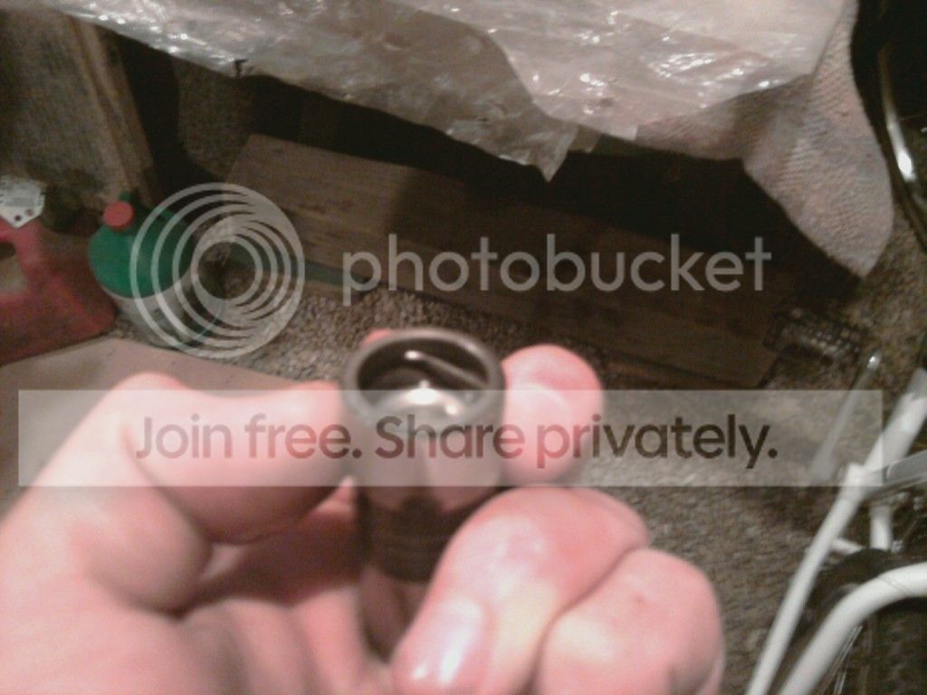

And here is another problem no oil pressure will give ya:
i will remove the timing, crank and cam. Im going to measure the cam and assess if i will buy a new one. Other than tha, engine build is going to be halted and i will move onto the interior.

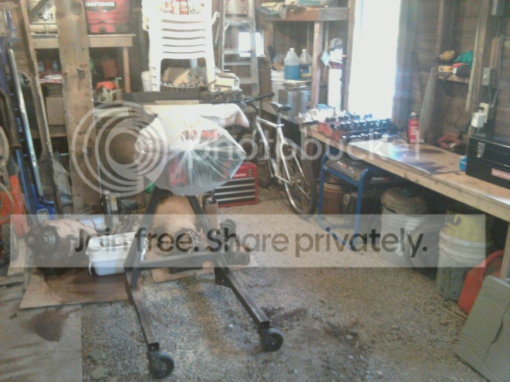

i brought the block to a car wash and thoroughly pressure washed it, i knocked out all the plugs and got all the water jackets and oil galleys. Put her in a bag and she will sit for a while.

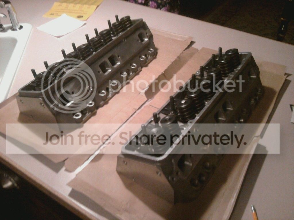

Okay, so i found a heck of a deal on some aluminum heads. They have all new springs, retainers, seals, the whole deal. They were ported and polished, and have never been run. Found them on craigslist and talked the guy down to 400 bucks! I couldnt believe it. i would have had to put that much into machining and new springs on the old cast heads. It will slow down my engine build by a couple weeks because i gotta save up money hah but in the end this thing is going to really talk!

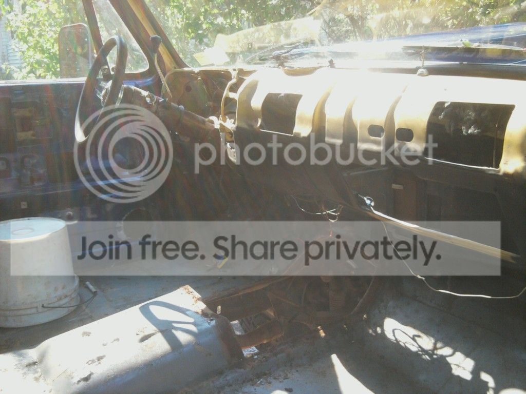

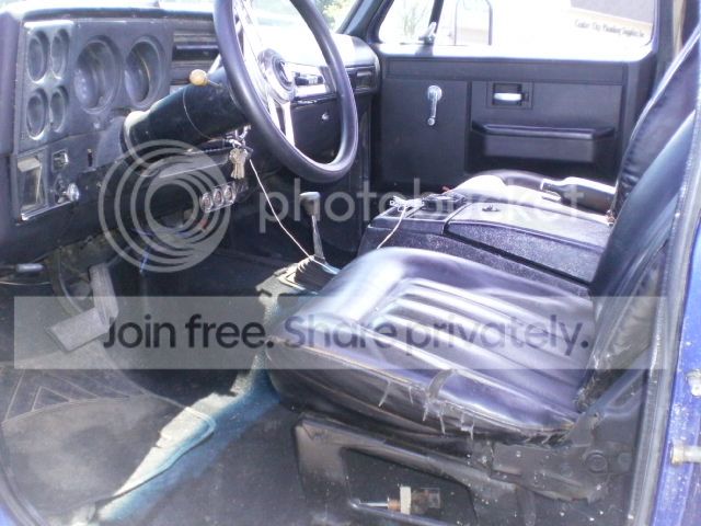

Okay, well i decided to go ahead and start working on the interior and save the engine for the winter since i can work on that indoors. This morning i gutted the whole inside of the truck:
Like my drivers seat? haha

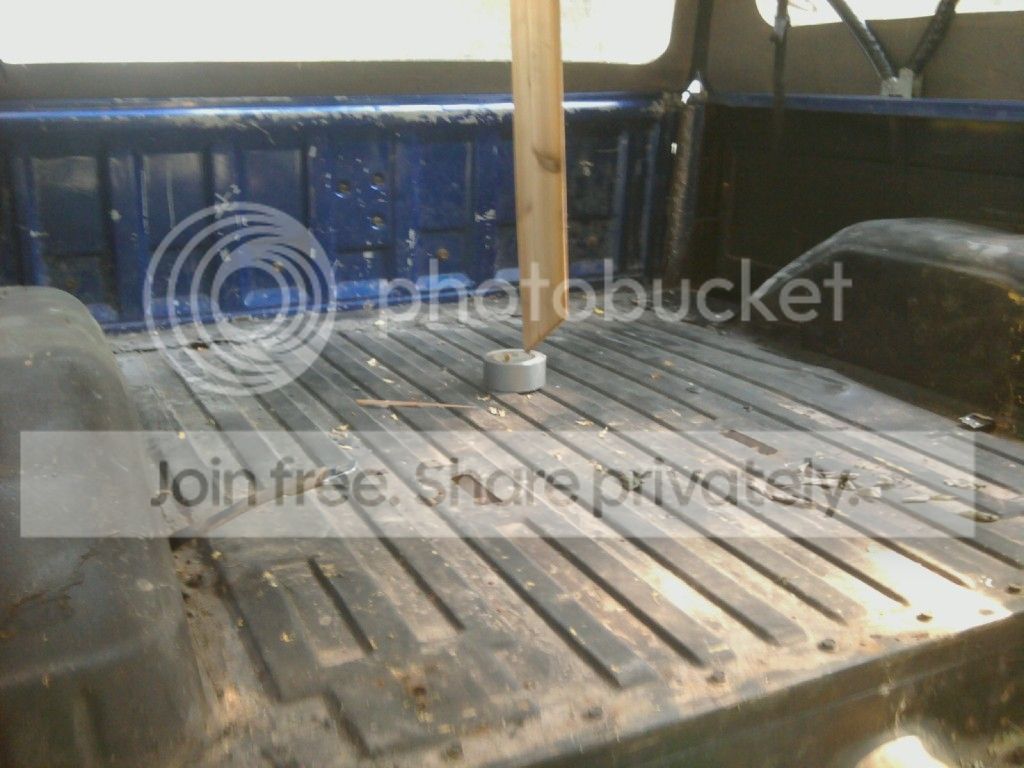

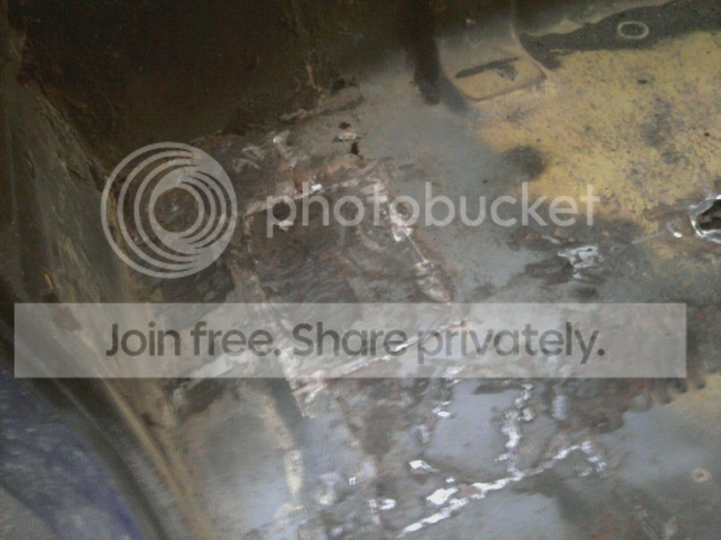

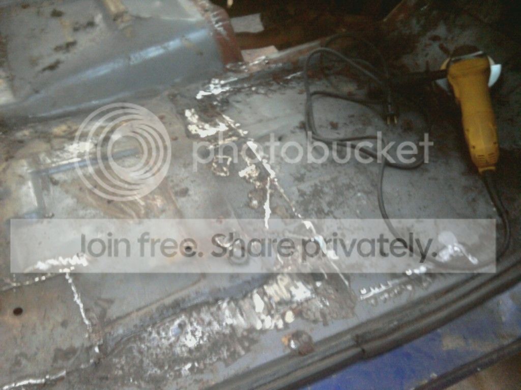

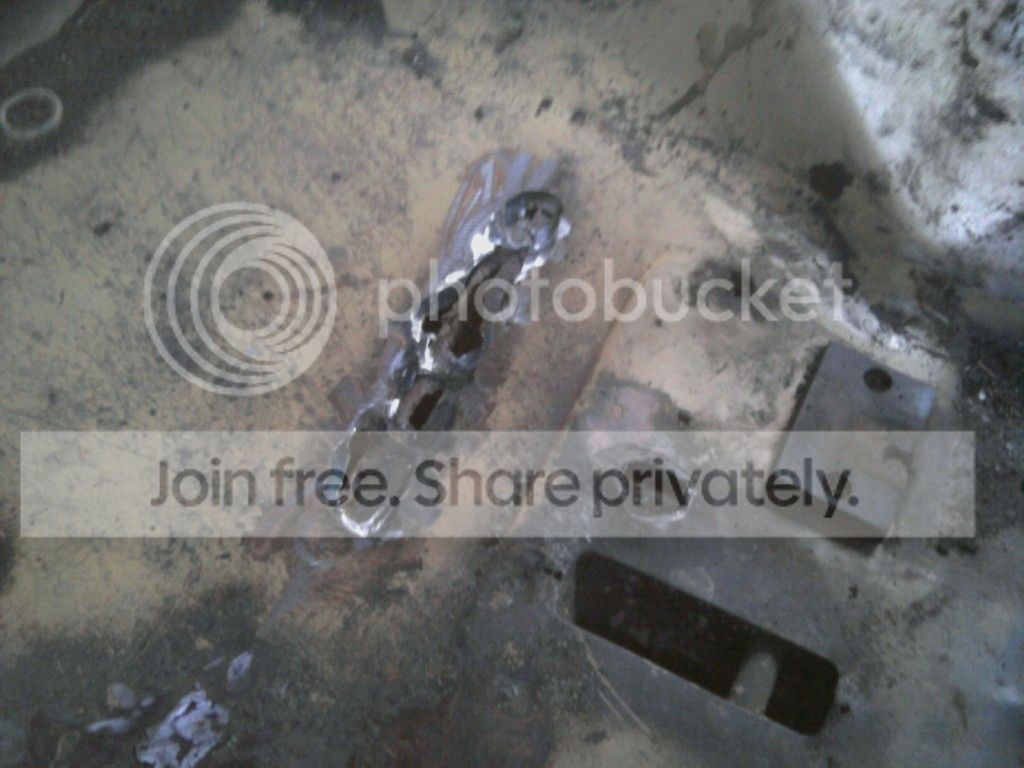

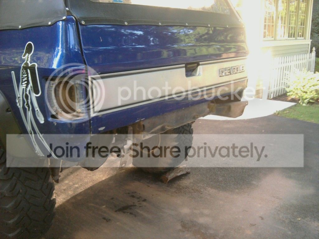

Alright heres a quick update, havent touched her in a few days but tonight i decided i wasnt gonna skimp on this paint job so i started grinding some of the rough welds the PO did, and as i did that i found some bondo spots on the floor which uncovered some holes, i got about half the front of the truck done so im gonna vacuum up my mess tomorrow and try to finish the grinding up tomorrow and then move on to the patching stage. Im just diggin myself into a deeper hole, haha gotta love it! But i couldnt stand having bondo on the floor. Not a fan.
Edit: what looks like rust in the first picture is just dirt and grindings

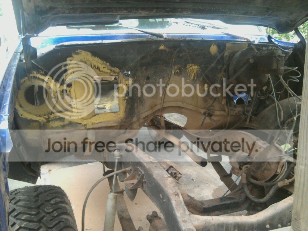

Okay so i finally got a little more work done on the k5, i removed the steering column and shaft and i ordered some sheet metal to do some light patching in the cab. I also picked up some cut off wheels for the angle grinder and am going to be cutting away the dash in order to prep for painting. It was getting dark so picture isnt that great, but slowly making progress...

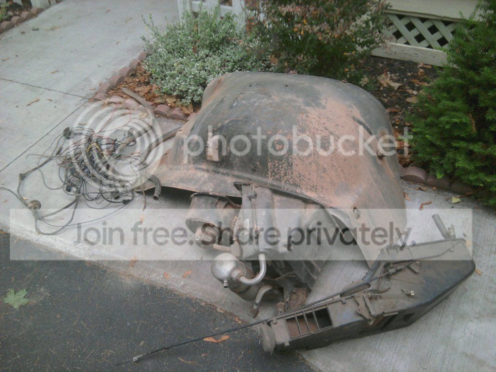

Got some more done today, cut the dash skeleton out, removed hvac system and tons of wires. Started scraping the firewall in order to get ready for some patching. Going to be installing an aftermarket heater so no need for any of the big holes. From here i will continue to clean everything up and wire wheel it, until i am ready to start welding. Lots of mud caked on everything so lots of cleaning, and i will probably remove the hood and fenders shortly.
Got a little more done before it started raining again. All thats left up front is the brake booster and master cylinder. I will probably take all the brake lines off too, as i will be running new lines that are corrosion resistant.

I wouldnt worry about the block too much, I bought a 2000 roller cam 454 from an auction for 300$ and it spun number 1 as well, did about that much damage to the crank. I was able to reuse all the connecting rods and pistons, even the cam too. I just had to shave all the rods down and re-balance them and I bought a Scat lightweight crank then it was all good. Having damaged lifters like that i would just recommend buying a new cam with lifters, they can be had for around 125$. I was going to do the same on mine till i seen the 350$ plus for the roller cams... not so much.
Yea i already have a plan layed out for the engine that i will be putting into motion over the winter, since i can work on that indoors. Im going to bore it .020 over and get a rotating assembly kit by scat with crank, rods, pistons, etc. Then i also have a cam and lifter kit picked out from comp cams, and i have aluminum heads pictured above with all new comp cams valve train.
