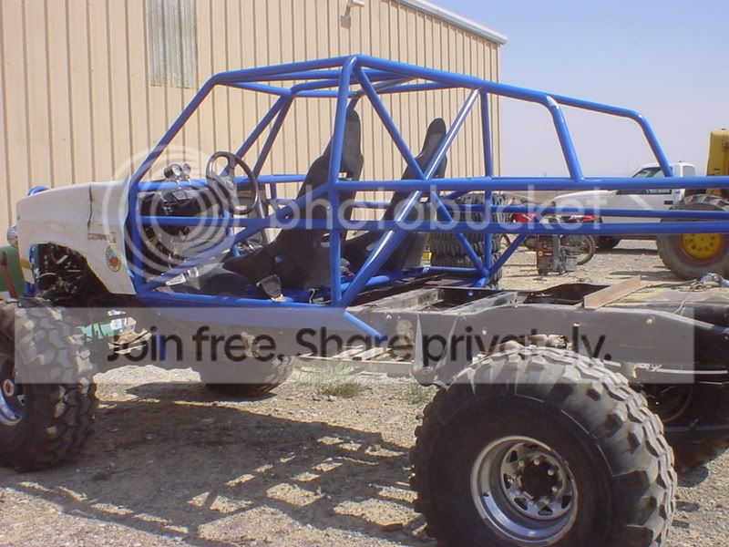

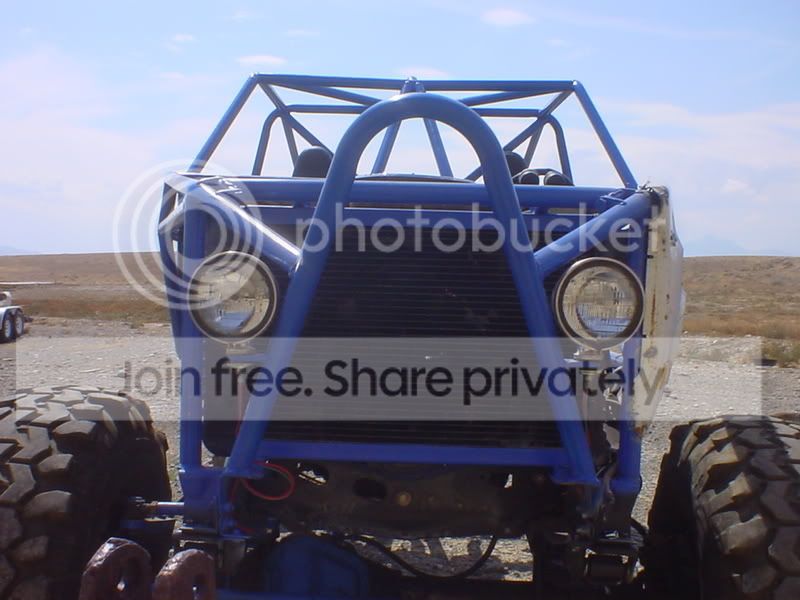

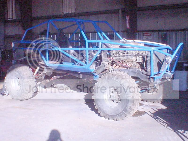

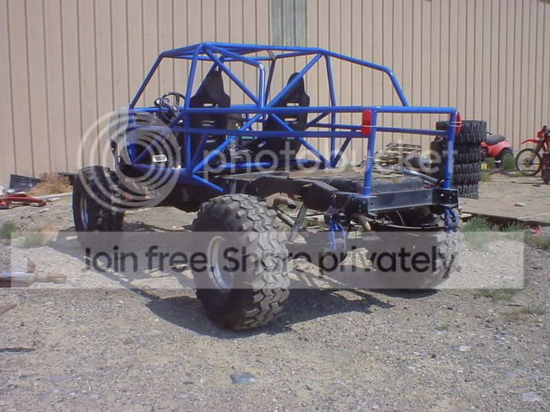

shortbox truck frame with weld on and bolt on frame brace. 180 feet of 1.75" .120 wall HREW. Changed mind to 4 link rear so didn't completely finish rear since was gonna cut off everything past B pillar and re-do.
another sot without fender and not as much tube done yet
