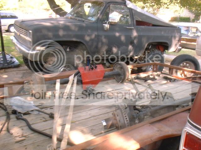

Blazer hasn't moved since May 24th. Since then ive been gathering parts.

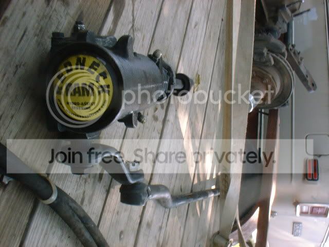

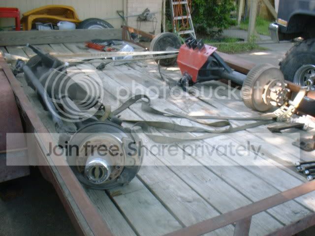

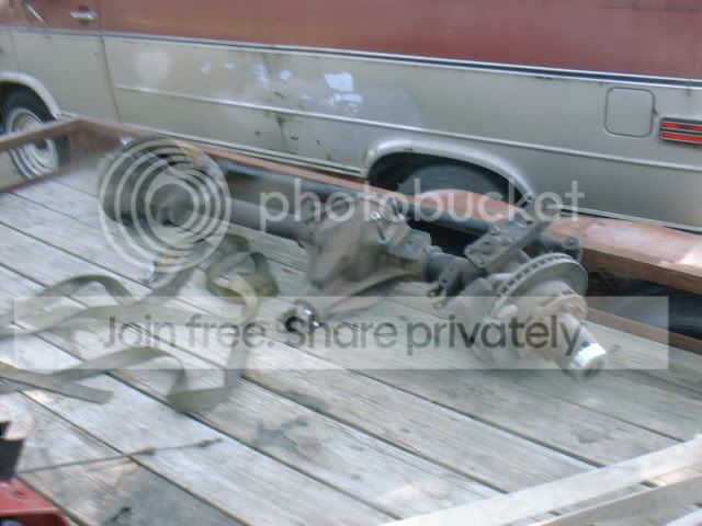

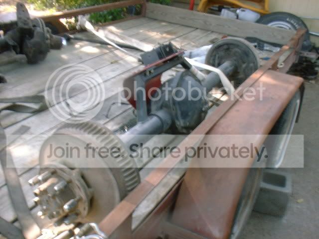

Ive bought d60 and van 14b. f/r detroit, 4.56 gears, 35spline outers(1 chromo), ORD crossover, Warn premium hubs, WTO rebuilt and ported 2wd box, Lion 2"x8" hydro assist ram, 1410 yokes.
I have 1.75"x8" PSC hydro assist ram, 15x10 2.5" backspacing rims, 2 1410 spicer joints, all new ubolts, DIY4x 14b spring perches and spring plates, and th350 tranny to replace my blown one.
I still need 2 new fittings on the hydro lines, hardlines for 14b, pick up tranny and install, Then i need a rear shaft built...
Check my custom top!:haha:

Im gonna drag the trailer to Orilleys and buy straight hardline. they should have them with the screw ends already on them and ready to just be bent and installed. So im gonna take the axle by, and get the right size thread and lengths, that way i dont have to do any flares :D

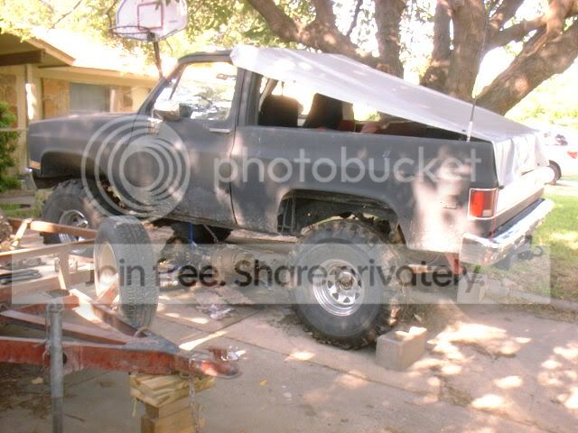

Here is my blazer as it sits now she is plain jane but rust free except for the hood which is being replaced as soon as I find the $$$$. I got a deal on the tires on there now they are coming off as they are on ebay right now.
