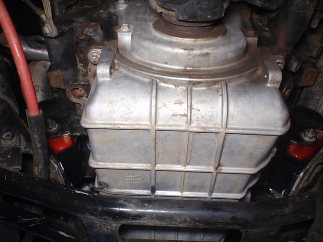

here's a pic...
3 bolts on the bottom, 2 facing front to back, and 1 more on the inside of the engine tower...you need to drill the holes, that's all there is to it...:waytogo:
# of bolts is per side....

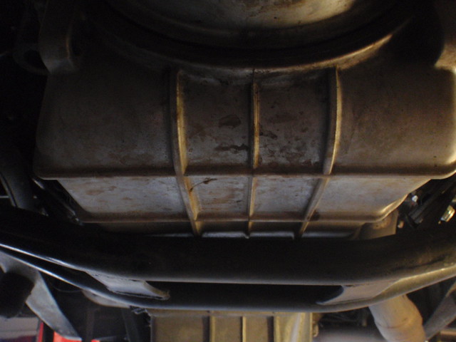

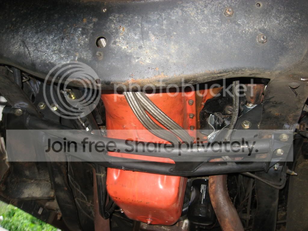

I am with 6873xtc on the solid engine mount inquiry. Stock mounts, especially the horrible replacement types from any part store are just horrible, but I found the Energy Suspension mounts to be the perfect balance between flex and durability without the engine feeling like it is hard mounted to the frame like solid mounts. In other words, I don’t feel any engine vibration but at least these Energy mounts haven’t failed yet. See those scars on my 8.1L oil pan? Those are from cheap Napa mounts failing causing the pan to kiss the ORD xmember….Not just one set of Napa mounts failed, but two sets. The third time I replaced them I went with Energy inserts.
Pan laying on the ORD xmember after the Napa mounts caved in
Crap Napa mount on the right. The 8.1L ate two sets :haha:
