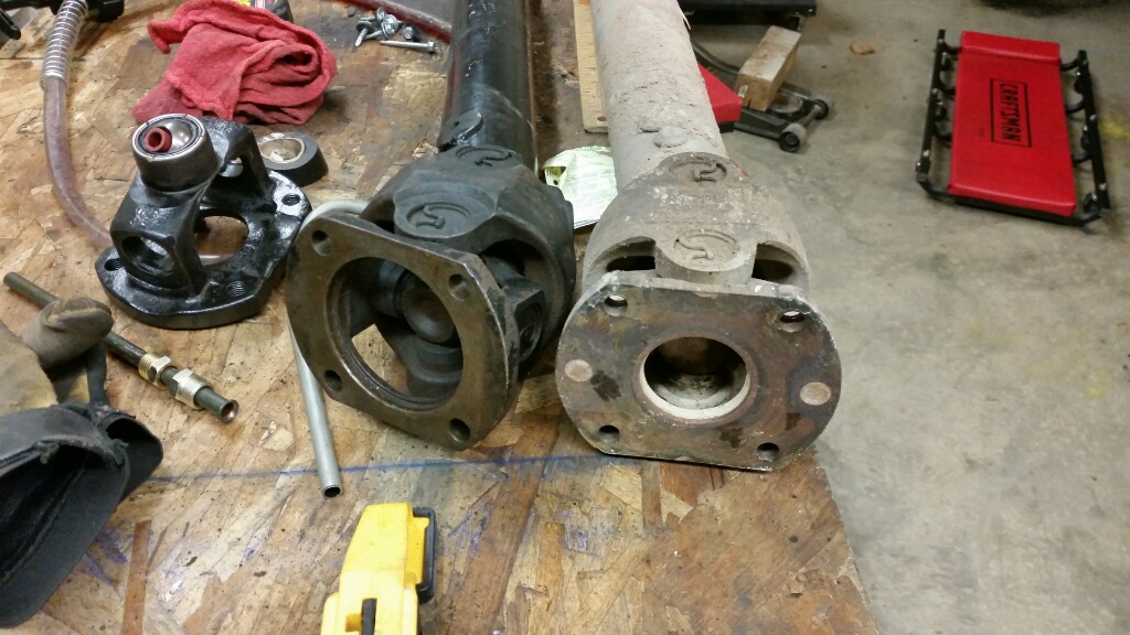

I'm having a new rear drive shaft made because I installed a SYE in my 241. I opted for the version with a mounting flange so I can use a cv joint shaft. While I had the front shaft out I was able to verify that the mounting flange for the rear matches the front, so I should be able to use the same type cv joint.
I was planning on just hitting a junkyard and grabbing another chevy front shaft and have it lengthened but the drive shaft shop tells me that the drive shaft I have is not stock. I've never changed it so I had no idea.
The shop told me that my cv joint is a 1350 with outside retaining clips and a 2" centering hole on the flange side. The flange is not threaded so the bolts screw into the transfer case flange.
Does this sound like what any of you have? If not, where did it come from?

for a 1350CV you may want to look at a Ferd super duty front shaft.
If you search super duty on CK5 you should find more info about it.

Turns out you were right on the money, it was a Ford Superduty front drive shaft. I didn't notice at first but it is different from the stock Chevy front shaft.
The Chevy shaft is on the left and the Ford Superduty shaft is on the right. The drive shafts and cv joints are identical and even the size and bolt location of the flange is the same. The only differences are the center hole size and the bolts themselves. On the Chevy the bolts go through the flange and thread into the transfer case flange. On the Ford, the bolts go through the transfer case flange and thread into the drive shaft flange.
Just one of those things where manufactures are different for no apparent reason. :rolleyes:

I couldn't tell you the angle off the top of my head but the Chevy shaft to the left is my front shaft and it's about 32" and has the same cv joint. I have a 6" lift and I've never had a problem with it.
Probably not actually. The shaft on the left is the one I have attached to the front of my 241. As you can see the center hole is just over 3" in diameter. Yours is probably the same so the Ford shaft won't work. The reason I needed the Ford shaft was to match the flange on the back of mine that came with my SYE kit.
