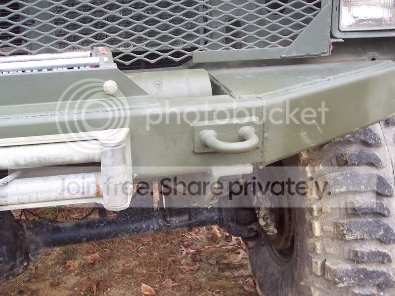

I use 1 inch steel drilled for shackles and welded to my tube bumper.
sanddawg, that warn box looks in a precarious place... or is it just me?
It looks that way but it is fine. I have aboot 6" clearance where it is. When I move my axle forward I might have issues the only reason it is there is I did not have the cable or time to rewire to get it up in the engine compartment.

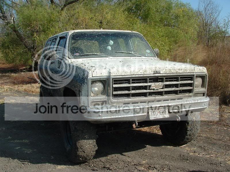

I have the stock tow hooks on my 87 and they work fine for me. I have used them hard on more than one occassion. This summer, I had to hook up just one side (drivers side) to a severely sunk expedition and yank really hard in 4lo about 12-15 times. I broke one tow strap in the process but the tow hook held up. If you look at it colsely its a little tweaked now, but not enought ot hurt it. I cant believe it held up to that abuse....and all of it before that incident. (also held up to dragging the rear end of a K5 around when he lost power steering and both driveshafts)

Those stock s-10 hooks arent the size of the stock k5 ones. I could see ripping one of the s-10 hooks off (even though i didnt see that happen at uwharrie). I yanked James (79stomper) sideways uphill on daniel severl times and had to yank the crap out of the expedition. I also yanked a cherokee so hard it ripped his bumper off.:haha: They still work. When I ever get tube bumbers though, im going with shackles.
EDIT: I just saw that he said he had s-10 tow hooks.:doah: Yeah...those arent what you need. I was talking about stock k5 ones. Anyways...dont put the s-10 ones on.:doah: :doah:
