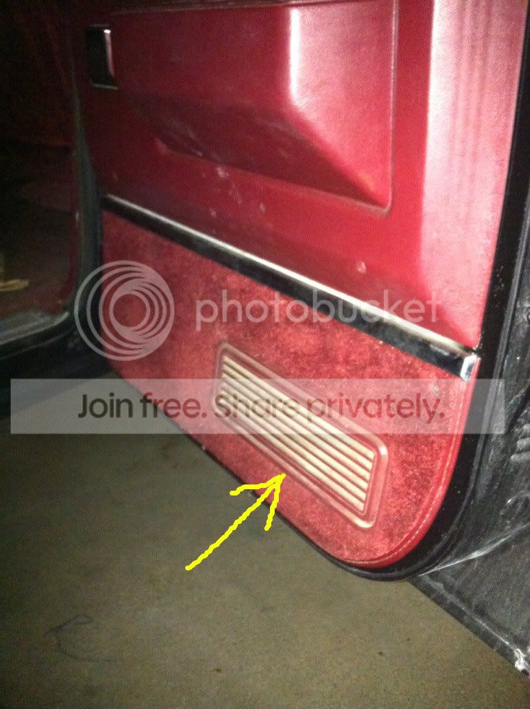

What's this vent and do I need it??

So the title asks. The vent in the lower door panels. Do I need it?
Thanks

If you are removing the lower door panels I might want them.
In some vehicles, its an equalization vent.
Lets the pressure equalize when you slam the door, and makes it a little easier to close.
Some early German cars, Volkswagen and Mercedes, you had to slam extra hard or open a window.
I still see it in some cars and trucks even today. Its easier to close a door if a window is open.

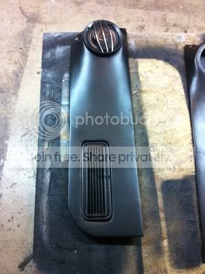

Awful lots of "Air space" in the Burbs :waytogo: I'm thinking I should be fine deleting the fronts if that's the case.
Guess I could go tape up a vent and see what happens. Thanks again

The vent Stays :D
Thanks for all the replies
No, not quite finished, the vent isn't centered, it isn't secured yet. yada yada :rolleyes:
(I still cant figure why my pics wont down size :doah: Sorry!)
You don't like it!? :shocked:
My truck is pretty much blacked out so I thought it would look bitchn with the Marooon interior :waytogo:
Looks good to me.
