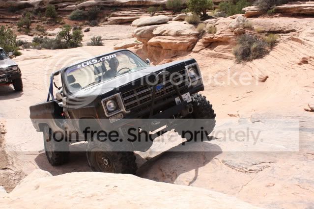

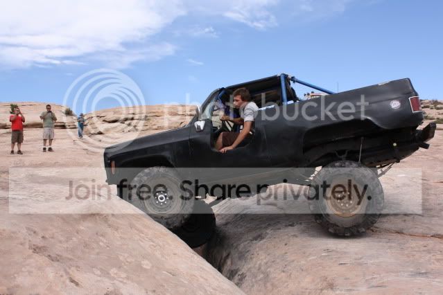

I run a DRW 60 and 1.5" spacers on the 14FF and 12 bolt h1's with 38.5" TSL's and love it. The double beadlock on the h1's is amazing and they look pretty sick too. For the back if you don't want to run spacers you can run a DRW 70 with SRW 14FF hubs or a van width 14FF. The DRW 70 and FF hubs gets it damn close to the front if I remember right, not sure on the van width though. Here is my setup, you can kinda see how far they stick out. If you search "h1" or "h1 beadlocks" or "DRW 60" there ae lots of threads on this with more pics and info
