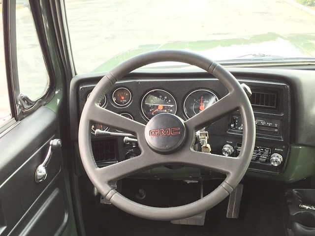

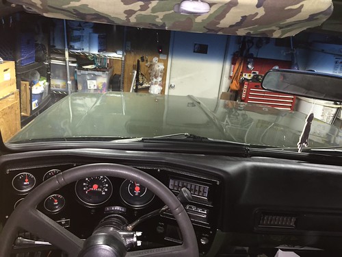

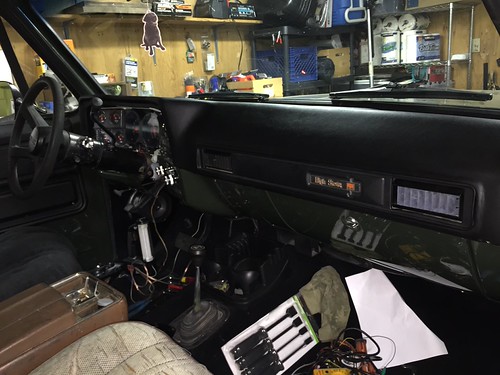

Sure. See the pics above and below. The fitment isn't bad at all. Just take your time installing it. You might need to shave off small pieces of urethane where the clips for the dash bezel go to get it to fit properly, but overall it fit my Jimmy great. I did peel the door seals next to the dash pad off the rail before installing the dash, once properly aligned and dash cap clips in place on the metal dash, I lightly tapped the seals back on. Its a very tight squeeze (at least in my truck) getting this dash in and out with the door seals pinched on.

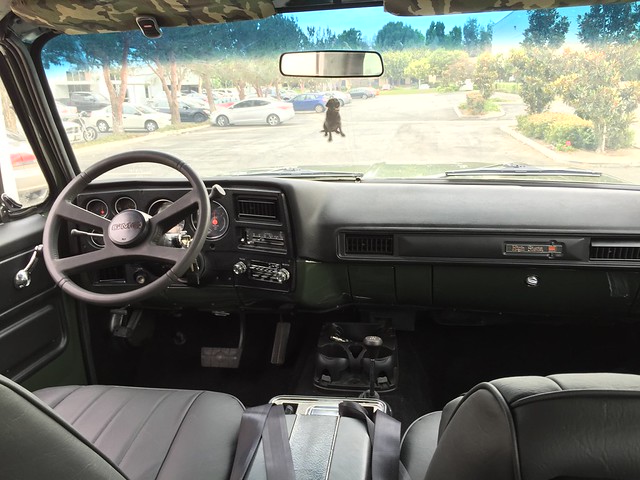

Is it just me or does the dog in this picture look to be as big as the white car?? That's a big damn dog!
Lol, @PWagon that's not really a dog but an air freshener hanging from the rearview. It looks like my black lab but thankfully doesn't smell like her.
